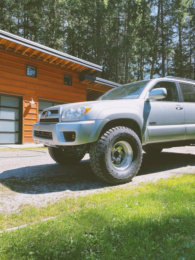

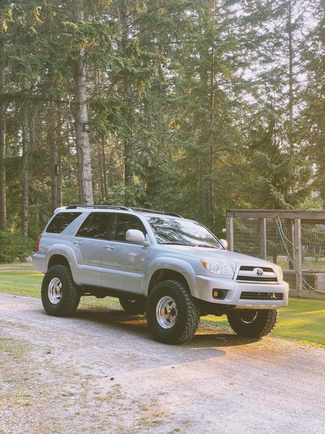

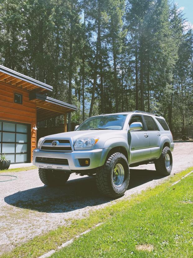

Here ya go! Got it all buttoned up the other day. Still need to do some trimming. But it works! Let's ride. Wheels are 16x8 -25mm and tires are 315/75/16 RTs.

I don't think it'll fit. Only SR5s can fit 16" wheels. I have jaos victron excel II pros 16x8 0 offset. 285/75/16
Sent from my SM-G955U using Tapatalk
are you running any wheel spacers? i have some 16x8 et0 AR wheels i may try to run. i am on a spacer lift kit. do you think id be able to run 285/75's?
Yeah I have spidertrax on all 4 wheels. You should be able to clear that with a spacer lift going straight but once you turn and articulate, probably end up rubbing something. Nothing a little plastic cutting and moving liner forward can't fix. You might end up rubbing on body mount though.
Nice setup! I’m running scs 16x8 -12 with the larger calipers. I had to run spacers and shave a little bit of my caliper down. I prefer more side wall look.
