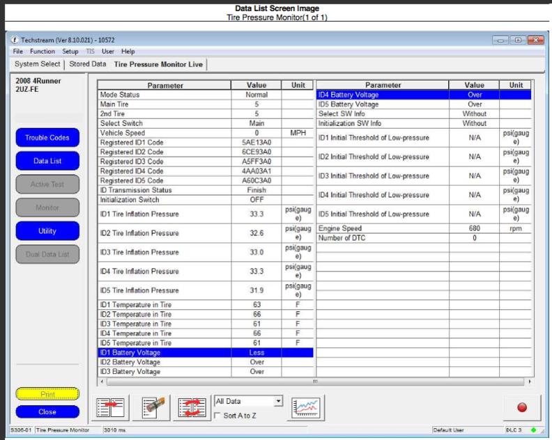

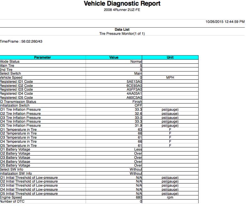

Here's an option for the TPMS Sensors...
If you choose to get a cable and the Toyota "TIS" software, once you have it set up, you can program in a 2nd set of tire sensors.

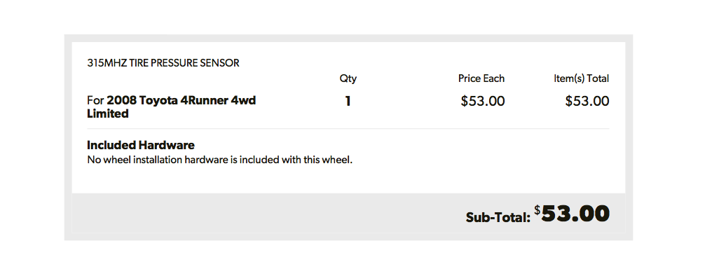

I bought the OEM tire sensors for $53 each from Tire Rack.
The "TIS" software allows you to program a "main" set of tires, an a 2nd set of tires. So whenever you switch between your winter and summer tires, once it is set up, all you would have to do is go into the TIS software, and change the setting from "main" to "2nd" for the tires you're using.
I suppose (in theory) dealerships and possibly independent shops COULD do this too, but they might charge you more that it's worth, and/or they may not be clear on what and how to do it.
I've included some screen shots from vehicle for reference. Although I only run a "main" set of tires, you can see where the software allows you to select a "2nd" set, and I'm fairly certain that you can then put in the ID numbers for each sensor on the 2nd set.
