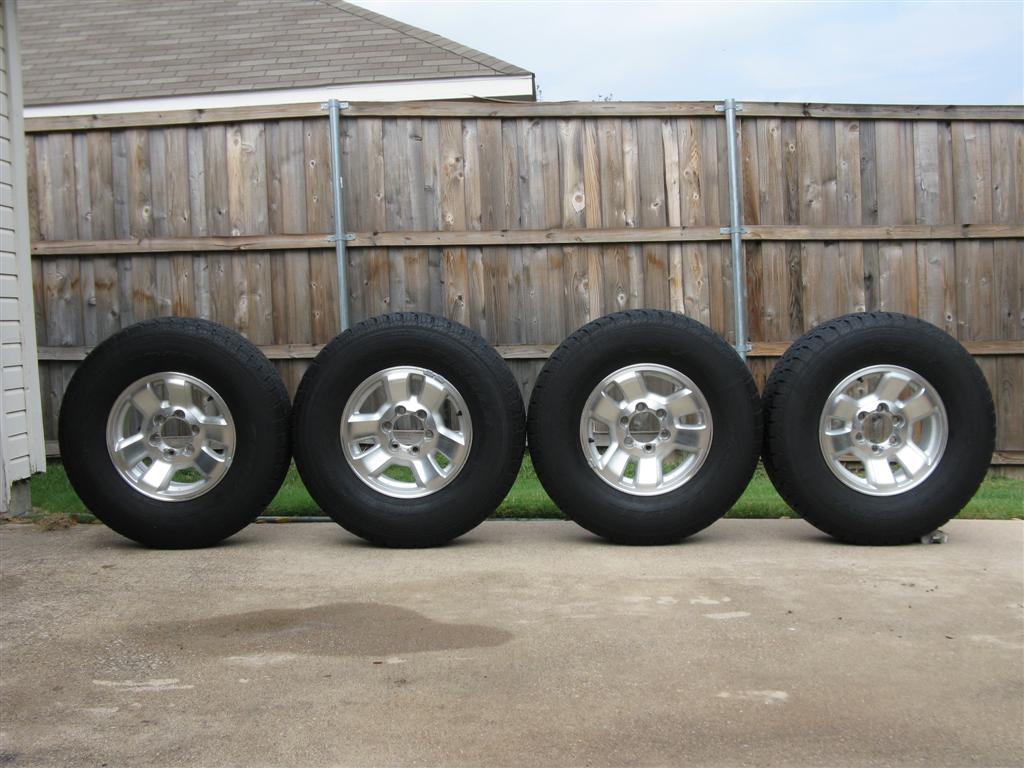

So where do you find the offset information? I am going from picture 1 to picture 2. Tire offsets is another thing that I have never really understood.

If those are 16" in pic 1, then they are +15mm. Not sure on the second picture.
If you look on the back side of the wheel you should find a stamp that says the diameter, followed by width, followed by offset.
