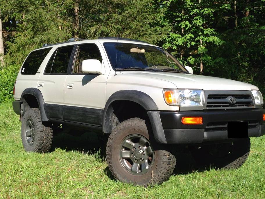

Been shopping for a while and finally found a runner that my wife and I dubbed worthy to be her DD and my weekend toy. Being in a more northern climate that can and will give us a lot of snow in the winter I decided it was time to get her a 4x4.
Drove over to Auburn, WA to check her out. Everything seemed in order, with some issues I will be addressing soon cash was handed over and we drove the 262 miles home (17.5 mpg not bad). Guy seemed very knowledgeable and based on questions presented, he was a preventative maintenance instead of reactionary guy.
1996 Limited 231K
Paint Code 1A5 so it is the Desert Dune Pearl which is pretty cool, looks white sometimes other its silver or anywhere in between.
Still on maintenance is tranny flush. Trans re route trans->cooler->rad->trans for what I think is optimum cooling as well as warming to operating temps.
Thanks everyone for having a great community here, I am excited to be joining. If anyone knows some good trails here in the Spokane area let me know!

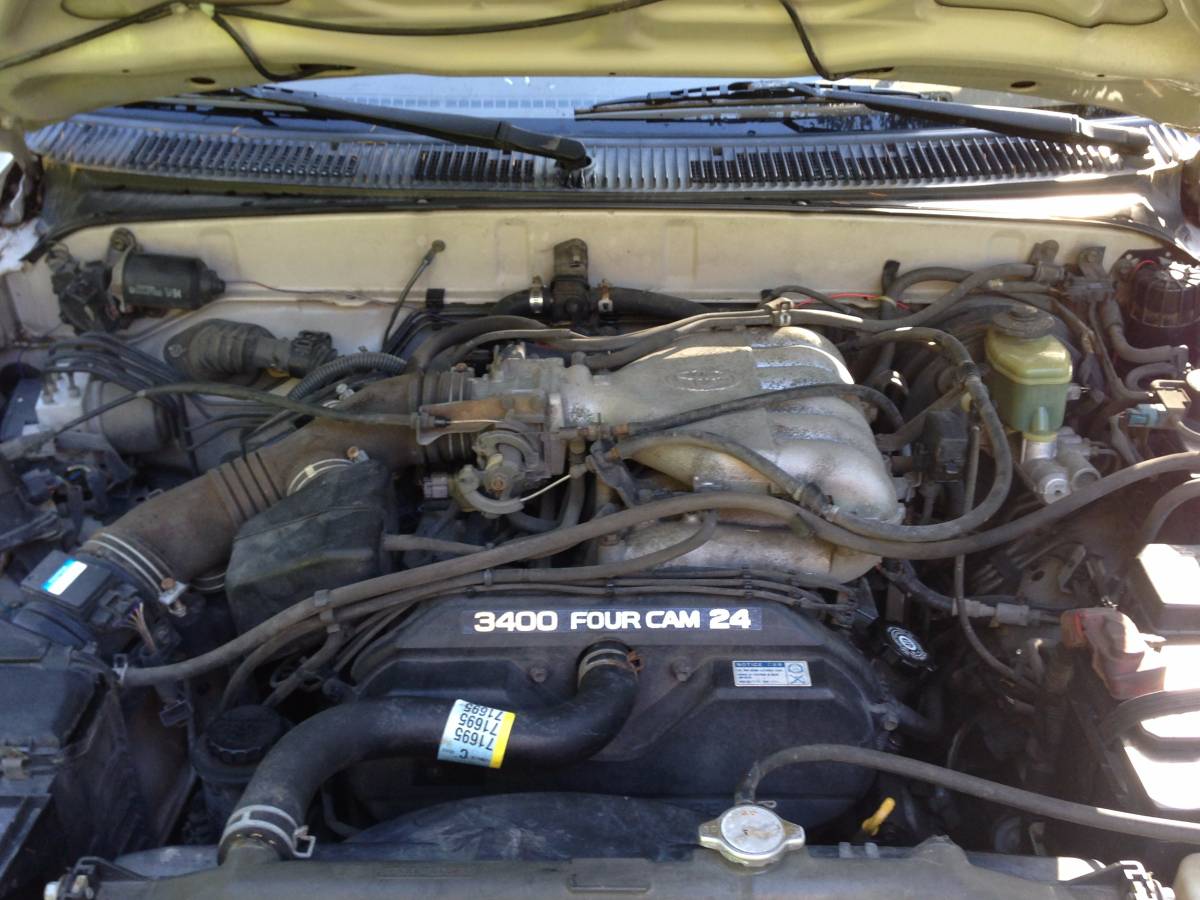

MAF/Throttle Body Cleaning

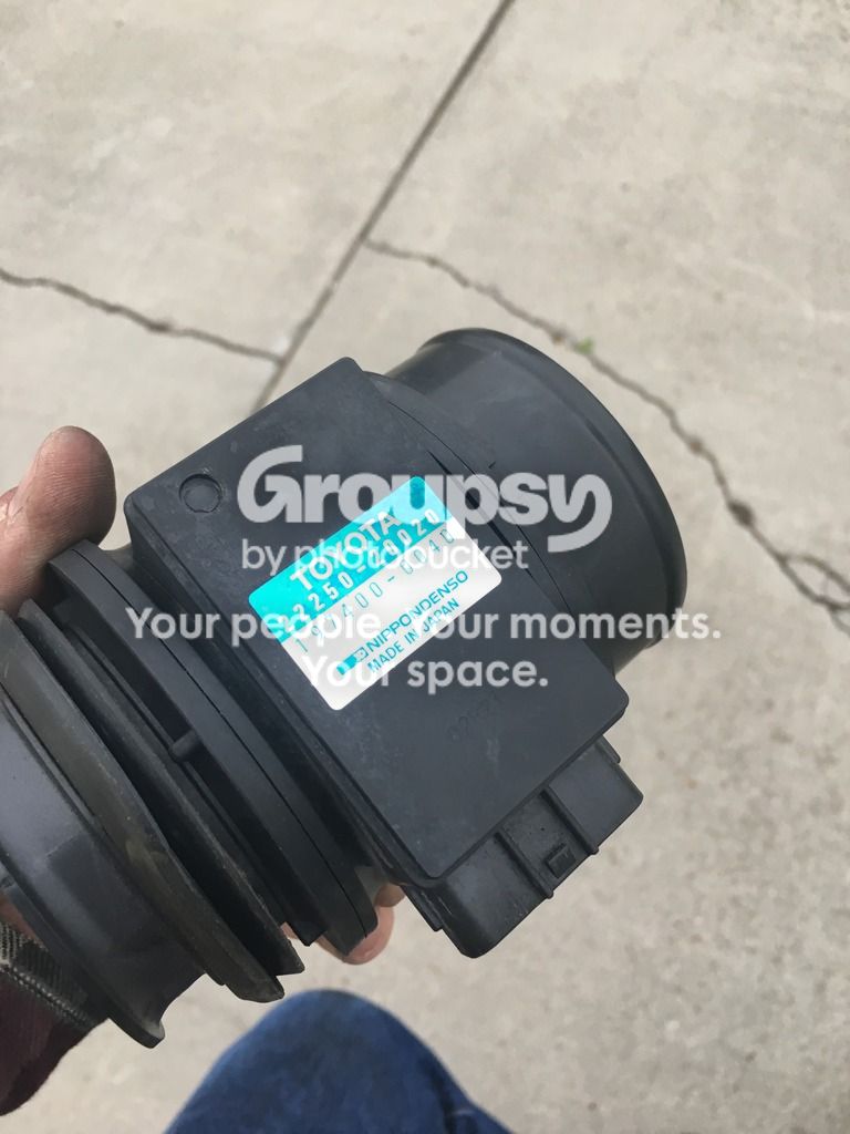

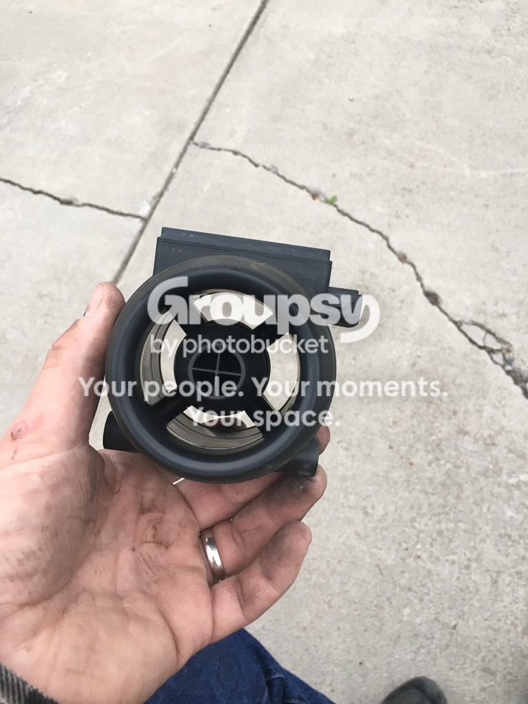

Figured the easiest and most convenient item to tackle first is cleaning the MAF and cleaning the throttle body. I didn't have a toothbrush for the TB so I will probably have to clean it again when I do the plugs and wires. No big deal it is way cleaner than before. I also found out I have the "weird" MAF. I have no idea if I cleaned it well enough, but I did it according to the link [MENTION=57546]4-Ripcord[/MENTION] posted on his Buyer's Guide (invaluable). 4Runners.org - Cleaning Your Throttle Body and MAF
I also forgot to take pictures of the TB. There was a lot of carbon behind the butterfly valve.

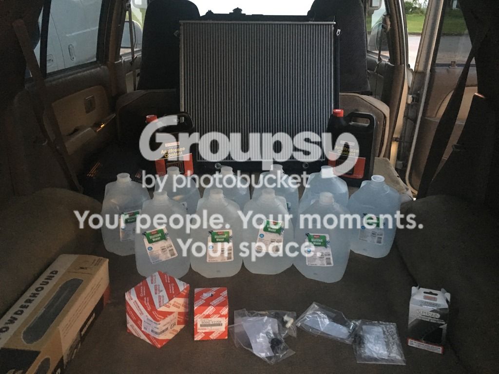

Stupid rusty radiator cap. Apparently I missed it upon initial inspection. Well 230K down the road isn't bad for what I assume is the original radiator. I wanted to replace it anyway, just not this way. I am also going to reattach the tranny line after the cooler so that the rad can warm it to optimum temps. So I went to Toyota and picked up a few things, just need to go to Costco and pick up some Mobil1 :bravo:

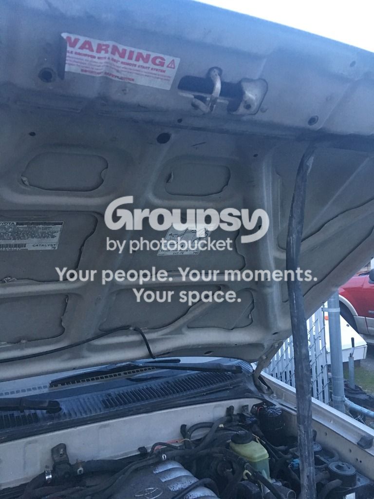

And on another note, does anyone know if Toyota sells the pins that hold this rubber strip to the hood? Do I need it? Can i just remove it and be fine?
Thanks for your thoughts.
Got the runner up and going again yesterday. Did an oil change for good measure.
Coming this week PCV and Rear Breather. Followed by oil changes for the tranny and diffs

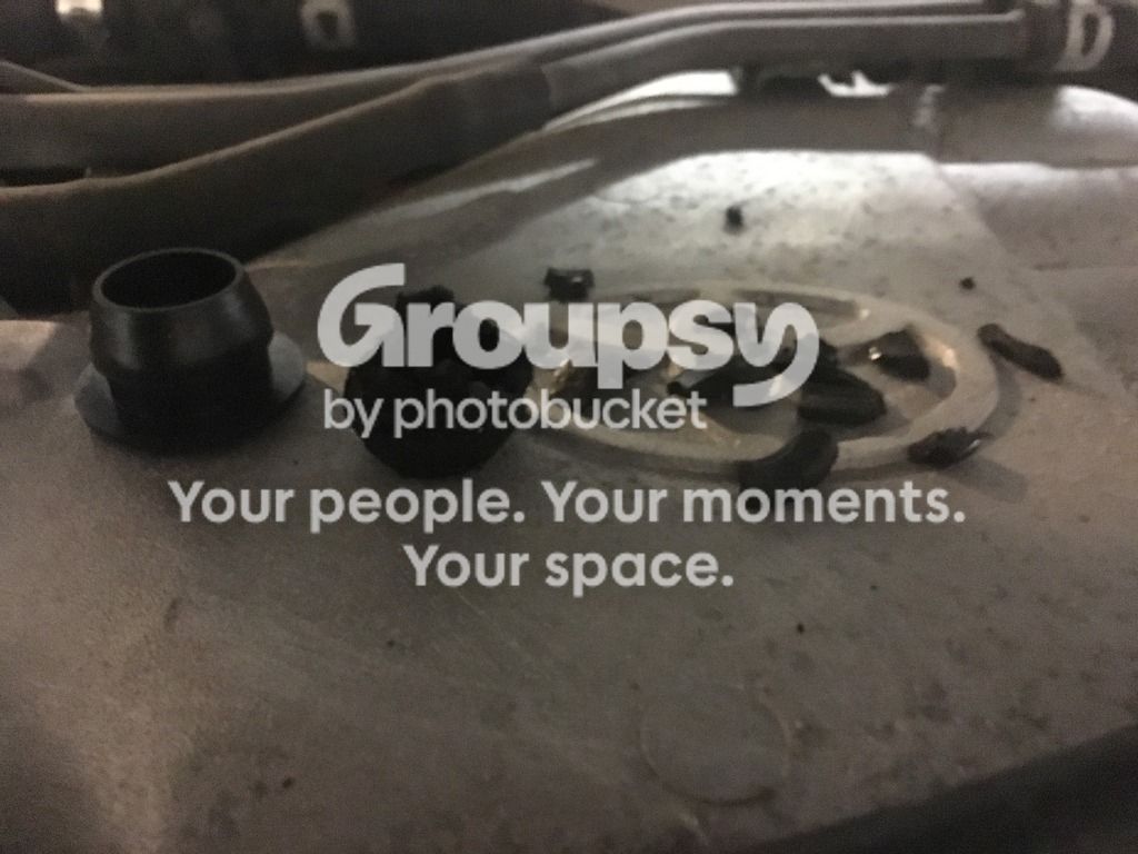

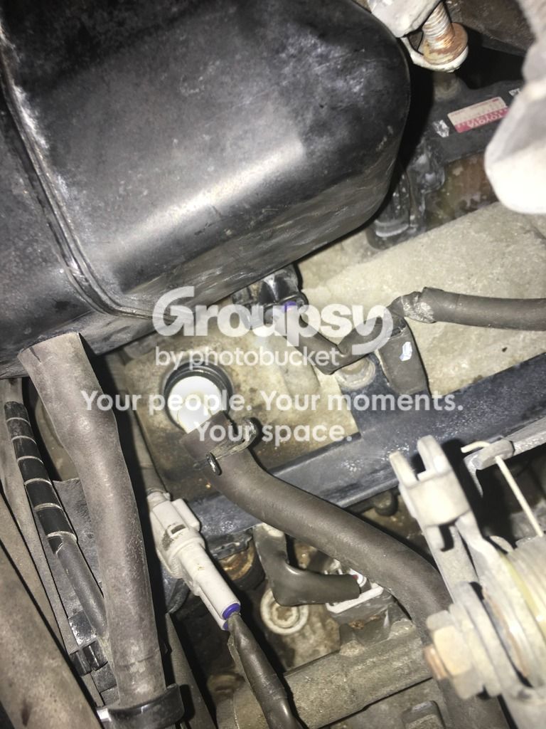

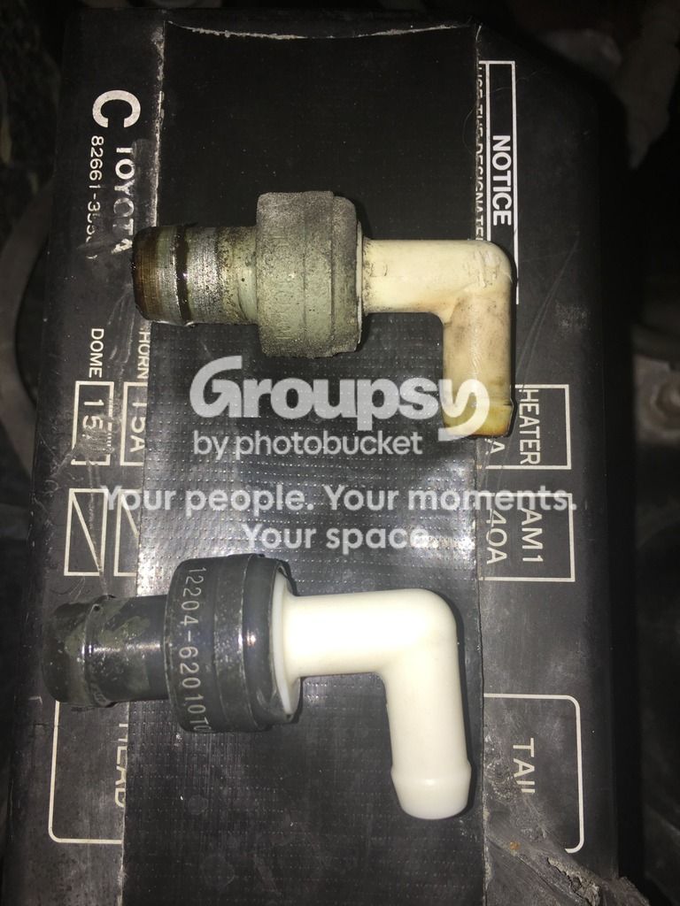

In an effort to learn everything about my Runner I am fixing or replacing anything I can think of. PCV is an easy way to go. So here we start.
Of course the grommet was very old and pretty much exploded while trying to get it out. Don't worry I got it all out.
But she is all patched up and you can see the old vs the new

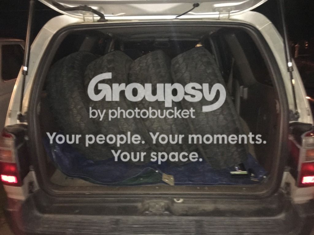

Since this will be my wife's DD i wanted to be sure that there was the best tires for the snow that I could find. I typically buy Michelin's because they are great and last forever, but stepping into the world of larger tires and being in a lot more snow than usual now that I have moved yet further North. I asked the person I trusted to have done this for a while, seanpistol over on expedition portal (http://www.expeditionportal.com/forum/threads/100994-seanpistol-s-01-Tundra). We discussed 255 vs 285 and it came down to what is available tire wise. He very highly recommended Goodyear Duratrak for their snow traction and drivability saying, "If there was something better I would have it."
That was enough for me to decide it was good enough for my wife in the winter. So here are a few shots! Also to be sure to clear the UCA I added 1.5" TrailGear spacers up front, which pushed the wheels out to better fill the well anyway, which I love the look of.

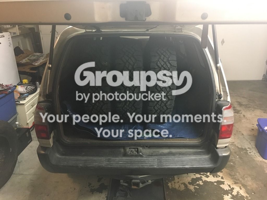

In the back of the rig, could only get 3 wide

Old tires fit much better in the back than the new ones

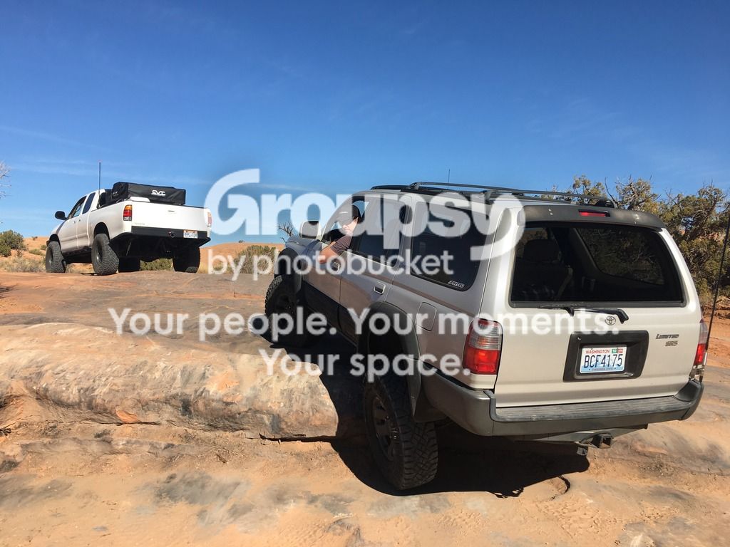

Here is the low point of the trip. The runner performed flawlessly. I really couldn't ask for more. The locker was barely used and she just walked all over every obstacle that came our way. I got a little cocky and here is where it bit me in the ass. We got down in Mickey's Hot Tub and just couldn't make it up the steep exit. Fortunately my brother talked me out of it and I was able to back out. Very minimal damage to the runner, the bumper took a hit on each corner and I drug the already bent hitch on the ground. I didn't realize how steep of an angle I was at until I saw the scar on the rock and how high my hitch is from the ground.

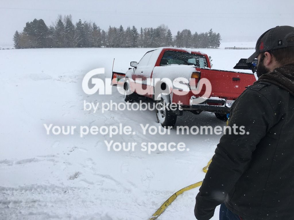

Brother in law got father in laws truck stuck today. Called the right rig to pull him out. 4lo and locked, came right out on the second pull. Plow was high centered on the asphalt. Fun day in the snow!
