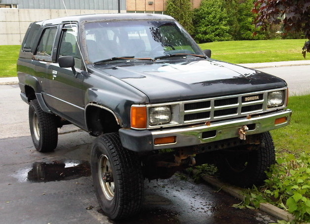

So my 4th Gen 4Runner gets to meet its 1984 1st Gen ancestor and share some driveway space today.
I picked up an 1984 5-speed with a 3VZ already swaped in it, yes I know it's the 3.slow but the frame is in fantastic shape, the body not so much and it does have a list of mods already installed.
4" lift ( leaf spring brand unknown )
rough country shocks
Mostly stuff from trail gear:
New kuckles
new trunion bearings
high steer
1995 v6 4runner calipers
Landcruiser fj60 disks
stainless brake line
4runner 1995 v6 master cylinder
front/rear breather kit
And a list of repairs to be done.
Starting with the radiator which has lost many of its fins
The hand brake cable is snapped
And the CEL comes on after about 10mins of driving. Previous owner already tried a bunch but no luck. My 4th gen had a similar issue and it was because I had a leak in one of my exhaust seals and the sensor was getting failed comparison readings of the exhaust before and after the Cat. Once the seal was replaced, CEL went away. This leads me to another repair on the list, exhaust needs replacing. It rusted, and I'd prefer not to lose it from under the truck.
The rear window tailgate window does not roll up and down without someone helping it up and down.
And then the obvious rusty body work.
The inside is pretty nice, I even found a receipt for a interior carpet shampoo in the glove box.
Its a bit of a project, but a solid axle swap is not legal here, and recently the police is hating on lifted trucks giving tickets for silly things like uncovered fog lights, and mud flaps that are not the proper height off the ground.
So...Radiators...any ideas. Stick to Toyota OEM or similar, or aftermarket performance type. The truck is going to see trail duty that's for sure. So I want to make sure it stays cool driving slow in the hot sun. Right now the radiator is junk.

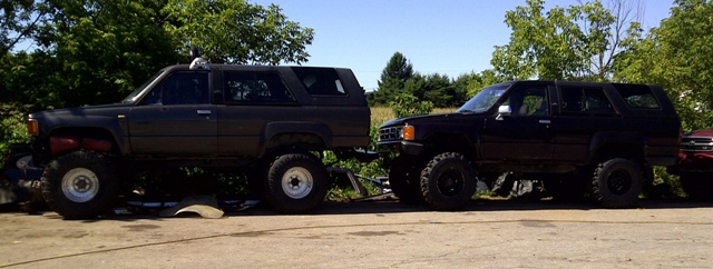

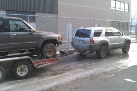

Here are my runners, getting aquainted. Sharing old stories of how the Toyota factory used to be and what the new factory is like. My 4th Gen brought my 1st Gen some flowers too. :hello::thumb3:

Double Runner. My V8 4th Gen had no issues towing the trailer and 1st Gen 4Runner combo. I had never towed anything in my life before. The brakes on the trailer did their thing, and the over size brakes on the 4runner sport didn't hurt either. Big honkin pullin V8 wasn't to shabby either. OME in the rear really helped it not sagging that much. Couldn't imagine the sag on stock coils. Had to inflate the tires close to max PSI rating. Trailer has warning for 55miles Max, I kept it below that and felt really comfortable. If I didn't pay attention and made it to 55miles/hr and more I felt it was wobbly a bit. So kept it lower. No need to rush. Best to arrive alive.
I didn't feel that other cars or trucks were blowing me around. I drove through a long tunnel that was the only spot that I felt air pushing me around a little. But not that much, and slowing down cured that. Over all, a good experience for my first trailer towing experience. But I had an experienced buddy next to me.... goood thing, because backing up a trailer is really all messed up!

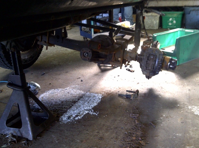

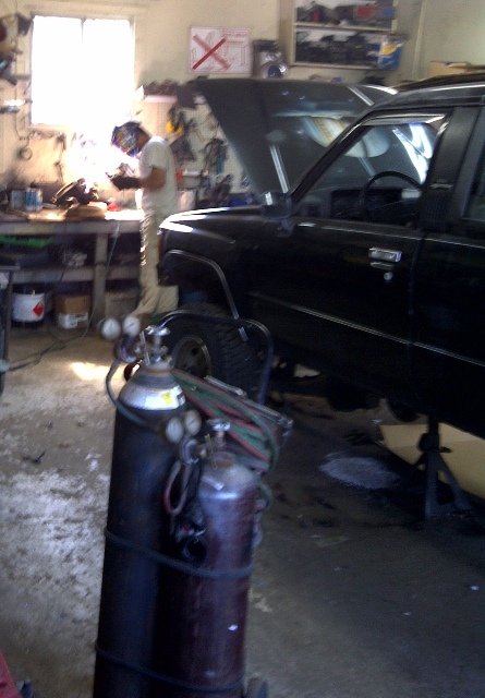

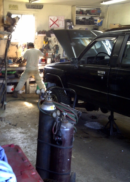

The build just got a kick start. Steer stabilizer, axle gausset, and diff armor arrived today. A second set of 4.88 gears were located on a donor truck and should be here tomorrow. Rear 4.88 are welded locked. This new found 4.88 will get the ARB air locker treatment. Hopefully this week, or next.
Still loooking for a good donor body to do a body swap rather than repair the body panels, and windshield and tailgate.

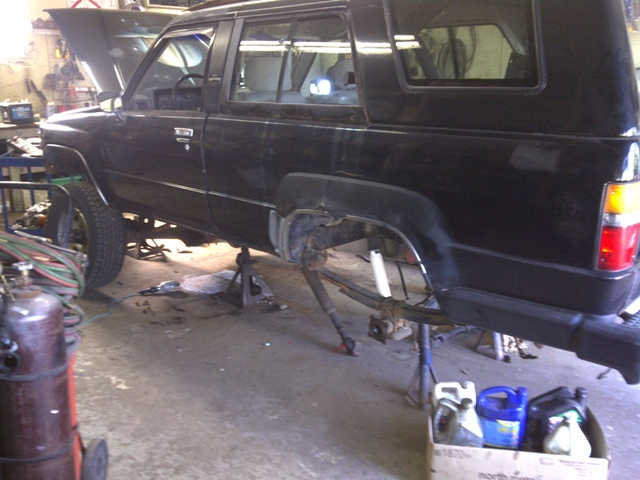

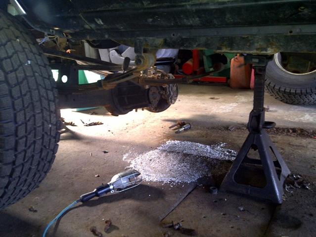

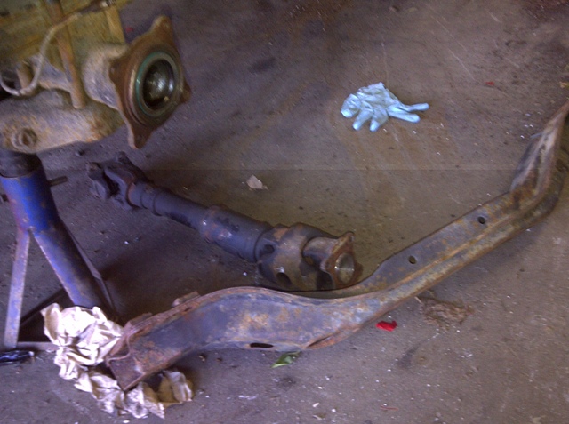

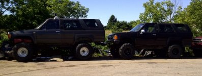

Some pictures of what this looks like all apart, welding the diff, and some friends of my 4runner waiting outside to go play with my 4runner.

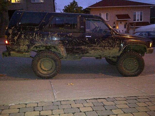

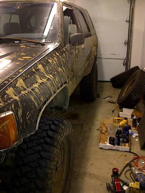

I got out and tested it last weekend. This is what happened! As you can see from the pic, it was properly tested, and it works real good.:bravo: I don't have many pics or video because I was too busy being giddy inside the truck rolling up and over everything. :boxer: I cleaned the windows so I could see out them to drive home.
This truck is fantastic. I was blown away by it, and for sure the ARB locker in the front. The rear is welded, so that is always locked. But the ability to turn the front locker on and off is amazing. With it on it was very hard to turn. No problem, push the button, make the turn, push the button again to engage right before when and if needed again. And it just went. Usually with my 4th gen I don't aim for all the obstacles, I try to avoid them when I can. With this one, I tried them all. Even on 33"s it went every where my FJ Cruiser buddies on 35" got stuck. The 4runner didn't get stuck and went where they couldn't go at all. I'm not sure I need 35" unless I do real deep mud I think? But I don't like mud, I like to go 4lo slow. And she's real slow in Lo range, 1st gear and 4.88's. Well actually she is also slow in 2hi and 5th gear, but that is another story.:lol: Needless to say Down hill was slow and controled and no need for the brake.
Locked up on all 4's is really something extraordinary. Hard to explain, you need to experience it. I didn't understand, until I tried it. It must surely be the most worthwhile mod.

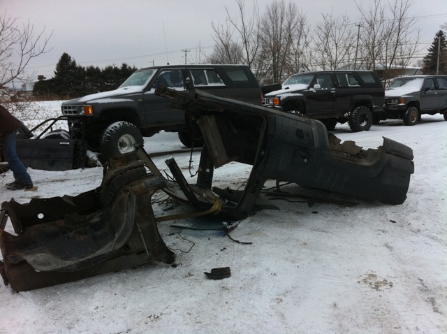

Body off 4Runner!
Out with the old junky body.....see you later cracked windshield, good bye rotten tailgate, good ridance doors about to fall off.
