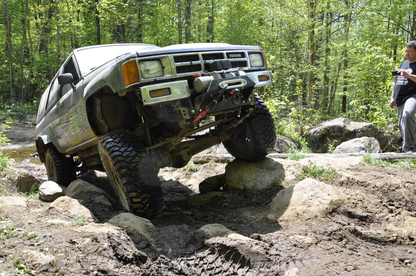

I put in a winch. I just used the trail gear winch mount. My winch is a 12000lbs Titan Winch with synthetic rope. It's been tested a few times, mostly to pull FJ Cruisers...:trophy: HAHA....
So the way the bumper was bolted back on after the body lift, it was in the way. So I cut the bumper, and just made some little brakets to hold the two halves in place to keep that stock bumper look.
I'm thinking in the future to weld in the some steel tube, or channel, and then bolt those halves to still have that stock front end look, but have solid steal behind it.

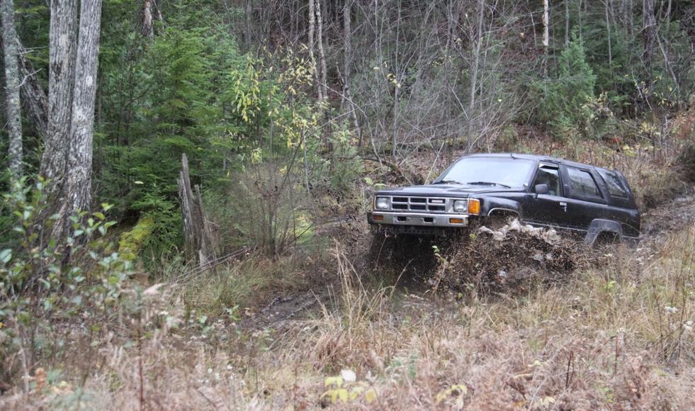

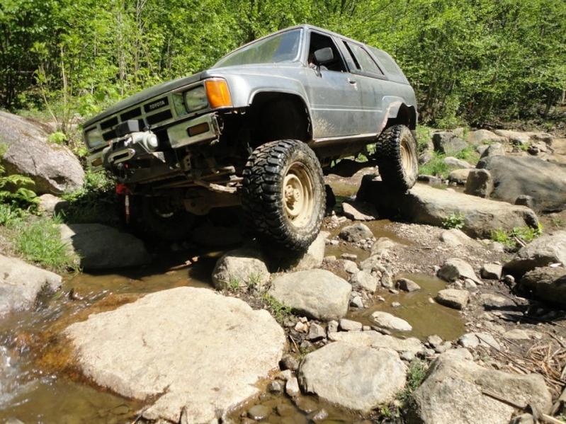

Winch and playing on rocks pictures here.

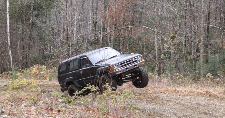

Having fun. I didn't even realize I was getting airborne until I saw the pictures.
