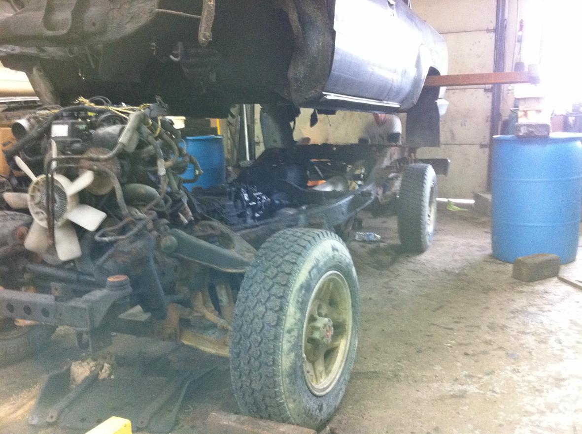

Body off 4Runner

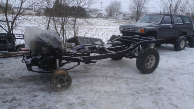

Hello old frame, meet some new paint. U lohke mmmmArVALus! Wait until you meet new energy suspension body mount bushings, and a 2 inch body lift.
Looks good!
Why the body lift? Looks like its already sitting pretty tall. Drive train lift?
Yeah i know but somehow I got convinced to put in a body lift too. After this the next major work is duals or at least a single with 4.7's. So as I work through that, and figure out what is involved, and gather parts, I would plan it with a drive train lift too. EDIT*** the body donor had a gear drive T-case. One of 2 sourced.
I'm a little afraid too that it will be too tall. But I might need to experience it a learn for myself. If it is too tall I can always remove it.

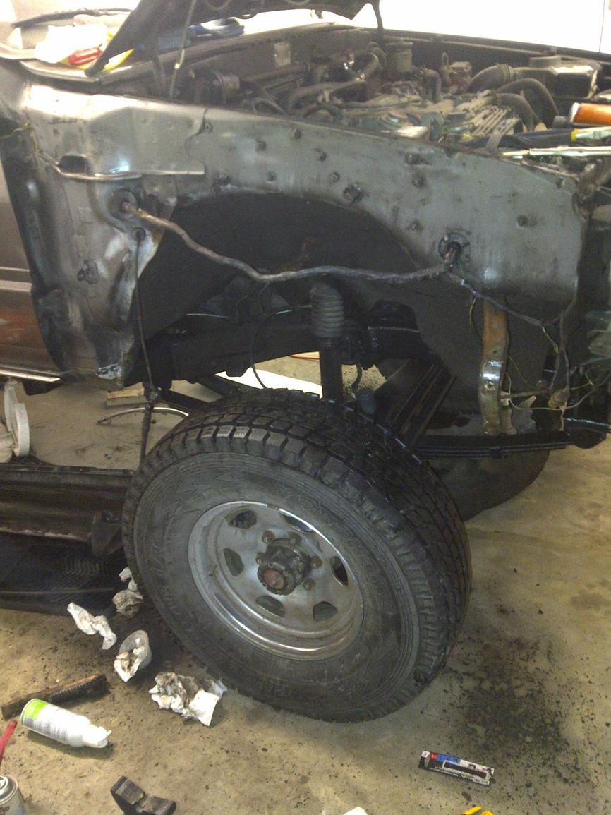

Right now, my front passenger tire gets all cut up by the wheel well pinch welds when it flexes. I'll try this, and then maybe some cutting of the fender well, and hammering back the pinch welds. It's a learning experience I suppose.

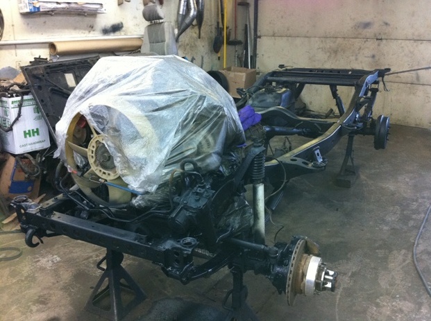

-Frame painted, and rust proofed.

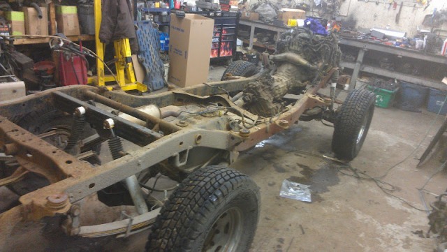

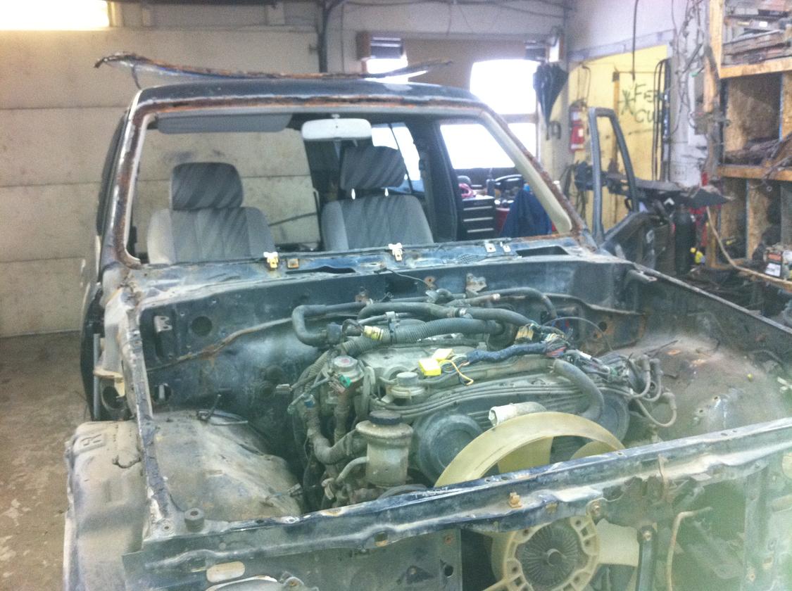

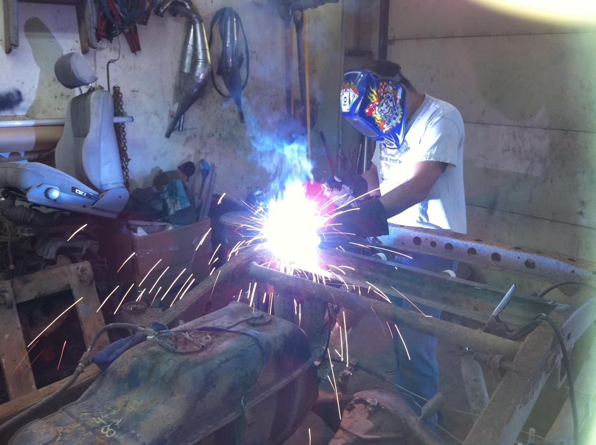

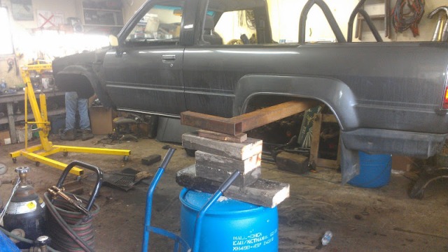

Some more pictures of this build. Here the body was off. This was the BAD body. I'm not sure how the windshield never flew off and the doors remained on the hinges.
The frame got some good hammering all over it, trying to find any weak spots and to make the dirt and loose rust fall off. The cross memeber that was welded in to attach my rear shocks also got a rework. Since the body was off, it was easier to weld all around it. For a while I was contemplating just leaving the good body on the 1986 and doing a solid axle swap. But while the body was great, the frame was rotten. It didn't even need hammering. You could push your finger through it some places. The 1984, had rotten body, but pretty decent frame for a Canadian 1984 truck. That is many years road salt. Only one section needed to have a piece cut out and new steel welded in.
1986 4cyl Engine and transmission sold. Top shift transfercase and the entire rear axle kept. Frame sent to scrap metal. A bunch of other spares made like door windows, front grill, mirrors, door and window mechanisim, light covers etc..

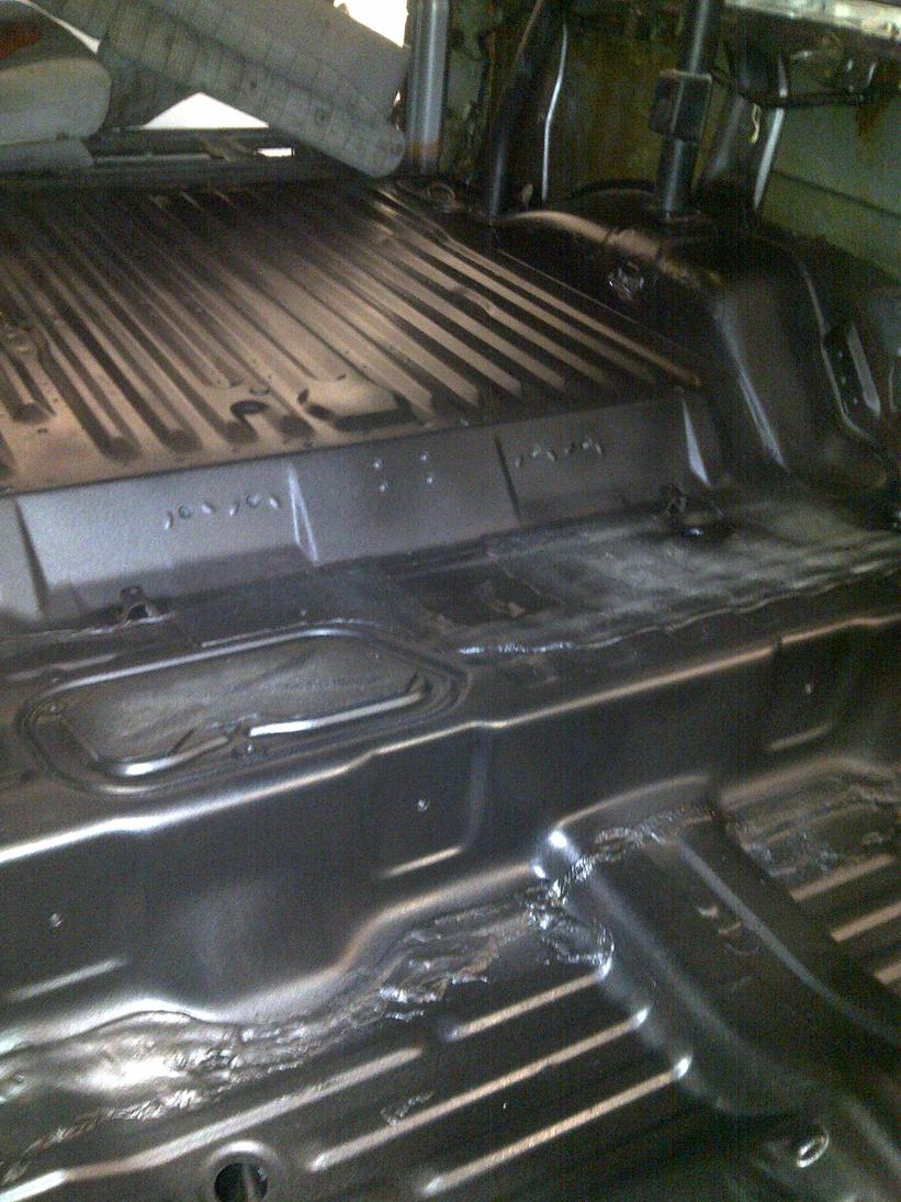

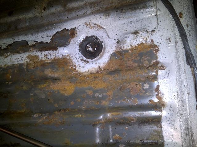

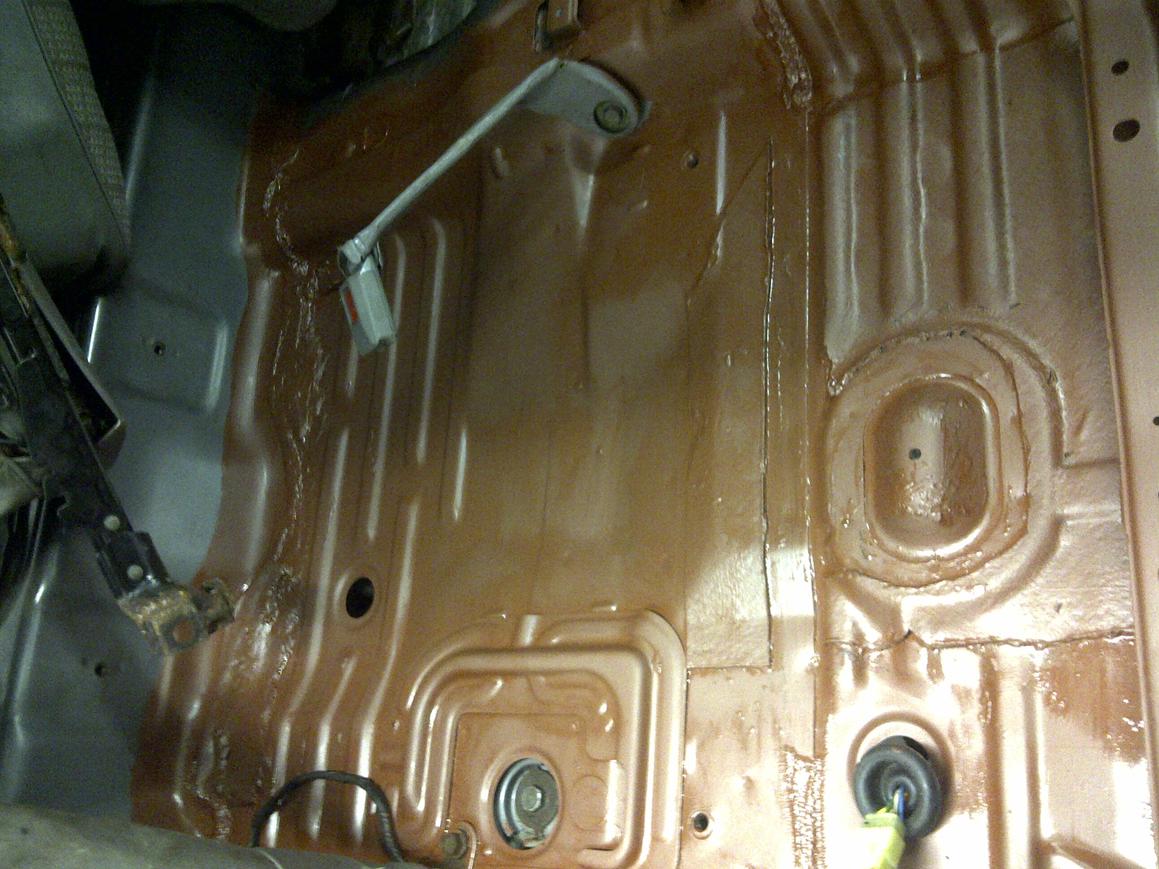

As best I could I removed the tar sound proofing material on the floor of the tub. I left some on the floor bacause it is just so difficult or awkward to remove. But this is more up at the top where the sourounding metal look prestine. I removed the edges, if I saw rust I kept removing, if it was prestine I let it on. Under the feet area and under the seats, I removed all of it.
The kind of rust I saw looked like this. I used a dremel with a the grinding/sanding/cutting wheels. It worked good to remove the rust. It revealed shinny metal below it and not a rust hole all the way through. The underside of this tub had been coated with rust proofing, looks like a vaseline. I hope it did it's job. Banging on it produced a nice solid sound, not a dead sound. The dremel worked well because with the angled head attachment it was light weight to hold and easy to manouver. I think my full size grinder would have worked quicker but too powerfull and heavy for delicate grinding in the tub floor.
I primered the floor. Basic tremclad red oxide primer. Then I plan to paint it a tremclad black. Then some type of bedliner coating I guess. Make it hard, and hopefully non slip and washable.

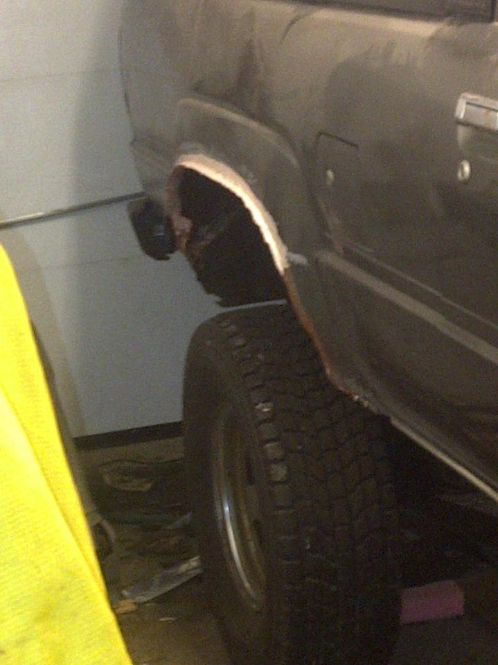

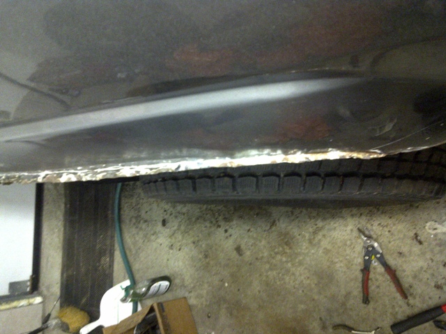

I also started working on the fenders. Not sure why. But everyone says to remove the chorom trim. I also had some rust on the bottom corner of both rear fenders. So I started cuting out the rust, and I was going to patch/bondo it back. Pretty simple. And hit the trails.
But no...
It got way too fun cutting stuff out that I started peeling back the pinch weld/fold of the wheel well opening. It was rusty. But again, not horrible, and I could have left it alone and done this work later when/if the rust spread. Or when I actually had the time to do it. But I couldn't.
Then I got the idea that I was going to cut them out anyways. But that was dumb. Because I only have 33" and probably will only go to 35" or I would have to change to something else other than my 4.88 gears. I still ended up cutting out the rusty metal of that folded in lip. All this work ended up making a big separation between the outer fender metal and the inner fender metal.
So I got another idea. I'm not sure I've seen this before. Maybe it is dumbass, and maybe I should just go all the way. But I got this idea to fold that outer fender outward instead of back inside or weld matel back to reform that outer fender lip fold.
So folded outwards it will actually act as fender flares. I went bent up about an inch. There isn't an inch of "fender flare" since I cut out the rusty metal but I bent up about an inch. So then the inner fender I also bent and hammered it outward to meet the outer fender metal. now I can just weld it together or rivet it together and also extend them a little to make them uniform all the way around. Then bondo and shape them.
I need fender flares to cover my tires. The cops around here are on the hunt with tape measures for non conforming 4x4 mods and accessories.
This is what it looks now. Good idea? Or bad? Only started on so far. I think it will end up nice.

There's a dude on yotatech (Dirtco) who cut his fenders from a 1st gen runner. When he put them back together he got some 1/4" rod and welded the lip of the fender to that. It made a cleaner weld and it added some strength to a weak part of the body. Just another idea.
You do good work. Keep it up!

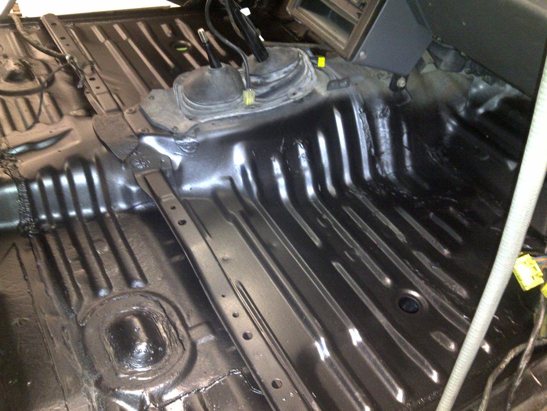

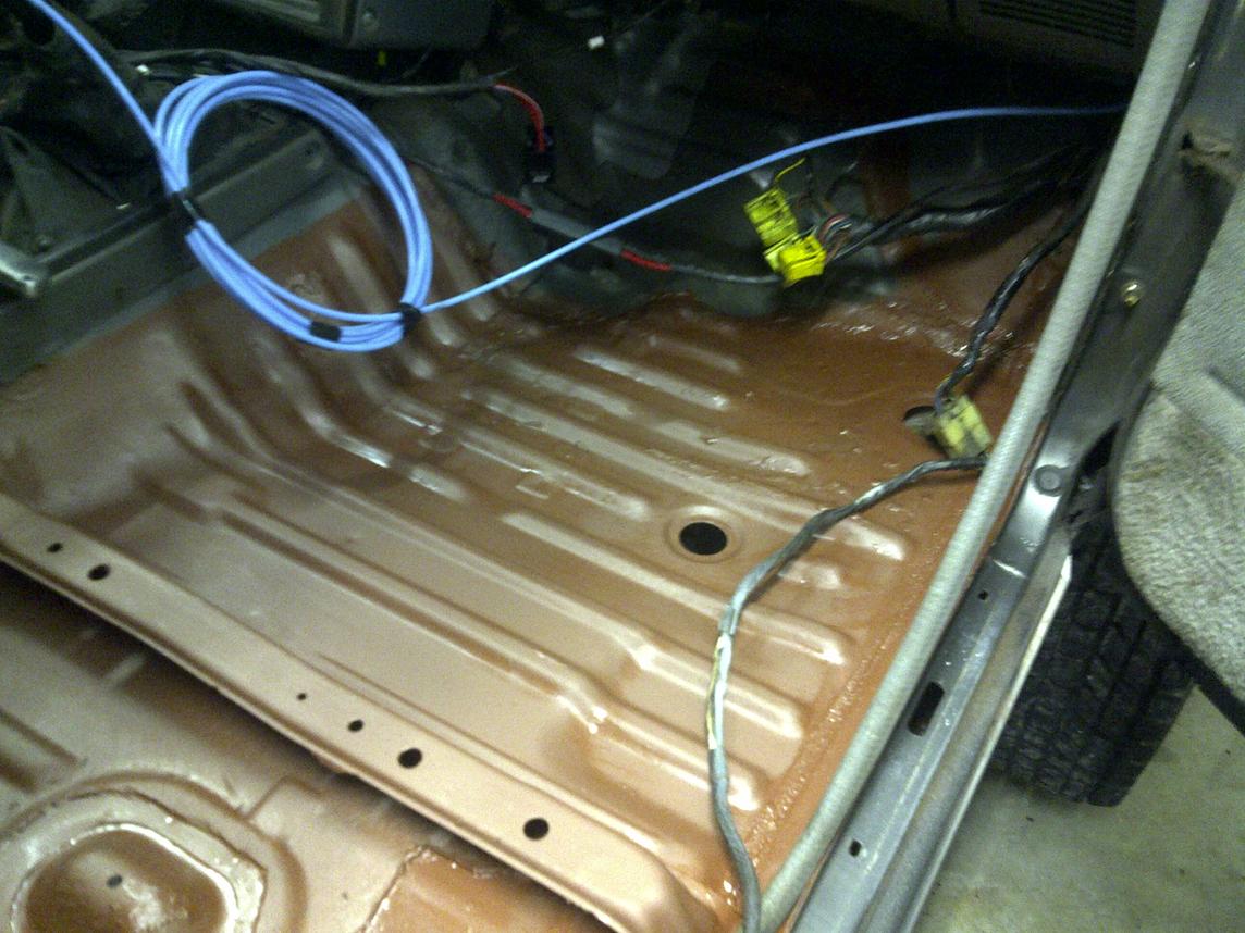

Floors painted black with bedliner. I'm not sure i would do that again. Instructions say to prime first. I did. Make sure it is dry. Was dry for weeks. Clean. I cleaned. But on some spots, the liner acted like paint remover and bubbled and peeled off the primer. Just a few quater size spots. Who knows. Now that it is real dry, it is alright. I'm not impressed with it. Maybe I didn't apply it thick enough.
Looks nice though.

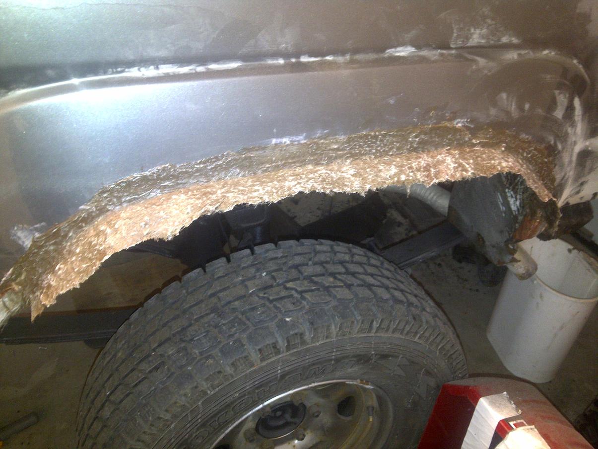

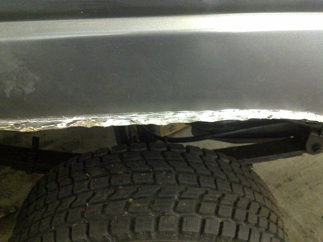

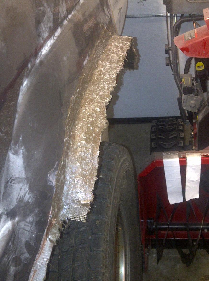

The latest on the homemade fender flares.
With the inner and outer fenders, cut and bent outwards, it created a little ledge. I sanded off the paint, and applied bondo hair fibre glass. First I layed down a mesh, to extend the flare, provide a platform and serve as a guide. Then I applied the fibre glass bondo hair. That suff it real sticky. And pretty strong.
People have said fibre glass will break and chip. I have said it is a trail truck. I'll just put more fibre glass to repair. But it seems to keep some of it's flexability. First time using this stuff. The flares are not really uniform. But again...I say it is a trail truck. It needs to look that way.:D I will apply more layers, sand it and trim the edge straight and it will become uniform.
This, unlike the truck liner, I would recomend. This was a good idea i think.

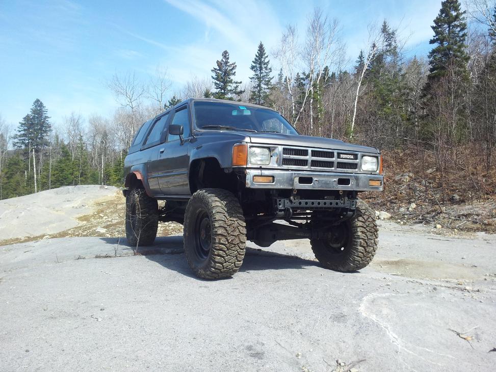

So I haven't updated this in a while. The rear home made fender flares came out like junk. But I'm not looking to win beauty contests.
Actually, I think the idea was not bad. Instead of just cutting the fender, I folded it out, covered it with fibre glass and made them wider. Very bumpy fibre glass. Oh well, I can add more glass or putty to make them smooth. But for now, I took that rubber stuff you put on the base of walls, and bolted it down with stainless bolts. Not pretty, but makes me street legal.
