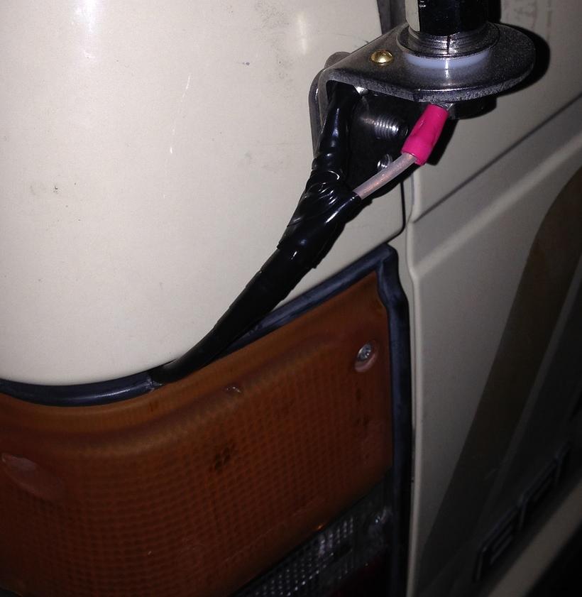

Basically as pictured I set the mount between the rear door on drivers side ( 4screws). I wired the terminal ends to the cable and attached the ground ( See pic) and notched out the upper rear tail light to run the coax through. Inside the rear light space I made a small slit in the rubber seal that is used for the rear tail light wires then sealed it back up with liquid rubber.

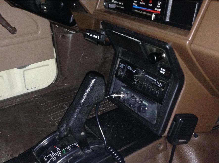

My truck had a quartz clock there under the stock radio. I removed that and used the power and ground wire that went to the clock and wired to CB. I had to shave a bit off the clock mount but got it centered and fit to perfection. ( See pics) I used an existing screw mount to put one screw in to hold the transmission microphone down tightly drilling no holes into panel there.

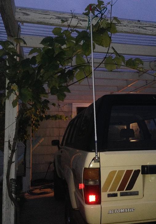

When I set up a SWR meter initially at the height in the picture with spring attached ( adding height) my channel 1 read 1.4 and my channel 40 measured .08. I removed the rubber tip off the end of the cable and turned the adjustable screw 1 turn at a time and tested. At about 2 and 3/4 turns my measurements were a perfect 1:1 both on channel 1 and channel 40. I replaced rubber tip.

If you do a CB take note on height of my antenna mount on back tail gate measuring up 4 feet plus spring. At that total height you could place the antenna anywhere on truck and get similar results. 1:1 is as good as it gets and utilizing the full 4 watts :shrug:
