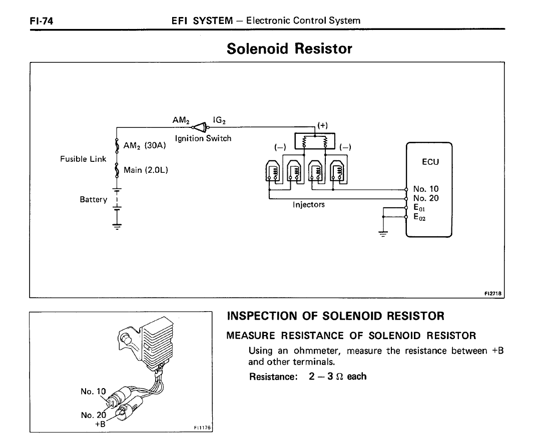

I have an 87 4 runner 4wd, auto, 22rte and I am looking for information on how to properly test the fuel injector resistor solenoid , voltage and ohms test?

well you can disconnect the connector and probe the pins with the key on engine off you should have battery voltage at the connector. also you can check resistance of the injector itself, im not sure of the spec but it should have some resistance, as long as its not showing open i'd say you're ok.
I need a little more detail than that lol. Its not that simple, that is why there are specs. I have the battery voltage going in and out of the resistor which I'm not sure is correct to begin with. I wonder if the battery voltage is supposed to be reduced coming out or what?
As far as ohms testing I would like to know if I probe the one wire from resistor to battery and then each of the other two on opposing plug with the other probe?
Is there any difference between the resistor on the RTE and the RE? I have FSMs for the '85 and '88 but nothing for a turbo motor.
Honestly I could not say. I am a great take it apart put it back together kinda guy. Troubleshooting just isn't my strong suit.
This is everything my '88 FSM has on the injector resistor.
