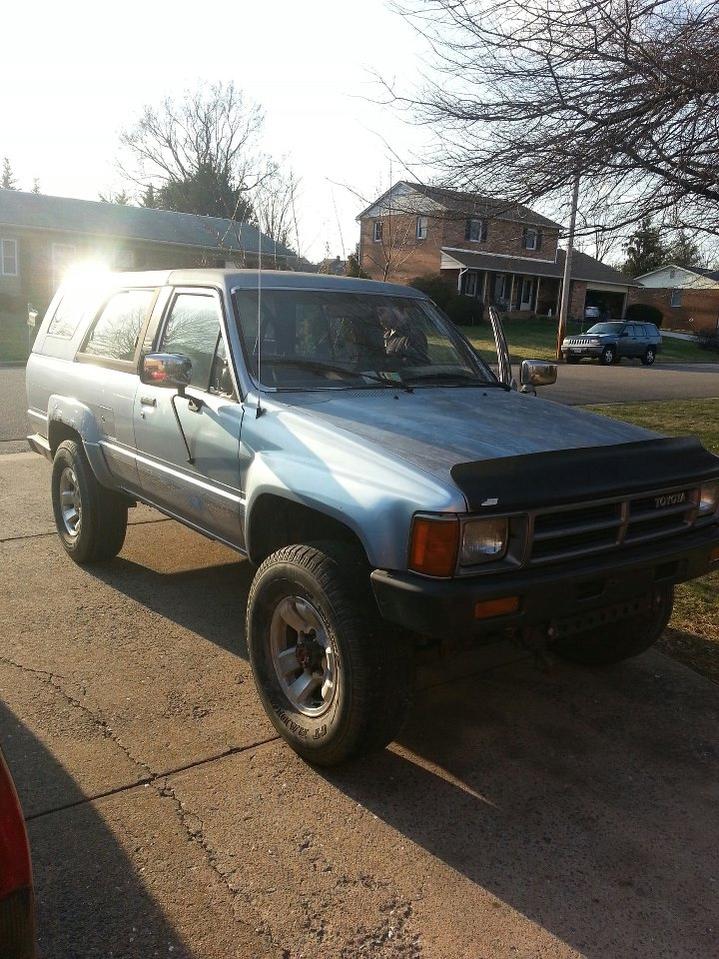

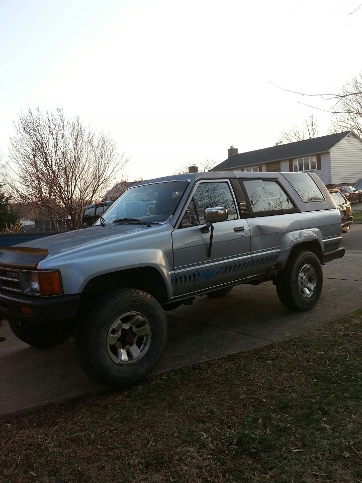

I appreciate all the suggestions guys. I managed to find a dolley for $30 bucks and I towed it back with my 4CYL 2WD 4runner!! and it had no problems whatsoever! Real proud of my runner! But I absolutely love my new 89 Runner! heres a couple of pics, il post the rest of them in my build thread!
