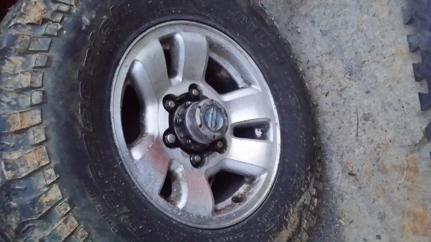

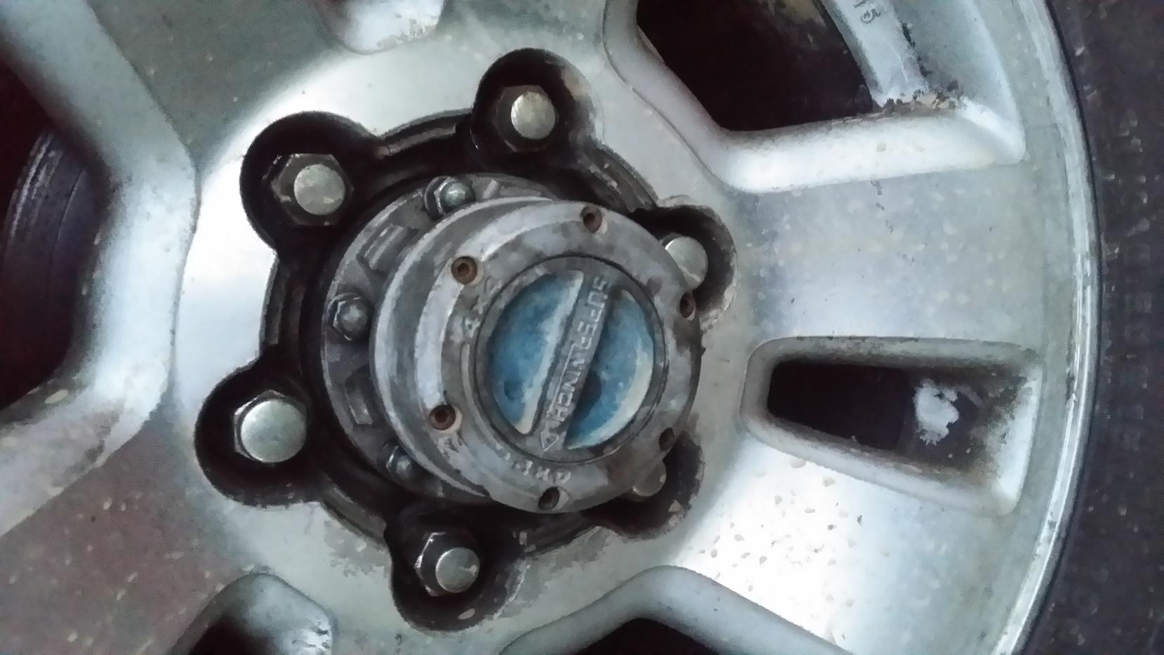

Well, I went and got them. Got the driver's side on and ran out of daylight. Really need to pick up a 54mm socket... Seems to work and switches positions smoothly. Locked the CV shafts turns, unlocked it doesn't. Don't guess I can ask more than that, right?
Oh yeah, it does get better - when I went to the counter to check out, the girl said it came to $40.50. I had planned on $70+tax, so B-B-B-B-BONUS!
Maybe someday I'll find some Aisins, but til then, I'll rock the SuperWinch hubs.

Run the superwinch but keep looking for aisin...aftermarker hubs dont have as much spline engagement and are more prone to failure
Yup, that's the plan. I'll keep my drive flanges and associated parts in a little bag in the back in the event I lose a hub. It'd be a pretty minor trailside fix.

Ah, see - $40, damn that is a hell of a deal to be able to lock and unlock your hubs on your second gen. For all you know they will last the entire time you drive the truck. Good find.
They should be fine with regular offroad use on 33" tires. If you are doing major rock crawling you have more to worry about than the hub...like the entire axle lol.
BTW, I paid full retail price (amazon) for my WARN hubs and then a mile marker conversion kit. Something like $250 total lol. I had no time and it was winter when my autos failed.
Yessir, I'm on 31" tires at the moment, and no plans for anything bigger. This 4Runner will only see occasional light to moderate off road use while it's in my possession, so I don't anticipate any problems with the SuperWinch hubs. I've tried them out on my property, and they do what they're supposed to. Pretty pleased with that $40. I think I'm about $1200-1300 into this thing with a $2000 start up budget. Need to get the heat working and find/fix a coolant leak (another thread) and it'll be ready for a day at Turkey Bay. Eventually a winch, but some recovery gear first.
