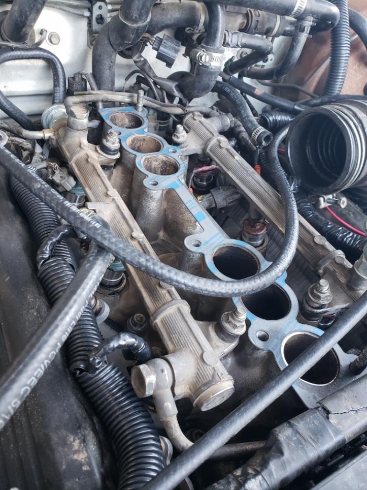

One other thing I forgot to write about, was the cold start injector fuel line. I broke mine of course. Lol. I looked for a replacement, and darn are they EXPENSIVE. So I found some 8 mm banjo fuel fittings, with 3/8" barbed ends. I then out some fuel injection 3/8" fuel line on them, with heavy duty hose clamps. For 20 bucks or so, I had a new fuel line. It worked out pretty good. Here is a photo of part of it. I left the hose long in this picture, so I could cut the line to length once the intake was back on. Hope this helps someone in the future.

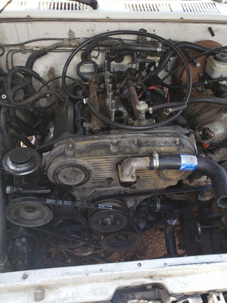

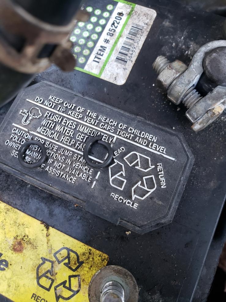

Well I took the intake off again, and turned the key on to pin point any and all leaks in the fuel system. I found one bad leaking injector and another that was dripping fuel. I pulled the fuel rail off and found one pinched oring, and a torn one. I guess I jacked it up when I put it on. Uggg. Well I put two new orings on, and was careful putting the fuel rail back on, and now I have no leaks. Hooray!!! Now that she runs, it's time to start on the front end. The suspension is in need of replacement. Then it will be time for new shoes. Thinking about running a 32x12.50r15 mud terrain tire. More pics to come.

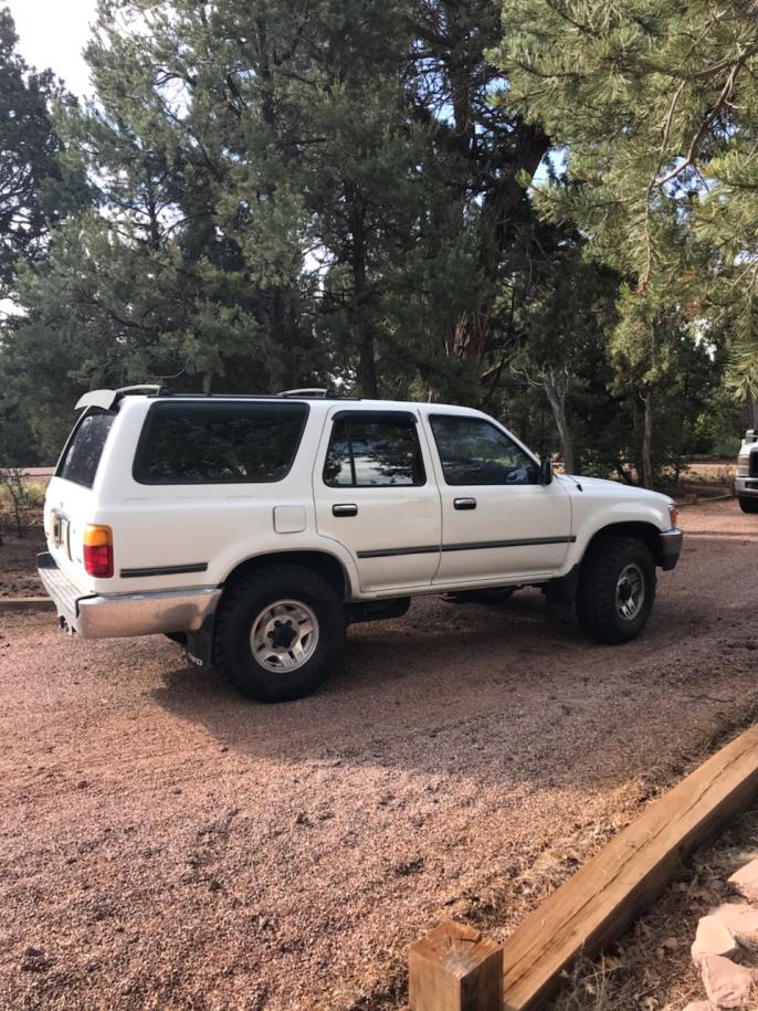

Well the front end is finished with alignment, and new tires. I'll snap some more pics tonight. But here's a teaser. Still some small things to finish up. Next on the list is to replace the shifter bushings, new locks in the doors, replace window motor in passenger side door, replace a few missing interior trim pieces, and replace gas door. I'm also going to need to look into the transmission, to figure out a weird downshifting issue. Now that I have been able to drive it, I've noticed it doesn't want to down shift when I feel it should. I'll probably start another thread for that.
