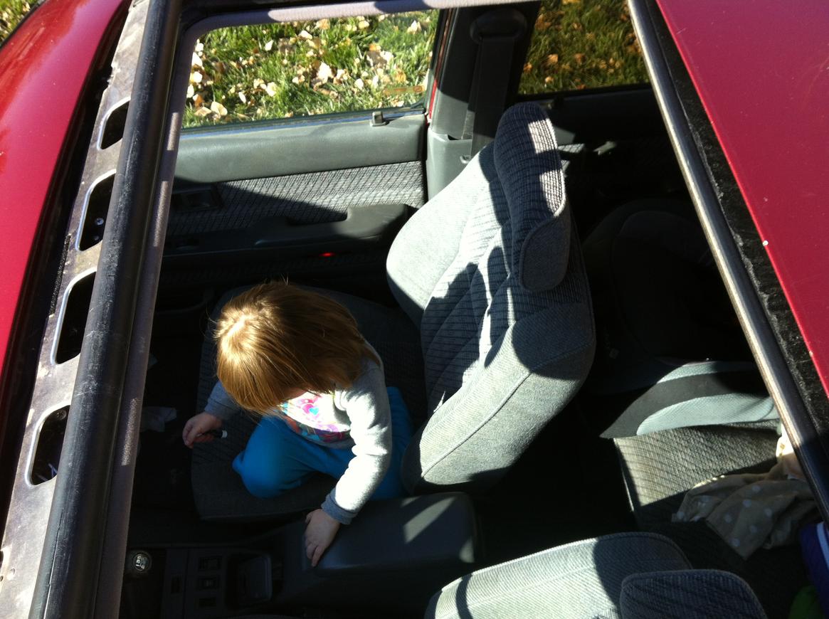

You where right. I need a new switch but i got it open and closed no problem. I called the steeler ship and they wanted $102.99 for it! EDIT found it here for $50 http://www.toyotapartszone.com/oem/toyota~switch~assy~sliding~roof~84860-35010.html
