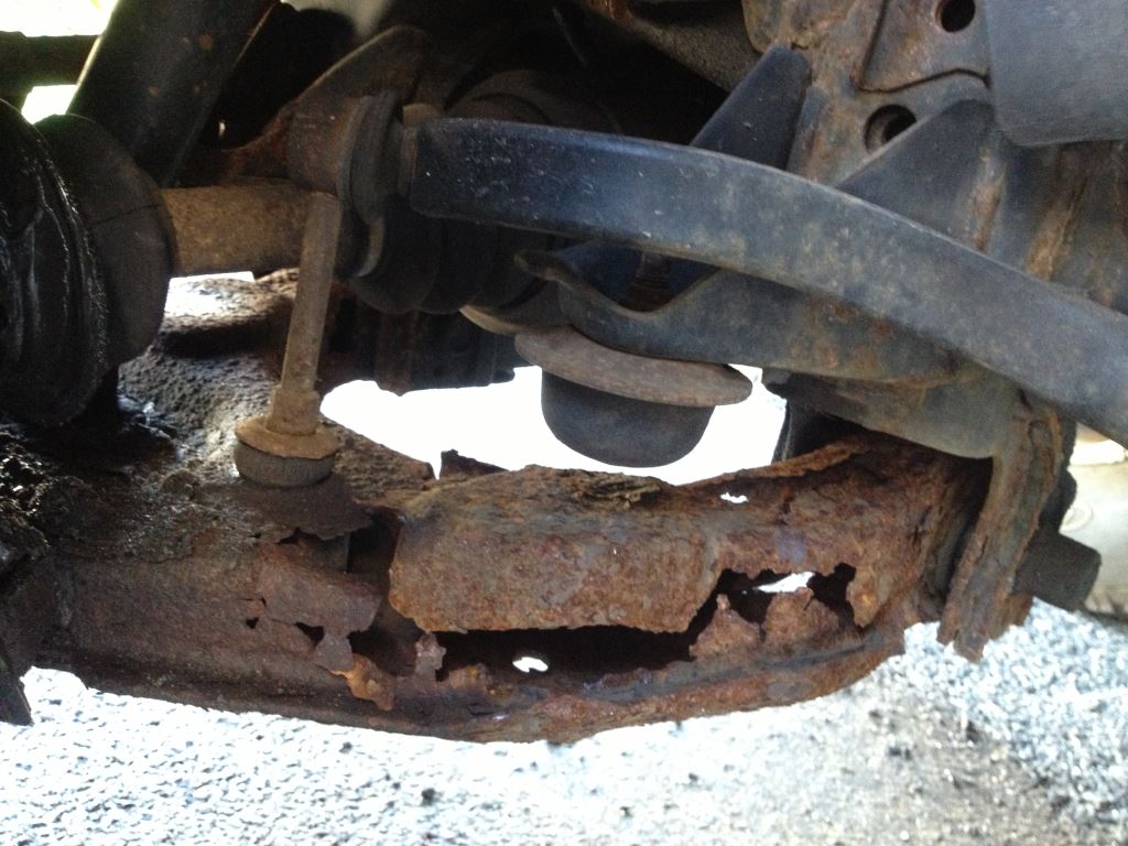

I have a 1995 FWD 4Runner with 142k that I've owned since new. It has started every time I turned the key for 19 years and still runs strong and shifts effortlessly. I just noticed that my lower control arms look like Swiss cheese (see pic). My uppers are not as bad but will probably need replacing soon as well.
The estimate for repair (uppers & lowers) was $2,600 and even though I thought I'd keep this truck forever, I think it's time to move on to a newer truck.
My question for the forum is how can I best monetize my truck? It runs great, has never been in an accident, interior is very clean (tan cloth), spare tire has never even been down. Is there a market out there for parts (mainly drivetrain, interior - dash is mint, doors, glass, wheels, etc.)? if so, how do I find buyers?
Any and all advice is welcome.
Thank you.
Assuming the rest of the truck is sound, you'll get your best money received vs. effort invested ratio by replacing those control arms yourself and then selling the truck. Paying a guy to replace them is silly, that's easy wrenching. You'll get probably in the neighborhood of $300 from a scrapper or junkyard - least effort, least reward. You'll make the most by parting it out, but if you're willing to put in the effort to part it out I don't know why you wouldn't put in the effort to replace the control arms and keep driving it.

Man that's an easy fix look around for a better price on repair,hell if you live closer to Lancaster pa I'd help u fix that,you buy beer lol
2600$, that's a stealership price isn't it?
If you have the parts list check amazon for aftermarket control arms from Moog, Raybestos, Mevotech. I have Moog and Mevotech parts on my 4th gen. No complaints so far.
Not a fantastic parmigiano reggiano toyota original part but better than swiss cheese; a nice mozzarella at least.
A non toyota shop will probably use these parts. You might find a shop that will install parts you bring in. And often these come with bushings, and ball joint. For a shop mechanic it will be quick, since he won't have to try and save and parts and he can torch the bolts if needed, and doesn't need to press the bushings or ball joint, wrench off, wrench on.

I did a quick search on parts for your truck:
Lower Control arms (with bushings and ball joint)- MevOtech $189ea x2
Upper Control Arms (with bushings and ball joint)- Dorman $250ea x2
sway bar end link kit- MasterPro $9ea x2
upper control arm bolt (hard to find) ???
lower control arm bolts $18ea x4
Lower control arm cams $21ea x4
lower control arm nuts $6ea x4
lower shock bolt $12
lower shock nut $2
I say fix it with aftermarket parts (or junk yard) and sell the truck.
of fix it with OEM parts and keep it another 100k miles
Keep in mind, if you part it out and let folks remove parts, they may do a hack job and render other parts useless/worthless, also that hunk of stuff could sit in your yard for a long time.
If it were me, i'd fix it, or get another 4runner, and dismantle this one and shelf the parts for yourself.

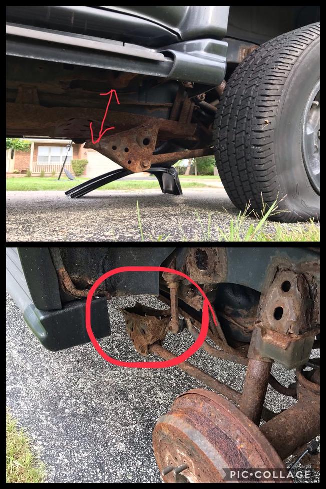

However if his control arms look like that and this is a New York truck I wonder what the rest of the frame and such looks like?
Exactly. I have the same problem (Chicago) ...you cant weld rust to rust, unfortunately (mine looks much worse though, truly crumbling before my eyes
