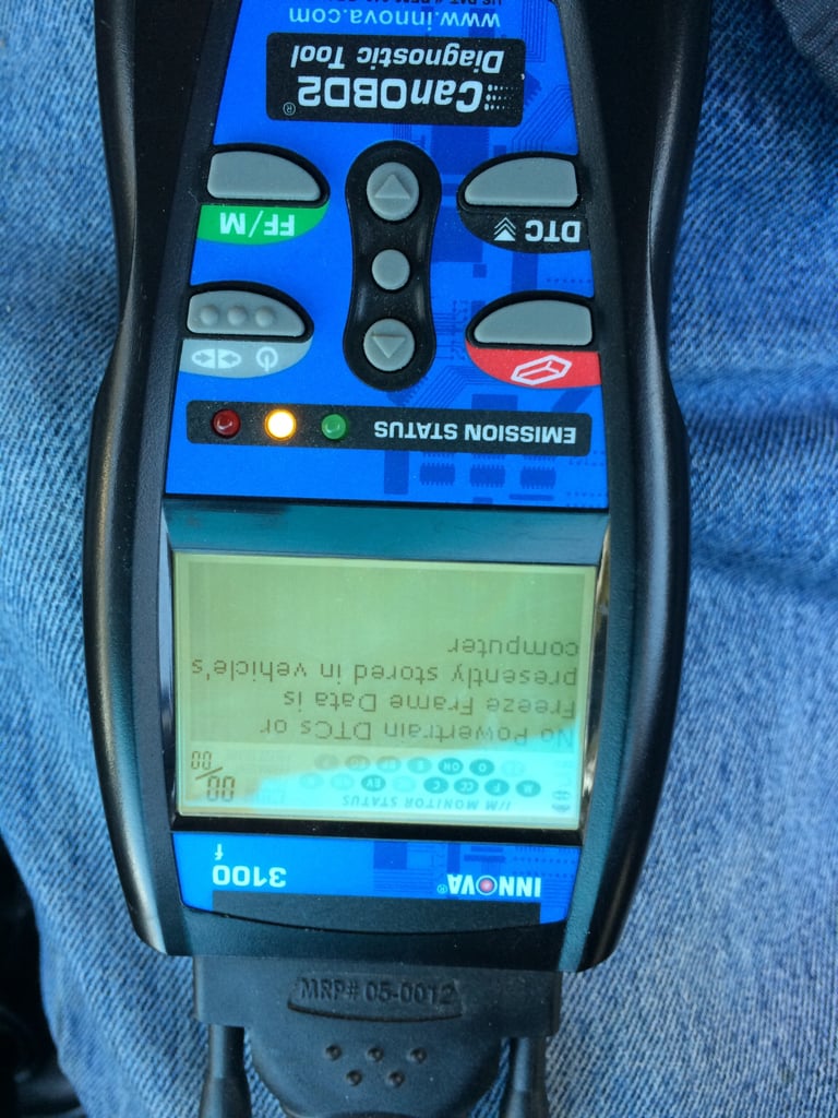

the C light is on my OBD2 scanner. not something from Toyota. I was told to clean the MAF and will need to do that soon.
The smog person did the cold start blah blah blah stuff to get it to pass smog and the numbers on my smog cert show up really good. I am just baffled by the slight rich smell and terrible gas mileage.
This is what my obd2 reader says. The c light in in the top flashes and the emission status yellow light means the system is not ready but it has not thrown a code because then the red light would be on.
Ah ok I mistakenly thought you failed the smog for the incomplete monitor. If I recall from my own California smog debacle, you can still pass smog with one incomplete monitor (as long as it isn't the EVAP monitor I think — not sure).
So I'm not familiar with your particular OBD2 scanner, but I'll venture a guess that the "C" light is for the catalyst monitor and that flashing yellow means it hasn't finished yet.
Not a mechanic but I'm going to say that with the poor fuel mileage, obvious fuel smell and slow to complete catalyst monitor — a full tune-up and replacement of the front o2 sensor would be the first things I would do. And that's my 100% unprofessional, unqualified and under-the-influence opinion.
If the front O2 has 75k or more, I would agree. They can degrade economy and performance well before they are bad enough to set a DTC and turn on the light.
