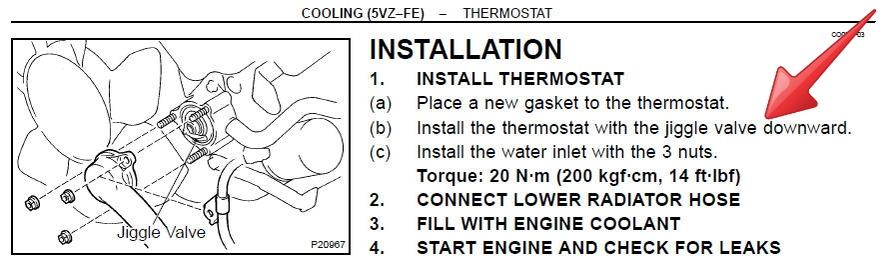

Is the thermostat in the right position? Jiggle valve down?

As Doc2012 said above, jiggle valve down is spec'd by the FSM and improves cooling according to several who have posted on here. (Or did you mean you are unsure which way it was done...if so, worth checking for sure...it makes a difference.)
Otherwise, you have a definite head-scratcher. Are you sure coolant mix is 50/50? You didn't dilute pre-diluted or vice-versa? Easy to check with a specific gravity checker. I'd hook up a live scanner and see what ECU temp readout is when it overheats (different sensor than dash gauge). Check your trans temp at same time, long shot your trans is putting too much load on the rad when doing the mountains. Maybe it needs a flush or an external cooler is your answer.

I looked through the photos I took during the head gasket job and I'm pretty sure I have the jiggle valve up. I will check and correct that here in a little bit.

Ok so jiggle valve is now in the 6 o'clock position and cooling system is burped. Going to give the drive a shot later on

Well, it didn't overheat! Fixed the orientation of the thermostat and kept the converter locked up with o/d off and the gauge didn't move. It definitely wasn't as warm a day as it has been, but I'll keep an eye on it. Thanks for the help and info guys!
