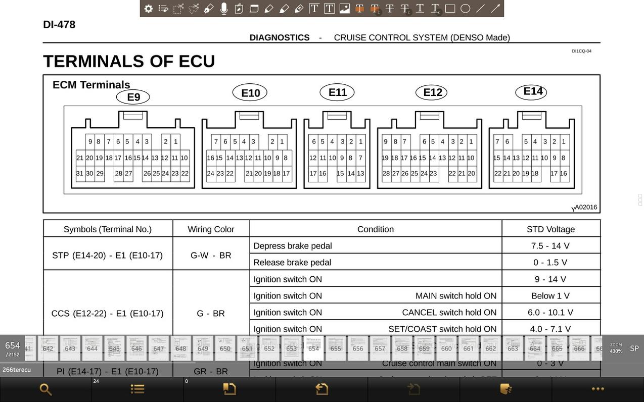

this isn't what your looking for?? it's inside the link I gave you...

It's missing the identifying page though. I found that page, but doesn't tell me which wires are which. There's a page that says what every single wire does on those connectors, which is what I need.

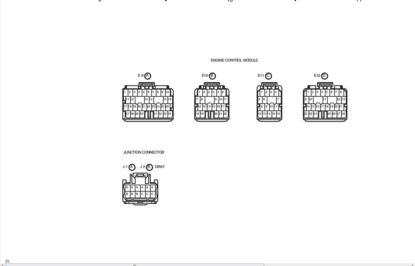

Yeah the old manual has been removed pretty much from every site. I did what I could for downloading it when I was able to. I think you want this, right?

Yeah, that's the ECU side so that's very helpful too.
