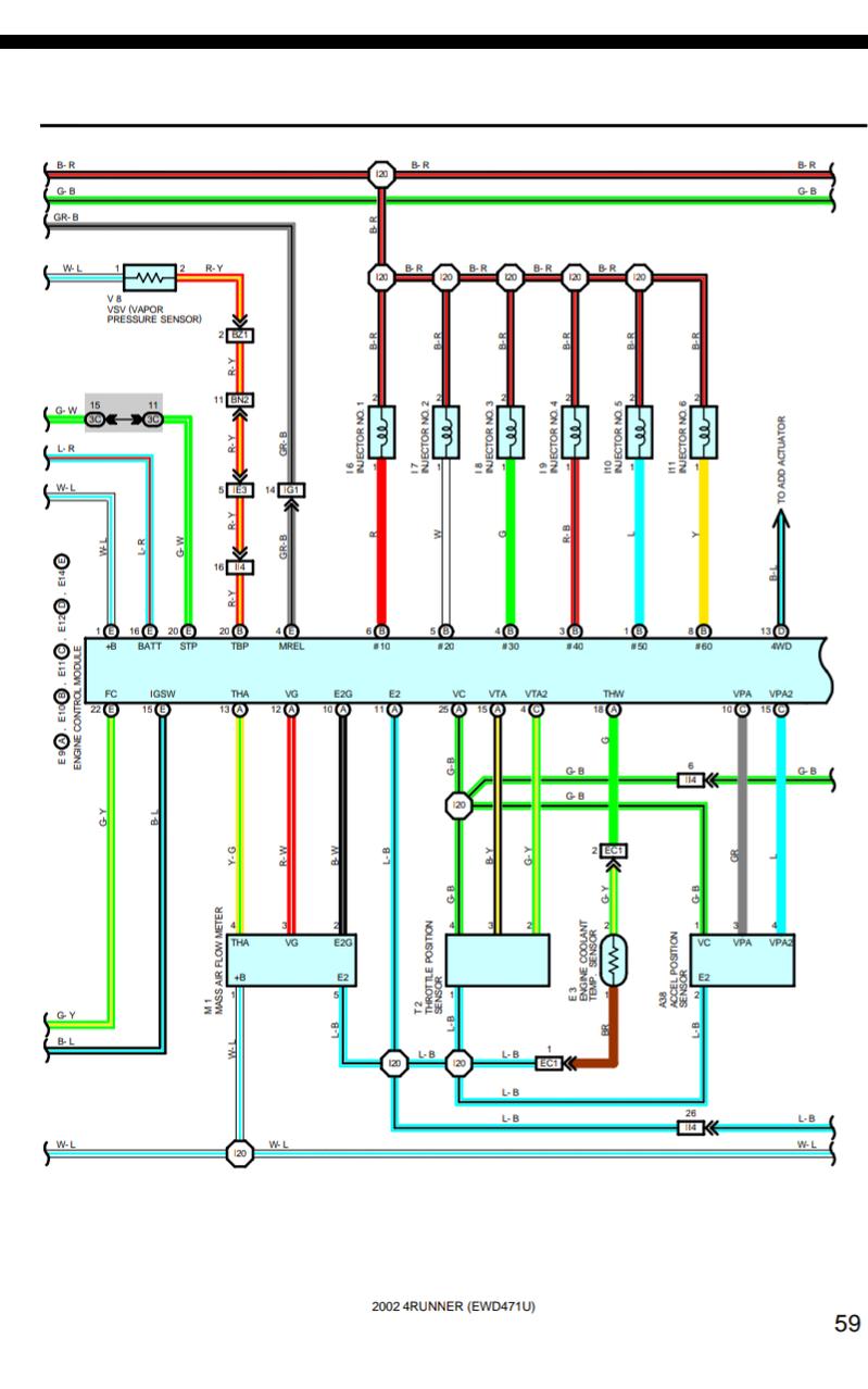

Hey guys I REALLY need y’alls help I need the wiring diagram for the fuel injectors for a 1996 4Runner 3.4 4x4 limited
I am not sure what exactly are you looking for but here is one that might help.
Peel back the wire loom/shielding, one shared wire is a ground, the other is the power. It's the same color all the way to the ECU and they are on the same plug, all in a row.
Thank you [MENTION=50279]spartacus[/MENTION] [MENTION=130956]Pedrojr80[/MENTION] [MENTION=115347]gamefreakgc[/MENTION] ..... the back of the ecm of my 96 has 4 slots later models have 5 I actually found the diagram I need and again thank y’all soooo much it’s been hard to find it and I i hope it fixes my mysterious misfire

He means 4 connectors vs 5 connectors, older ECU years only have 4 on the back of the ECU, newer years have 5.
You got that backwards. The shared wire is power, the individual wires are pulsed ground...
