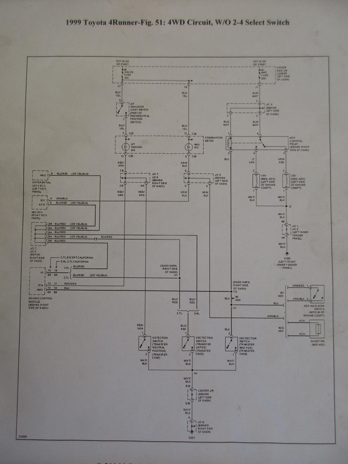

I have a 1999 4Runner, 4WD V6 5 speed manual, without 4WD select switch as Limited automatics. Had some wiring issues with the 4WD and would only go into 4WD low, not 4WD high. Wiring was Mickey Moused, so fixed it by killing Mickey. This diagram was helpful in getting it solved.
