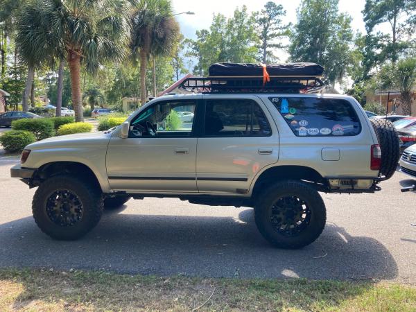

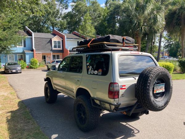

Well I have another budget friendly setup...the poor man's RTT. It's a camprite oversized cot tent that I will use as a RTT. Right now its just ratchet strapped to a piece of plywood. but soon I will attach the plywood to the basket with u-bolts so it can swing up so I can access the farm jack and traction boards underneath. Then I will create small slits in the cover and attach u-bolts from the frame to the board. Later on I will create a better mounting surface with flatbar, but for now I will see how this idea holds up.
This is how the tent will look all set up. Seems like a decent setup for a fraction of the cost.

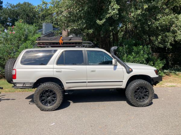

So I've wanted to do this for a while now and I finally found the right deal. I got my front two windows ceramic tinted @20% with a lifetime warranty and it all came out under 100 bucks. I'm really happy with how it turned out, it looks complete now. Not to mention heat deflection is very noticeable. In anything 85 degrees or less I don't even have to use the ac. When I do need it, I just put it on low and it gets cold almost instantly. I really didn't believe there could be such a major change, but there really is. I'd recommend this to anyone living in hot and humid locations for sure. Even if you don't, it modernizes the look of the truck. It will match even better after a few days when everything is dried.
Before:
After:

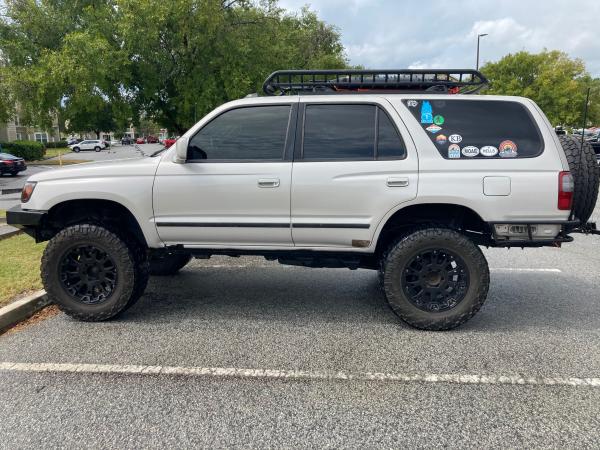

After multiple deals on 33-35" tires on 18's falling through and not being high on money, I sold the Misfits on Trail Grapplers. They were super cool and I think it would've been even better with 35's to make the 18's more proportional, but new tires for 18" rims are very expensive. This is why I ended up selling those and going for some 5th gen Tacoma steelies on 255/85r16 Maxxis M-762 Bighorn tires. I'm going to go from fat to skinny and I think I like the pizza cutters in just about every aspect. They're significantly cheaper, road noise is less, fuel economy is better, and still retains decent power with stock gearing. There's a special place in my heart for 315's on SCS F5 wheels though, but that's for when I have a salary. For just over 800 for the complete setup (759 for tires at Walmart and 60 for wheels) it's a very affordable way to get true 33's on anything else than the horrid double three spoke wheels. I have about 1/2" of UCA clearance at normal ride height, 1/4" when turning, and an unhealthy amount of rub when at full droop without wheel spacers. I really don't want to run them if I don't have to, so looking into stock UCA trimming until I get some JBA UCA's. I'm curious about it's handling off-road in different settings too, that will come later.

Nice! New wheels and tires look much better, good decision.
Thanks I appreciate it, I definitely think the 3rd gens look best with a 15-17" wheels, but glad I got to play around with the setup and make a couple bucks off it. Also made sure these will clear the 231mm rotors for the TBU that will need to happen in the future.
Just installed the 861's today and unweighted it looks pretty tall, but with bumpers and luggage it looks great. Rides well on rutted roads at high speed and flexes really well. Here's a couple pictures I took during a "study break".

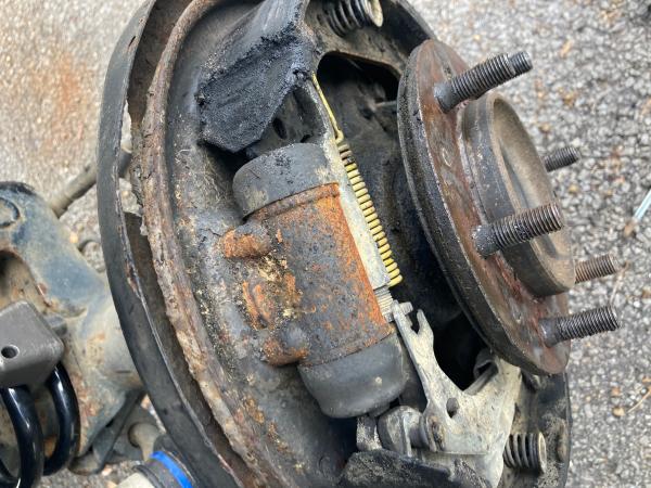

Unfortunately, I found out my driver's rear axle seal just went out. This is likely due to my TG diff breather getting clogged. I'm going to be modifying it so it won't hold pressure, but I will soon have to do the seals and go ahead with the bearings as well. Hopefully I can do most of the work myself and not break the bank.

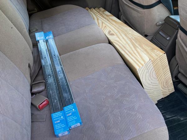

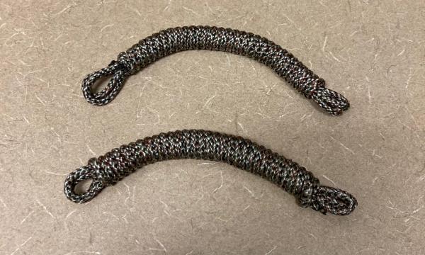

Another project I'm starting today is a drawer system. My interior design major girlfriend is helping me make it look decent and got me some of the supplies needed for my Birthday. After a Lowe's run, we made some handles from paracord, got the slider system, 2x12 lumber (measures 1.5"x11") for the supports, and have some plywood that needs to be cut to size. Just need to make the drawers after the platform is put together and sliders installed.

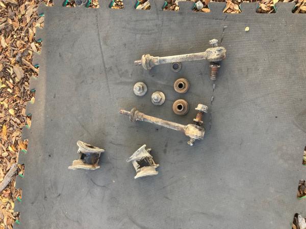

Got some maintenance done on the 4runner today. I was wobbling all over the highway, so i thought it was my rear control arm bushings. Got a set of those, but haven't installed them yet. Then I was inspecting my sway bars and I was able to move them laterally about 4"...the bushings in the sway arm brackets were absolutely shot, effectively making it like I was running with no sway bars at all front or rear. I removed the sway bar assembly completely from the front and got bushings for the rear and got up to cruising speed (70-75) on one of the more uneven roads and felt solid as a rock! For 25 bucks I'm really happy it was just that, so I can focus more on the rear axle seals and bearings over Christmas.
Saying the bushings and sway bar links were shot is an understatement.
I know, I know, they're MoOg, but 25 bucks and lifetime replacement got me

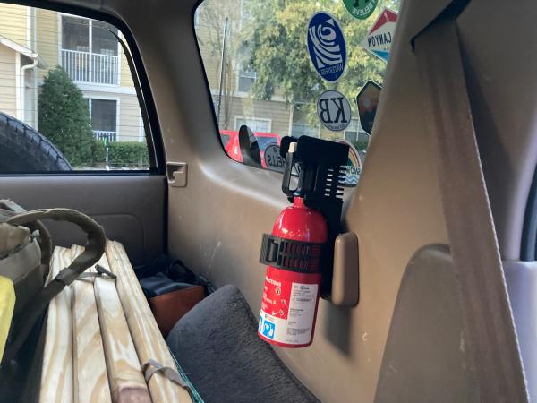

Another small thing but I installed an auto fire extinguisher where the cargo cover would go. seems solid, we'll see if it lasts there. Very important to have especially when camping because a bonfire can get out of hand quickly. Also, I've seen some vehicles burning on the side of the road and I don't want to helplessly watch my rig burn up.

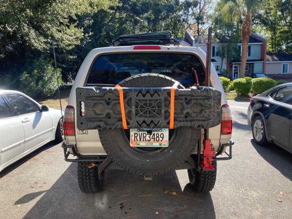

Wow, what an intense month of school. Pretty big update. First of all I have finished my platform system for the 4runner. Still need to lay some waterproof material on it, but the wood work is done. Just need to build drawers for it at some point.
My buddy also welded up a farm jack mount of the bumper so now I'm a real OveRlAndEr:frog:

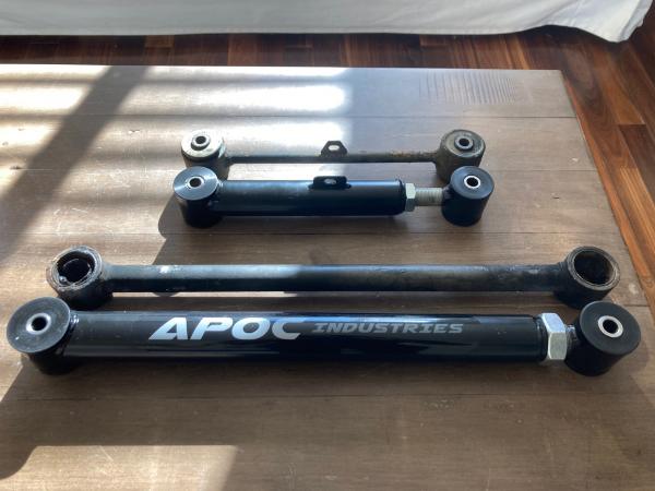

Also went another direction with the rear trailing arms. I went ahead and got Apoc Industries Adjustable control arms. These are noticeably better for my vehicle which has about 4.5" of rear lift. I got them on a deal on black friday for 400 shipped and they're made in America. Another plus with these is that they have not only a lifetime warranty, but lifetime servicing for free which blew me away. They make everything from one warehouse in Tennessee only about six hours from where I live so that's really cool and they're the nicest people on the phone as well. So a pre-install review so far is 5 stars for them.
I'm also planning on going with Freel Good Performance's outboard shock relocation kit after my spring semester is over. I will be getting some 12" shocks, which makes adjustable control arms a must without binding the rear end like crazy when fully flexed.
So that I won't have to notch the frame, I'm thinking about going with the Fox Performance series 2.0 shock with an adjustable remote reservoir. I have run Fox on my 2020 Trek Fuel Mountain bike and love them. It only has 130mm of travel in the rear and 160mm travel in the front. the suspension is highly adjustable though, so even though it is only a trail bike, I can dial in the suspension to perform better than purpose built downhill bikes with over 200mm travel front and rear that aren't adjustable. This goes a long way for me, so I think that a well dialed rig with 12" rear travel can perform better than some 3 linked long travel rigs with 16" travel that have not been dialed. I understand that there are limits to everything, but I do believe that adjustability is very important for performance. That just leaves me with beefing up the front end at some point...
I do plan to go pretty ham when I off-road in the future, but I also know that I am over-building it for 90% of my driving. My philosophy is that if I'm going to spend money, I might as well spend some more to get the full benefits. I know that this is becoming less of a college/high school level thread, but I'm in college full time and haven't been making money since I started and am still making it work, so you just have to be wise with the money you have and ration out the ramen supply.

One thing about (all) outboard shock kits is that if you don’t run 2-3” wheel spacers (depending on tire size) your tires will rub on your shocks when you flex. You could also notch your frame/wheel wells but that is an absolute ton of work. IMO the shock relocation is better for long travel jump type stuff where both tires get stuffed at the same time vs rock crawling where each wheel needs to be able to go up/down independently as much as possible. Not sure what your intended use of your truck is but I figured it was worth a mention before you spend that much $.
Very true and I forgot to mention that, but I have 1.5" wheel spacers already at the house and with the 255 skinnies it helps out a lot on room. I kind of want to get more into the high speed stuff while still being a reliable daily, road trip vehicle that can also crawl. I already have some toyotec 5.25" bump stops so I think I'll be good. there are a lot of calculations I will have to do before welding it on though, so I definitely hear ya there. It is also about 6 months in the future so I can't count my eggs before they hatch lol
