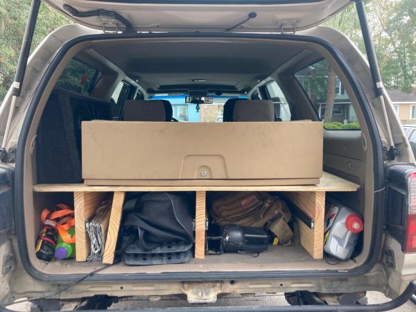

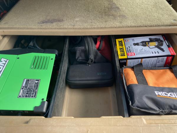

A friend who saw my Instagram page (4running_99) gave me their old lockable drawer system. I love putting it on top of the platform I made because it sits flush with the rear seat backs. No visibility loss and great lockable storage.

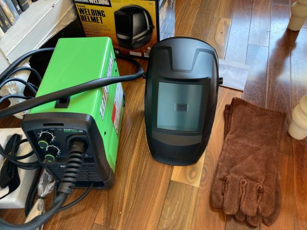

I got a welder for Christmas that I'm super stocked to use. It's just a harbor freight one, but is portable and only 15lbs so its great for me because I can take it to and from college.

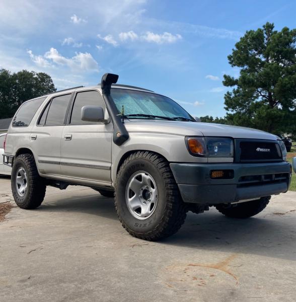

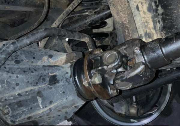

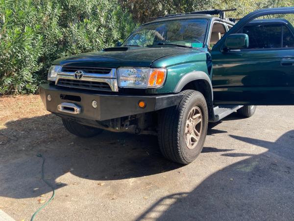

Taking 5 classes and 2 labs does not help with trying to build a bumper. I decided to get an oem one for now and once school gets out build my own. Picked it up for 75 bucks...not terrible. Also had to replace the u-joint which took about 20 bucks and 3 hours with a crappy autozone rent-a-tool.
I will probably be spiffing this up a bit with a lightbar and pod lights...basically experimenting for the fabricated one.

Napa ftw...don't mind the gallons of pb blaster lol

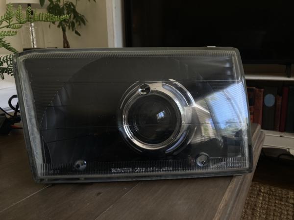

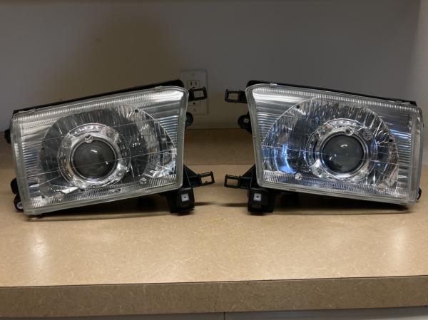

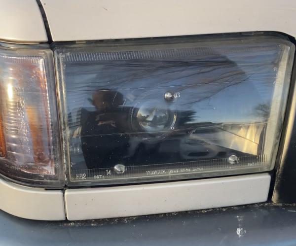

I finally did probably the most worth while upgrade for the money...DIY retrofits! I bought $29 nilight 2.5" projectors with shrouds and customized my LED's to fit in the projectors. I painted my housing and shrouds satin black and here we are, under 35 bucks and 2 hours of my time!

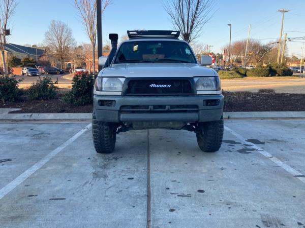

Wow, sure has been a while. Redid my thermostat and went with a champion aluminum radiator. Also put the 4runner on a mandatory diet as my tire carrier gave out on me. It’s kind of grown on me though. I might also go back to 891’s because I don’t have so much weight back there anymore.
Another thing I’ve been doing is making custom HID retrofits for people. I know, I know…it’s HID’s. The point is to give people better and cooler retrofits at not such a premium price. I start out at $300, which comes with TYC housings, projectors, lights, ballasts, wiring harnesses, and everything else prebuilt and ready to go. I reduce the price to $225 for those who give me their housings. Overall it’s been a great way for me to help people and make some money on the side. Here’s a couple of retrofits I’ve made.

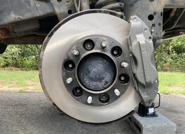

Got an internship that’s working me 9-10 hours a day 6 days a week so I haven’t been able to do too much to the 4runner unfortunately. I needed to replace the front calipers and rotors so I thought I might as well do the TBU and I really like it. I don’t love it because I didn’t replace the brake lines with braided ones so it’s a little spongy but when they engage it’s really nice. The biggest difference to me is in slowing down a bridge or mountain to a stop. I’m also trying to make a front and rear bumper, OSR kit with 12” shocks, and get a Yakima rack with 58” crossbars second hand. It seems with work all my plans are a pipe dream, but hopefully I’ll have time during school to accomplish my list

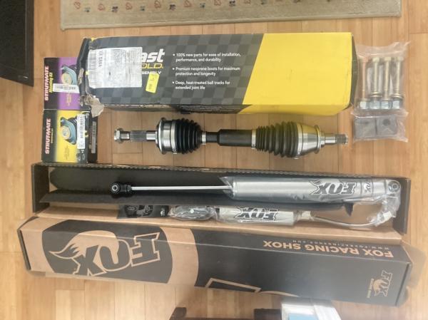

So I did a thing…
For parts:
- Duralast extended cv axles
- Fox Performance 2.0x12” shocks w/resis
- 333Fabrications can eliminators
- Top hats
Upcoming Maintenance:
- Valve cover gaskets
- Oil change
- Alignment
Finally finished up my summer internship and with the extra dough I decided to get all the maintenance I’ve been pushing off done and then treat myself to some nice suspension. My buddy (HewIndustries) is making an osr kit for me in a couple weeks so that will be awesome. Decided to keep the 5100’s up front for now because after extensive research I found that they had the longest stroke length of any front shock/coilover for our rigs…besides fox’s 2.5 coilovers with the same stroke @5.49”. This means that the shock will not be the limiting factor in the travel, the cv axle binding would. Hence, the extended length cv’s. These are longer, designed for 2-4” lift. They also have 30% more angle to them. The shaft is also beefier than the stock cv’s. Finally, the boots are longer and designed not to rip. A lifetime warranty is nice too. So now that the cv’s and shocks aren’t the limiting factor for travel anymore, it’s literally down to the bumpstops. If I take those out or replace them with durobumps, I think the Uca would technically bind up before the LCA hit the frame, but it would be very close. I need to get UCA’s at some point, but that will be later. There is a 1” spacer on my front shocks that I’m getting rid of and my tops hats are cracking, so I thought I might as well get new ones and then get an alignment. And if I’m going to get an alignment (my alignment is already super bad, my tires have been suffering) I might as well get cam eliminators so it won’t get knocked out of alignment. Wow, diarrhea of the mouth…anyways, stay tuned for the crap ton of work before I have to go back to school.

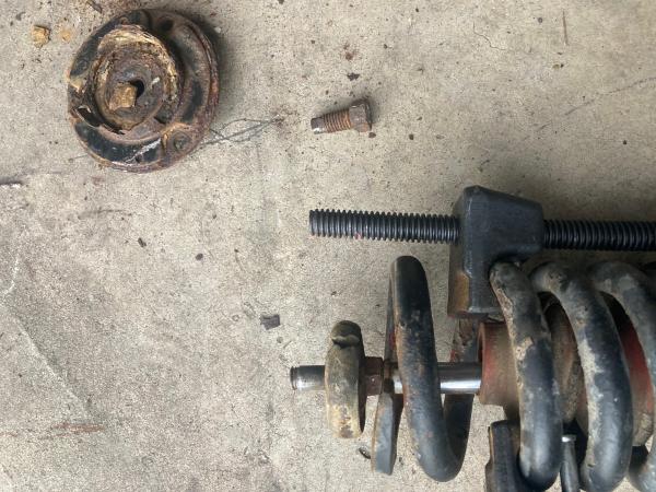

Welp as I was trying to replace my top hats and remove the stupid spacers, I snapped the shaft of the shock. Everything was so rusty on it that I had to dremel and angle grind the top hat bolts to even remove the shock. Getting new B8 5100's now as I can't afford to drop 1500 on coilovers. Going to reuse the springs I have now and I already have the new top hats, just a pain with the first week of school to be out a car. At least I'll have new suspension in all 4 corners when I install the Fox's with the OSR kit. I don't think this had anything to do with the overall rust factor of the vehicle, rather the previous owner probably decided to leave the stock top hats from 211k miles in when he decided to switch out suspension and that area can pool with water. Anyways, all the new parts should be on the rig before too long.

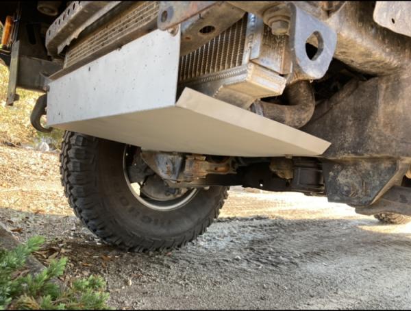

Much overdue was a radiator skid plate. Just wanted to make one myself so after a couple hours of getting material, grinding, bending, and welding we have it. It's super basic and I will be doing a redesign, but for $60 I wanted to try it out and see if I like fabbing my own stuff. It was a lot of fun and I have better ideas for a better looking and higher clearance one. I did create new mounts to where the upper bolts go, but reused the stock mounting locations for the bottom. The reason I needed one is because the aftermarket Champion Radiator sit lower than the factory one, which made it impossible for the stock skid to mount. Anyways, just thought I'd share the little update.
