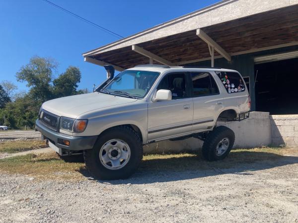

Really haven't had too much time to post anything, but I've been doing a lot on the 4Runner.

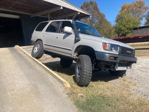

Freedom UCA's
Cheapo LCA's with poly bushings
Moog LBJ's
Duralast Gold Extended cv's
333Fab Cam Eliminators
Its was a total pain and took forever but hey I'm pulling over 10" travel up front and 28" fully flexed out.

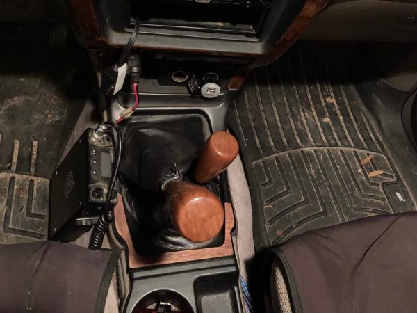

Exams are finally over, now I can have fun. went mountain biking with my brother and friend. It's fun because you actually have to use 4lo to get to the trails so I was able to get off the fire roads for a little bit. Also got to climb up an abandoned fire watch tower. I had a friend make me some wood shift knobs and I switched back to the chrome grandpa front end for now. Going to make some descent LED retrofits now and keep the chrome look.

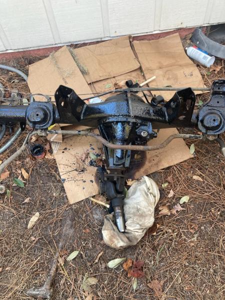

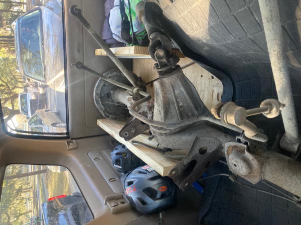

Well junk yard find of the year for me (and my crappy junk yards). Elocker axle picked for $220. Definitely crusty and doesn't have the actuator or wiring harness, but it's okay for that price. Later I will get the front diff to have the same gear ratio. Best part is that it only has 150K miles. I will clean, POR-15, and throw it in there hopefully over break.
Making some progress on the axle. Put POR-15 on it and going to grab a new motor/wiring harness and throw it on the rig at some point.

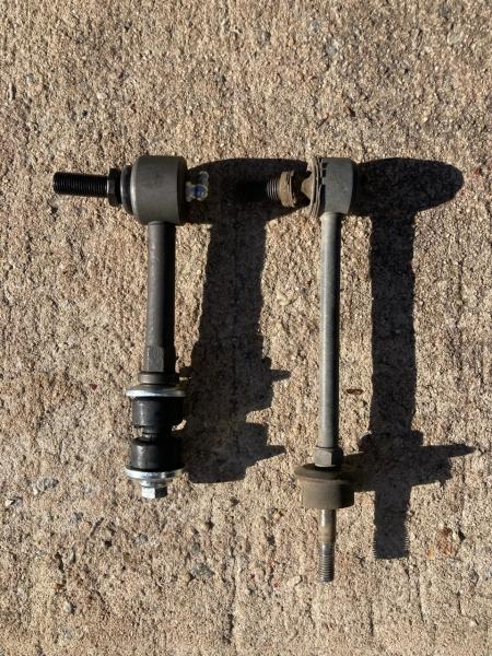

Also, replaced the 2nd gen front sway bar links for some heavy duty oem replacement ones. The old ones were too long and hitting the lower track arms from apoc industries. Feels better and no more smacking the lowers.

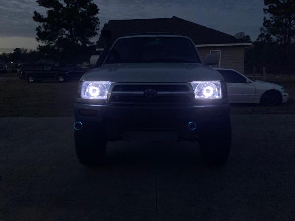

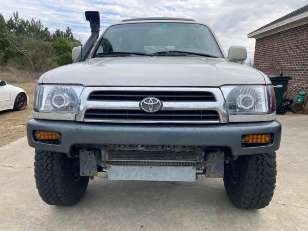

Finally installed some LED retrofits in the grampa spec chrome shrouds. I honestly prefer it. The LED compared to the HID is insane. So much light output for $100.

I've been debating on LED vs HID retrofit projectors for a while now. Since you've had both what's your opinion on them? What brand HID and LED did you use?

They look good, nice work.
Did you use a kit or source all of the parts yourself?

I've honestly just used amazon brand for both. I would say GENERALLY LED is going to be brighter, simpler, and last longer. I never had a single issue with the HID's though in about 1.5 years of constant use (I always drive with headlights on). One thing to note with HIDs is that they have a high heat output, so if you live in a region where your housing could freeze over or if there can be snow buildup, HIDs are known to melt that off. I just like LEDs more because I don't have to worry about the colder conditions and it's just better light for the price. Also, it's less wiring because there's no ballasts. I'm sure if you get really high quality HIDs they'll have really good light output, but the Amazon LED retrofits are much brighter for the price.

I sourced the parts myself.
LED projectors:
Amazon.com: YUFANYA 2.5 Inch Bi LED Projector Lens with Hi/Lo Beam,70W 20,000LM 6000K,White Angel Eyes Chrome Shrouds Mask,Fit H4 H7 9005 HB3 9006 HB4 Car Motorcycle Headlight Retrofit… : Electronics

Amazon.com: TYC 20-5652-00 Toyota 4 Runner Driver Side Headlight Assembly : Automotive

Amazon.com: TOMALL H4 HB2 9003 Male Socket for LED Replacement Headlight Connector Wiring Harness Conversion Kit : Automotive
If you run into any problems, This thread explains how to wire everything properly:
HELP! Project Retrofit Wiring
