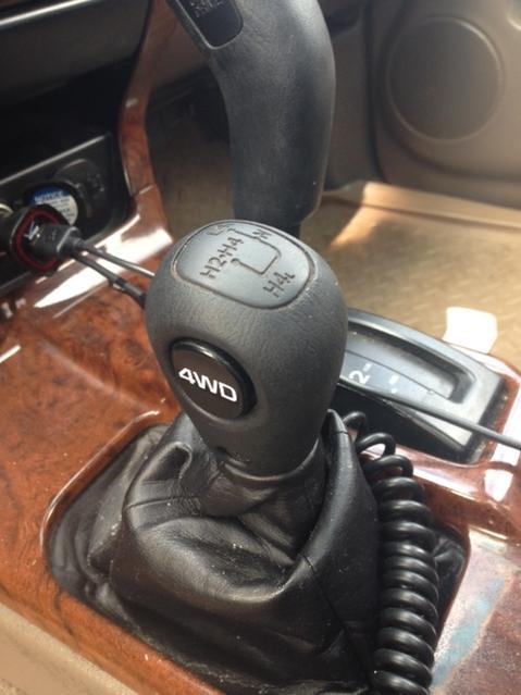

No 3rd gen has full time AWD. Here's a picture of my 99 selector. Notice the button on the side to engage 4 high.

You have a Multi-Mode T-case with Full-time 4wd capability. Often erroneously referred to on here as AWD.
Pushing the 4WD button engages the front drive, but the differential in your T-case is still open which is to say unlocked. Hence you are then in Full-Time 4wd. If you then pull the T-case shifter straight back to "H4L", that will lock the differential in the T-case and you will then be in Part-Time 4wd.
The '99-'00 4wd Limited models, and '01-'02 4wd SR5 and Limited models, all have a Multi-Mode T-case with Full-Time 4wd capability. Although the method of locking the T-case differential varies between the '99-'00 Limited's, and the '01-'02 models.
