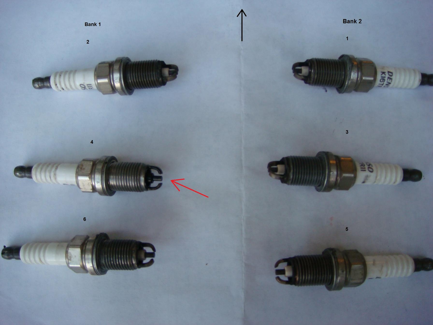

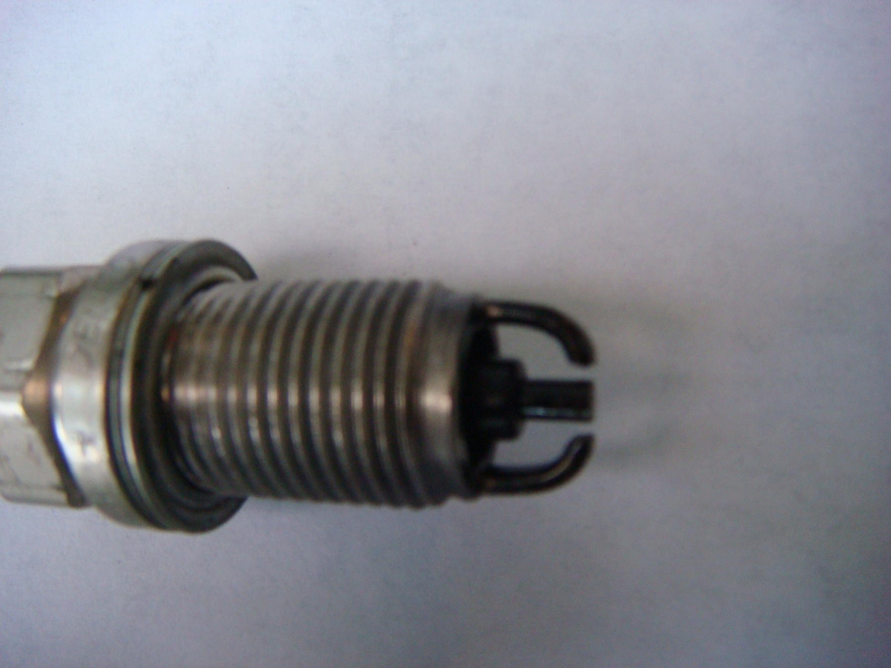

Went to get a couple of leak test tools/kits today but wasn't able to complete that mission (refusing to go into a major repair)... Came home and something told me to remove the spark plugs to trace the actual problem and found it! When removing the plugs, I noticed that spark plug #3 (the one in the middle, bank 1, driver side) was soaked in something that wasn't gas, it had a strong smell and didn't evaporate as gas will do. Did a second compression test and the lowest reading came from that cylinder, 165psi vs an average 195psi for the remaining cylinders. From a visual inspection, I also noticed that the piston heads were all covered with the usual carbon deposits but that one which was nice and clean with a yellowish aluminum color. I was also able to read a letter "B" on it.... So, that means tomorrow is the day, heads out.

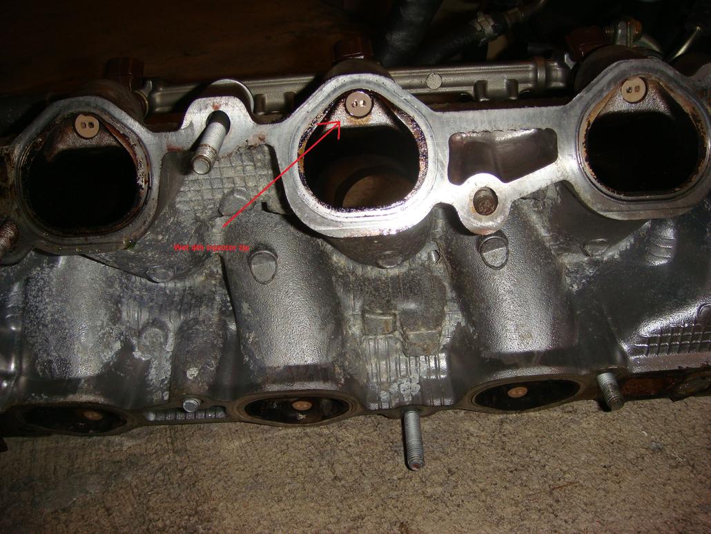

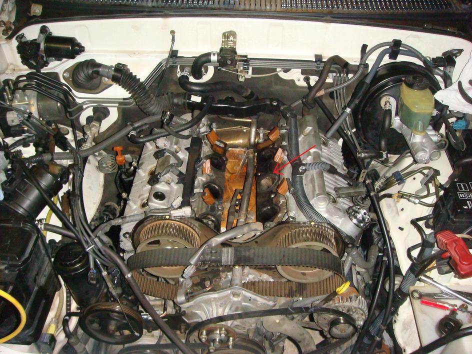

Started removing bolts and nuts like there's no tomorrow! If replacing the timing belt (which is something I will surely do simultaneously along with the water pump, oil seals, etc.) is not easy, tell me about removing the heads! Tomorrow I will finally complete the task. Just wanted to share something I found in the way. As soon as I removed the intake, I noticed fuel coming out of injector #4 (bank 1). Actually I mistook this injector with injector #3 in previous posts. So.... there's part of my problem and I say part cause anyway I was getting white smoke, so the party goes on. I will include some pics of my findings for the benefit of all. You will notice the difference between the cylinder 4 intake (cleanest) and the rest of them. You will also see the injector tip soaked even after hours of being removed. Apparently it just stuck open.

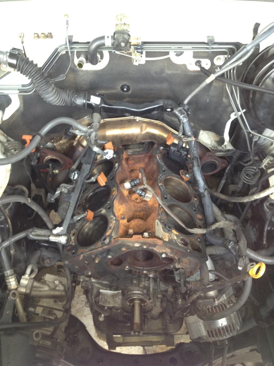

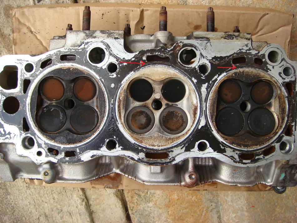

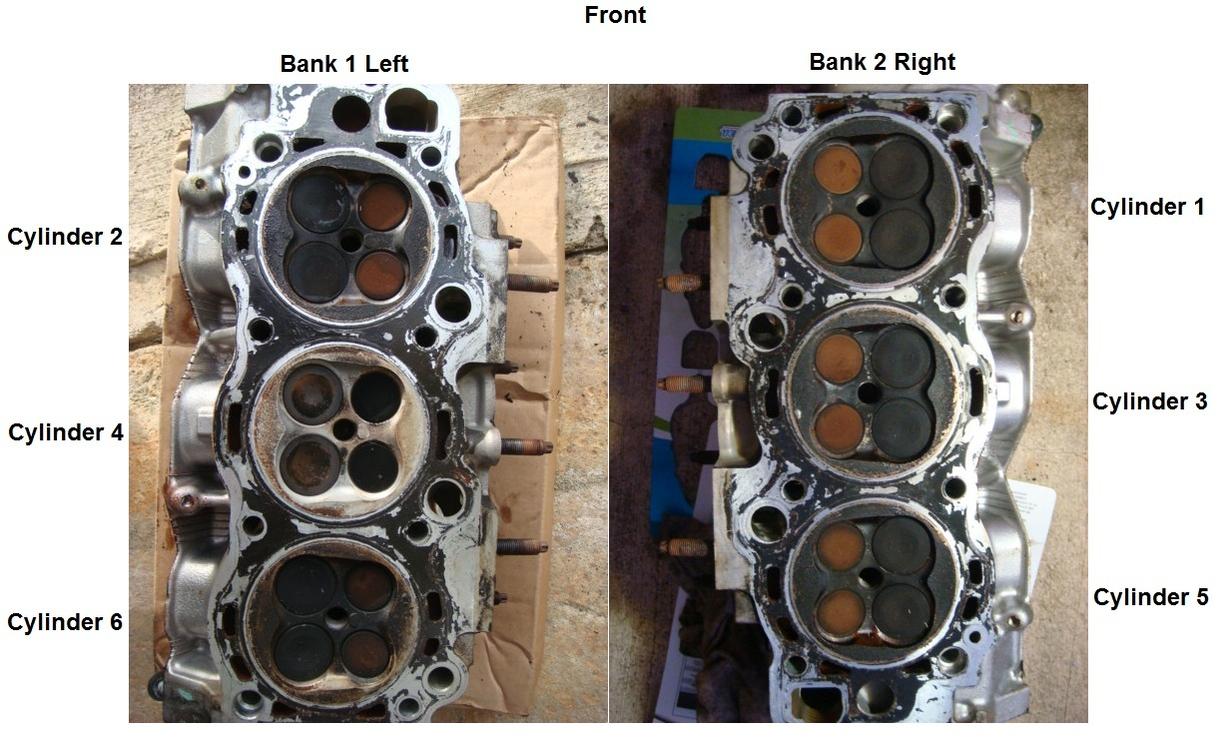

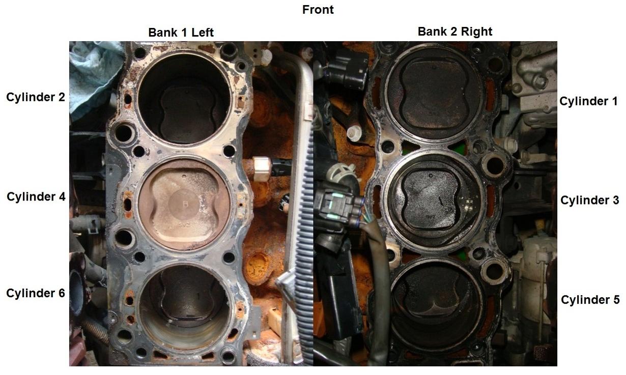

Heads finally removed today (had to wait till my vacations to do it). Can't say I found a visible and obvious spot where coolant was actually going inside cylinder #4 but there was a suspicious area between a coolant passage and the cylinder in which the surface wasn't polished and nice looking like the rest of the head surface. You will notice the difference between banks and cylinders. Bank 1 looks fine, even color on valves and piston heads. Bank 2 looks uneven on everything, actually cylinder #6 doesn't look healthy either. I think it was failing too, maybe injector and or coolant intrusion as well.
Will take the heads to a machine shop to have them pressurized, have them valves rectified and checked for tight seal, have all valve oil seals replaced by OEM ones and also have the heads resurfaced.
Regarding injectors, wanna replace all of them. Any suggestion? Read about it and it's real, injectors can fail and you will not know it till it is too late. A plugged or partially opening injector can trigger an increase in temperature which ends up in a premature gasket or head fail, maybe that's what happened in my case. There are options such like replacing them by remanufactured OEM ones. Recommended? New OEM ones ($150.00 each)? Non OEM recommended by you guys?
Not so easy to work on these engines! Man I have been working for about 10hrs or so up to now to finally remove the heads, Still have to clean everything, remove the crankshaft pulley, timing belt, replace oil seals and buy everything needed to put my engine back again once the heads arrive.

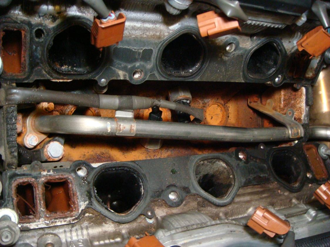

Nightmare just ended this weekend. Had to wait for some parts such like new head bolts (no one was sure if it was ok to reuse the existing ones), part of the wire harness (the one that connects to the sensors underneath the intake manifold as the connectors broke when I tried to disconnect them), new crankshaft time belt pulley as I broke one of the teeth (I messed it up in that one - $50.00), etc. Finally put everything back again and my SUV is up and running! What I found and what I learned? I replaced the red coolant my 4Runner brought long time ago (at 30k miles) and started using green Prestone coolant since then. I've read a lot and although people everywhere say green coolant is not good for aluminum but good for iron, I would say a different version. Heads were 100% fine, no corrosion at all, but that wasn't the case for the cast iron engine block. There was corrosion everywhere, even on the areas around the cooling orifices. TG I didn't have to resurface the block. I also found that the gaskets these engines have are the MLS type (Multi Layer Steel) and seem that the middle sheet is made out of carbon steel as I noticed rust particles coming from between the outer layers. Apparently the green coolant attacked the gaskets and that's where the chaos began. Other than that I found a fully open injector which I caught when removing the intake manifold. Just removed it and fuel started to drip from that one injector (fuel hoses already disconnected from the fuel rail). I will post couple of pictures of the process and of the gaskets so you can see what I am talking about. Right now I am just struggling with the IAC Valve. Cleaned it before installing the throttle body and seems to be stuck now. Engine idles low during cold start, idles high when hot and once I get it disconnected, the engine idles just fine (getting code P505). Will fix that on the weekend.
