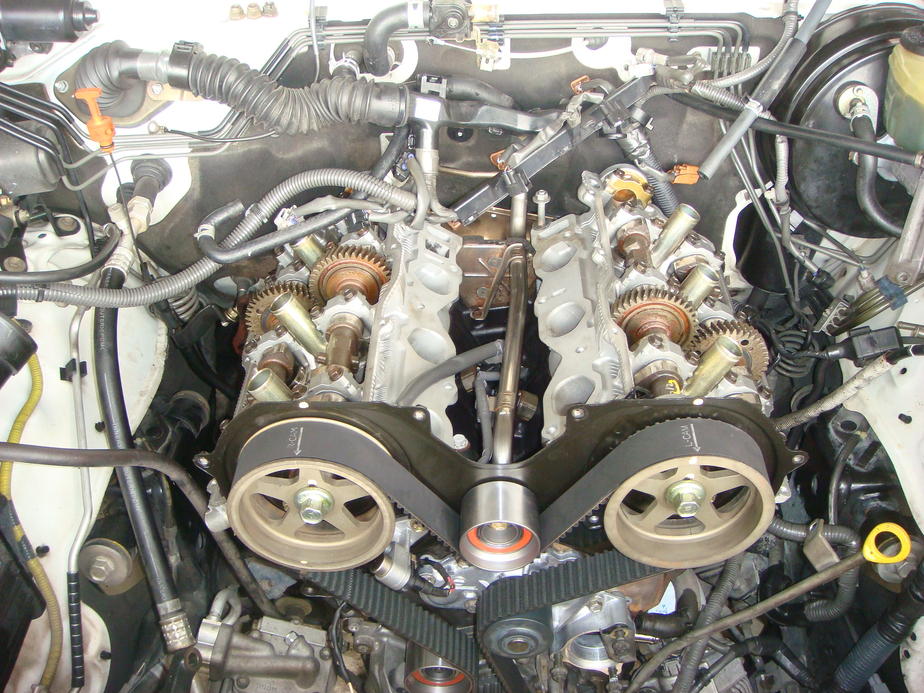

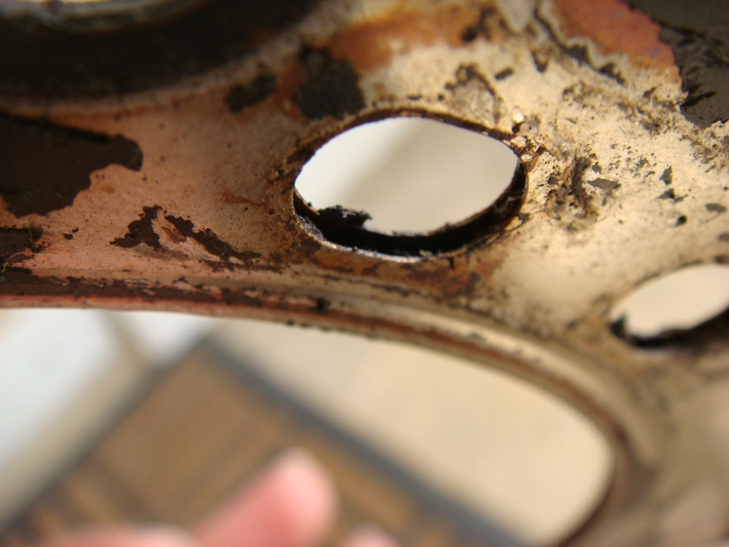

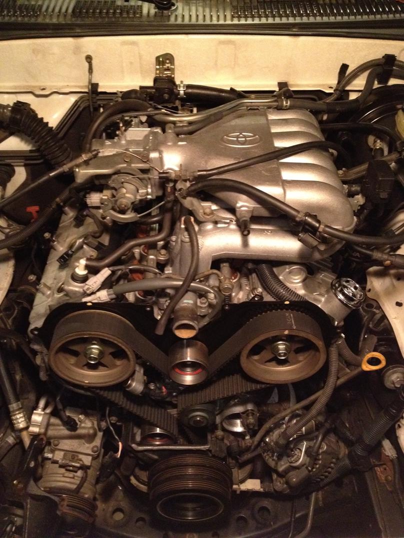

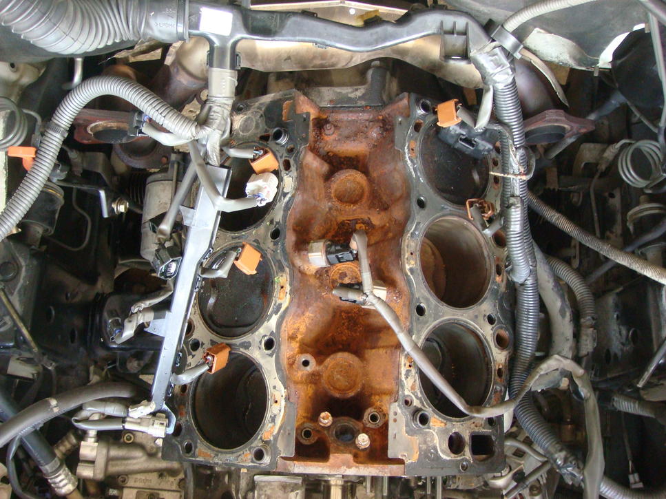

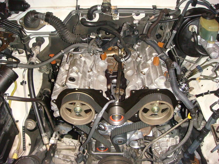

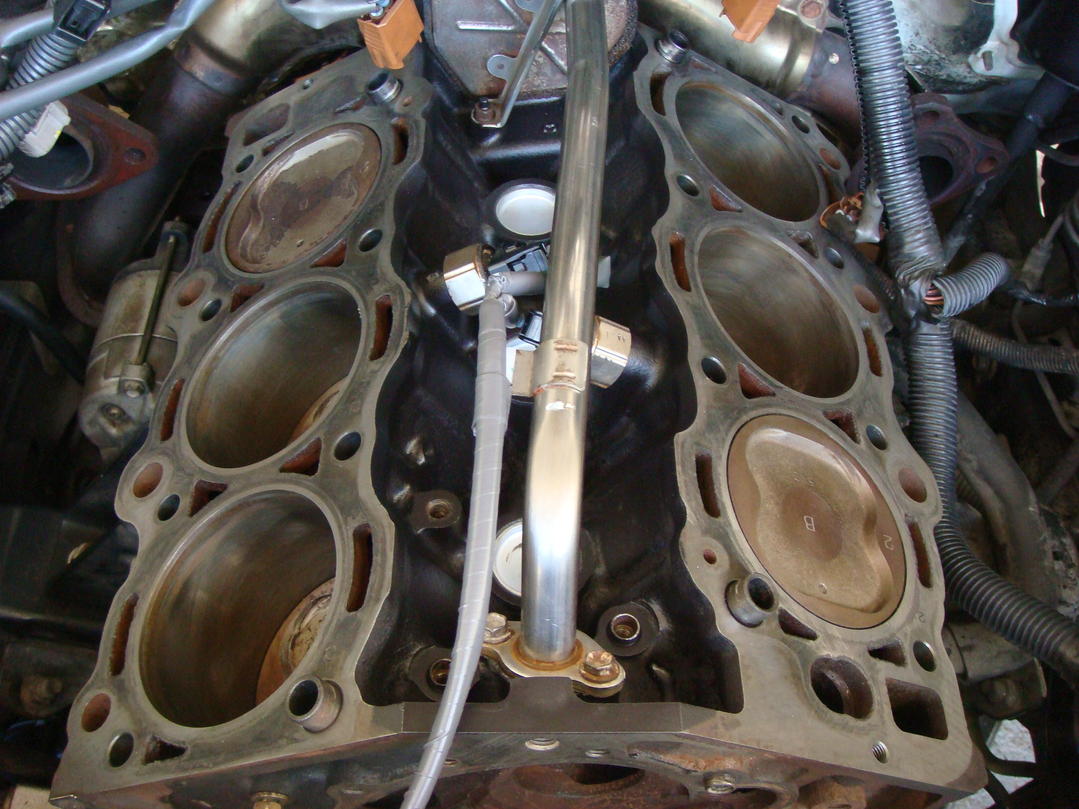

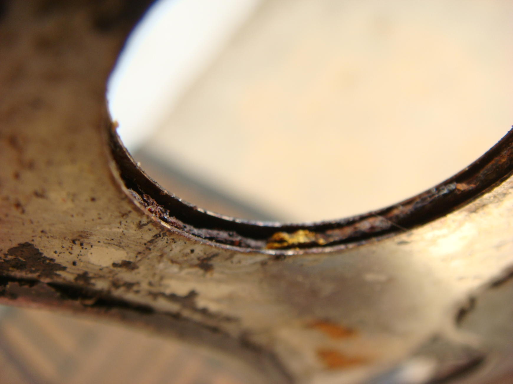

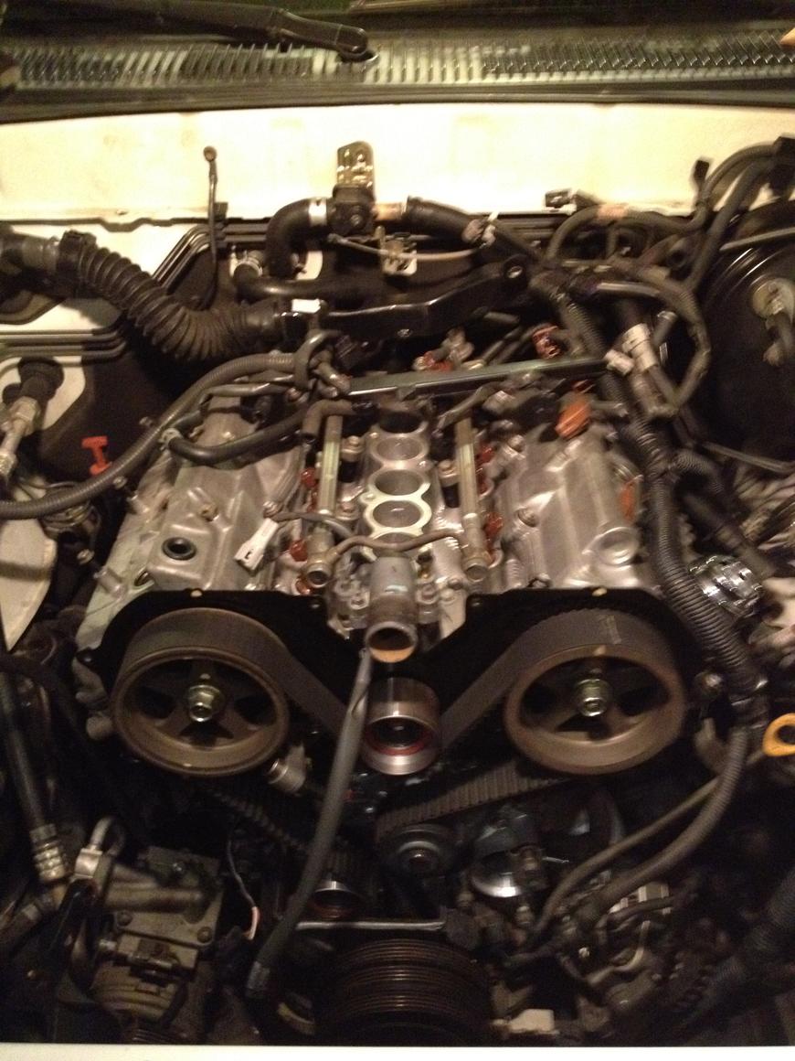

Some pics about the repair stage and damage found on the gaskets. Notice the middle layer severely corroded. As mentioned before, I always used Prestone green coolant, replaced every year. From now on, just Toyota red coolant for my runner.

Thanks for the pics. The new looks great.
Per the rust, are you the original owner? I have seen other autos with bad coolant rust when they may use tap/garden water for the mix when the coolant calls for it.
ok so toyota red coolant only... check. can you fix any damage/corrosion caused from running the green stuff without tearing down the engine?
Same and only owner since I got it at the dealer 12 years ago with 000000 on the odometer! Took me by suprise when I saw all that rust. Believe me, if I had put tap water in it, I would let you guys know, but is not the case.
I don't think rust can be removed or fixed, but stopped. I am no expert on coolant types, etc, but I have read a lot in order try to understand what happened here. Actually if I am not wrong, the manual just calls for ethylene glycol and does not specify anything about rust inhibitors which is a different stuff. Red coolant inhibitors are phosphates while green's are silicates as I have read but there are also mixes and some other types like OAT's which is the orange one... Sometimes is just confusing. In order to avoid this type of event, I am moving back to red coolant, even bought it at a Toyota dealer. Let's see how it goes :D
