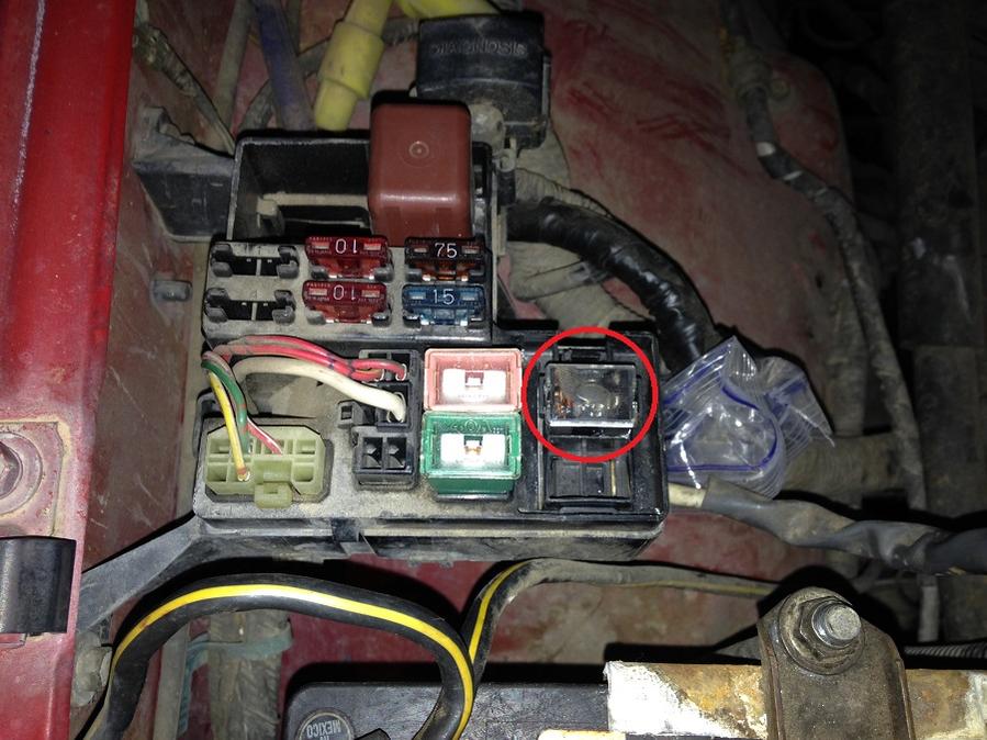

I finally got a chance to hook up the ammeter today and while checking the fuses power suddenly came back. She started up fine, went to grocery store and when I came out she was dead as nails. Went and jiddled/pushed down the fuse that seemed to cause power to come back, and sure enough power came right back.
Anyone know what the fuse circled in red is?

That is a 80amp fusible link if I recall correctly. You have to push it through the bottom to replace it. Id unbolt the fuse box and replace it. Quick 3 dollar fix at any oreillys. If its loose or broken you need to replace it. If thats whats causing the issues it would explain the problem as its the first fuse coming from the battery.
