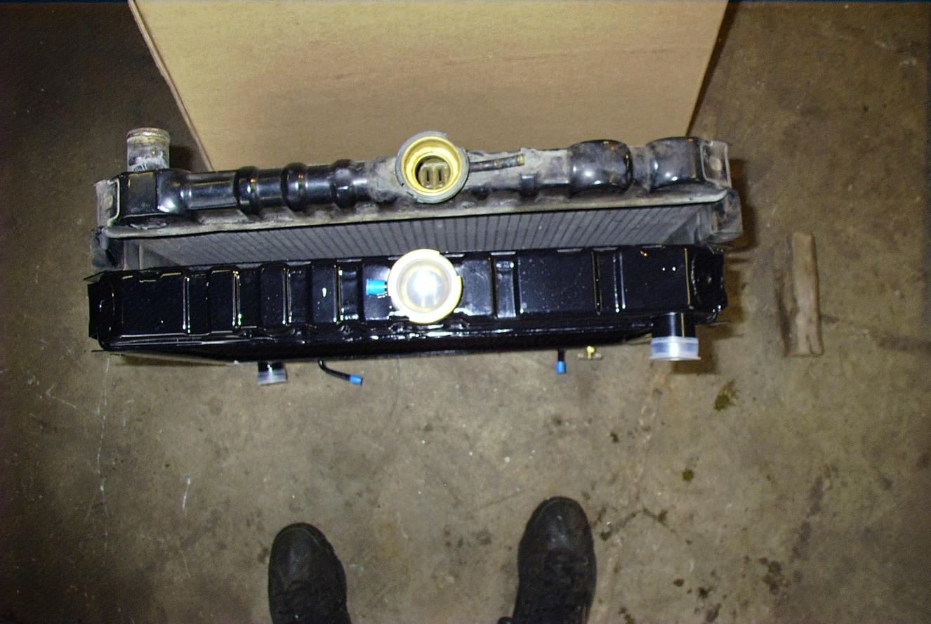

I'd get a Modine or TransPro replacement. And I'd get one for a 22RET, it has a thicker core.
Actually, it's what I did.
Stock 22R on top, TransPro/Go-Dan for a 22RET on the bottom.
All metal for $92 (10 yrs ago).
