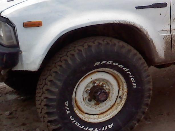

Hello all, still new to the forum but am slowly figuring this out... Yay!
Anyways, I've always loved the look of 1st gen pickup/4runner steel wheels and bought a set for cheap to try on my 3rd gen 4runner. When I test fitted the old style wheel on the front, I found I had a clearance issue with my caliper... Not much more than a few mm. My truck currently has stock 15" steel wheels on it already so I didn't expect any rubbing. Has anyone else tried a swap like this? Maybe with 2nd gen 4runner wheels on a 3rd gen or something like that? The possible solutions in my mind are: mild wheel spacers to offset the backspacing, or VERY slight grinding of the caliper.. Perhaps both.

Here's what the wheels I bought look like:

Thanks for the feedback. I test fitted a 1/4 inch wheel spacer I had laying around today and that solved the problem. Is 1/4 enough to cause issues?
