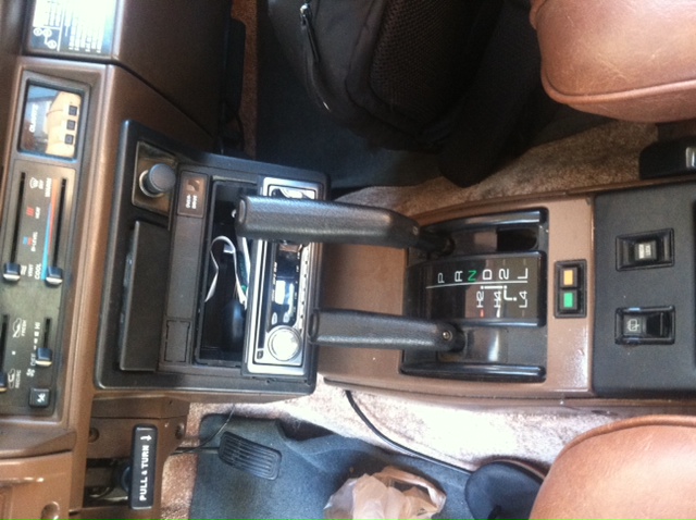

The "Power and Normal" switch with the green and yellow buttons behind the auto shifter. When i hit the far right button I see "power" and I get some power from the motor like it was in Overdrive. What does the left one do? "normal" I can have it clicked down and it wont do anything, or have both of them not clicked and nothing. Does it matter if "normal" is clicked down or not? "normal" doesnt light up on the dash.
What does the Overdrive button do on the shifter? same as "power" button?

For reference of my buttons

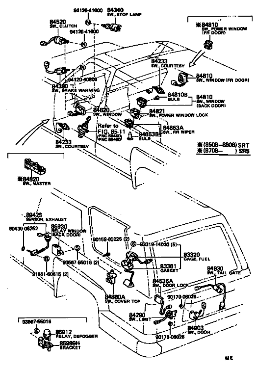

1st gen hard top safety switch
There is a safety switch for the hardtop. It is a plunger type that blocks the window from moving when the top is off.
there is a diagram form TOYO DIY part number84880-89101

The Power button changes the shift points in the ECT, making the truck rev higher before shifting. The Overdrive button lets the transmission go into overdrive, or not, depending.
They're useful for towing or climbing steep hills, to keep the RPMs high and in the power band. Driving around normally with the Power mode on and overdrive off will absolutely destroy your gas mileage, and gain you nothing.
Make sure you put ALL of the bolts back in your top. One of them on the driver's side (I think second from the front) is needed to make the circuit complete.
It's Toyota's dummy proof way of keeping you from rolling the window up when the top is off.
Just looked in the FSM it's actually the driver's side bolt second one from the REAR. If this bolt is missing or not screwed in all the way the rear window will not operate.

The switches all work, I'm just wondering what the "normal" switch does. I can have it un-clicked where both buttons are not pressed or 1 or the other.

the rear window switch is on the center console, just to the right of the window lock switch. its visible in the above pic.

I thought the window switch was on top of the radio area. If thats the switch, I'll just have to wire it. Here is a better picture.
oh weird. there isn't a switch down there. ive never seen a console layed out like that.
my 85 sr5 doesn't have the window lock, but my rear wiper, and rear window controls are on the console.
an ex gf had an 87 custom, and hers had the same rear controls as mine, PLUS she had the window lock. it was between the other 2 buttons.
if they put the rear window controls on the dash, ive never seen that before.
my 86 sr5 had a power antenna button, it was on the dash...
