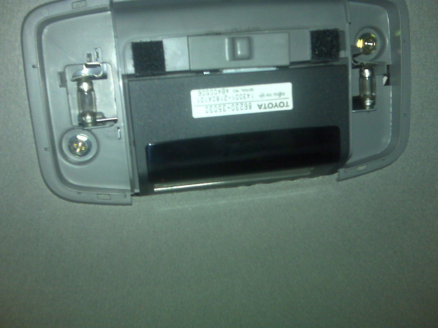

I just took a pic of my front dome light as well to show you:
Yup, you should be golden.
Your dome light is completely different from my 08, mine are both close to flush with the ceiling and only have one bulb. Post pics when you get yours done!

I think he has the rear seat audio or RSES.
Thanks Josh, good to know. I pulled the "3175" off Sylvania's site as confirmation.
Yes I do have rear seat audio (that never gets used).
Anyone know what LED bulb(s) I would need then?
