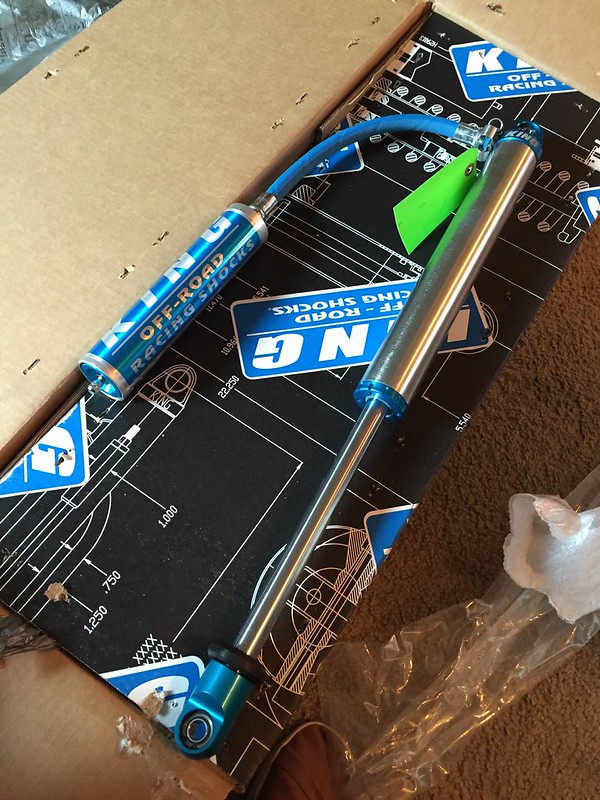

By next thursday I'll be able to tell you. These bad boys just came in. I'm running the 5100s from the SS1.2 kit currently

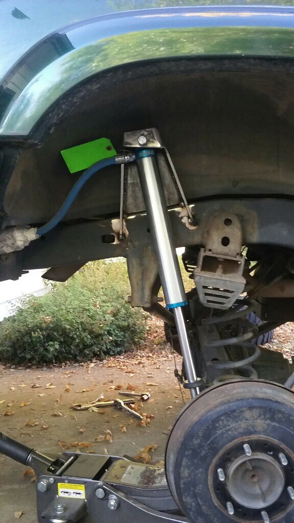

I've been slacking on the updates. Tried to wait till this weekend after I get a wheeling trip in to post pictures and my final thoughts. But since you asked here is a pic of the fabrication process and some preliminary opinions.
Honestly its a completely different truck. The custom valving job that King & Filthy Motorsports did makes the truck ride incredibly well. Its so planted and I really have to hit a pretty big bump before I notice it. I always had issues with the SS1.2 bilsteins jumping around when I hit bumps at highway speeds and that is completely gone now. The body roll hitting bumps while cornering is gone too, the truck stays flat no matter how hard I roll into a corner.

Surely there is a way to get a set of those upper mounts I hope,lmk. That looks really good. Did you ditch the rear sway now too? Wheel specs that you aren't rubbing with?
Edit..Did you change the lower mounts? Interested to read about your set up.
Are you having any rubbing issues with the shock tower being so high up in the wheel well? I'm making my outboard shock towers tomorrow and I'm running 1.25" spacers
Rear sway bar is still on. With the 9 wraps there is no way I would take it off haha. That's part of the reason why the shocks are mounted behind the axle. The stock lower mount will be hacked off pretty soon so I'll have quite more clearance. Performance is killer, the truck has never been smoother offroad.
I'm torn at the moment between adjusting the lower mounts to give me a bit more uptravel and dropping the bumps and keeping the uptravel where its at. I do have plans for 35s and my 33s rubbed the fender well when I maxed the rear out with the bumps where they are right now. So I kinda needed to lower the bumps a bit anyway. Not sure what I'm going to do yet so feel free to throw out opinions. Part of it will probably depend on how the travel of the shocks works out. We were on a time frame wheeling this weekend so I didn't to too much testing and measuring.

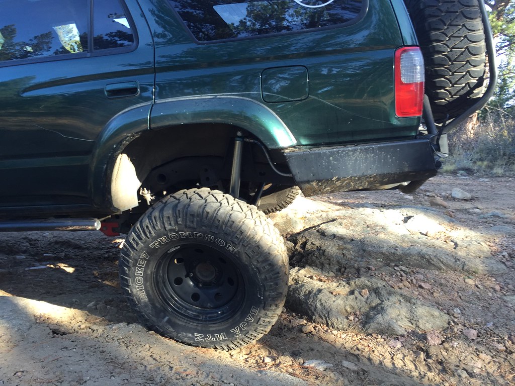

Not full droop but a good picture to show the shock placement

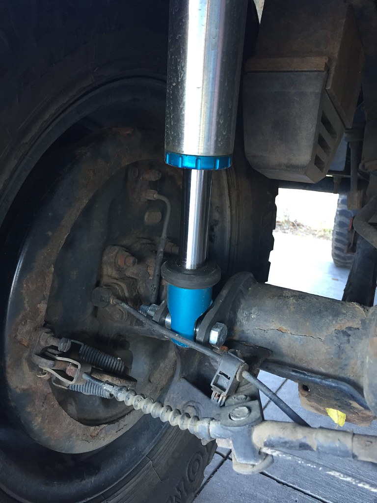

Rear lower mounts. We were shooting for about 4.5 up and 5.5 down and itll be right around there once I swap to OME 861s. Theres a ton of junk in the truck at the moment so 9 wraps have sagged and this picture shows more like a 3.75 up and 6.25 down but you get the idea
Untitled by Tyler Carvell, on Flickr

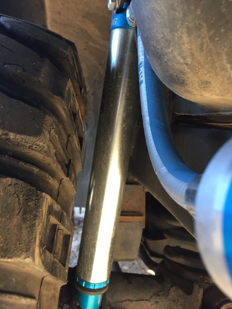

I'm in the process of outboarding my shocks right now and I had to lower my bump stops an inch to keep my tire from rubbing the shocks at full compression. That's with 1.25" wheel spacers. How close are you to rubbing your shock body on the frame at full rebound? I'm going to end up cutting into the frame and plating the area to get shock clearence at full rebound. I'm running 12" shocks though
I know I dont hit the frame because i pulled the back tire a couple times wheeling and I dont have any marks on the shock or frame, but I'm not sure how close it is. I'll try to grab a picture. 12s will make it a bit harder for sure, but from looking at mine there should be enough room for them

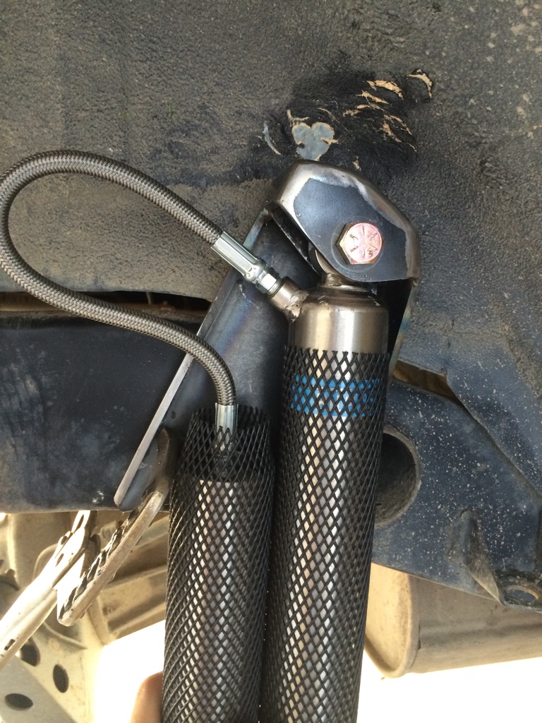

Here is where I'm at right now. The mount is almost done but I still gotta notch the frame to get it to clear. I'm also going to tuck the mount about 1/4" into the frame to help clear tires. After cycling the suspension I realized how little room there actually is in there. If I were to do it again I would just keep the mounts inside the frame and just raise the mounts into the cab
Looks good man. with a 12" body I could see how pitching them up into the body would be good. But the additional damping from running them outside the frame is pretty helpful
