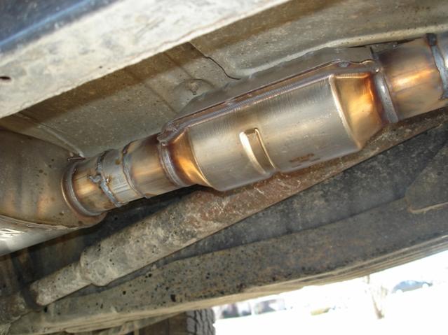

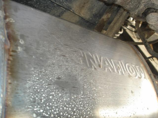

I have a 2.5 because thats what the muffler shop told me I had. I just replaced my cat and muffler last week.

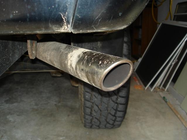

Stlfan, any chance you could also post a picture from the pipe exiting the muffler? Just curious, it looks like with 2.5" the used the muffler and cat as the OD as opposed to the ID. Pretty good idea actually.
Like I said in another thread, the 2.5 will slide right over the stock pipes and weld on just fine. I'm at work now, but I can post pics later. I think there's one in my build thread also.

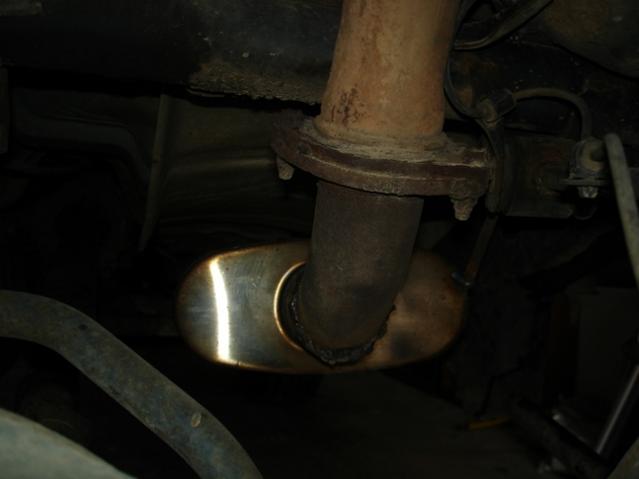

Here you go. I hope this helps.
