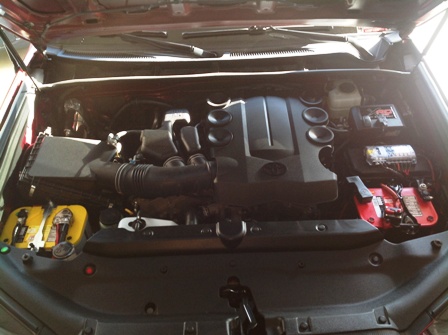

I like the setup and there is little I would change.
-The Optima batteries are a great match and fit - no complaints or powering issues. I wanted to ensure I had enough juice to run my XRC10 winch without tasking out main power draw.
-The ABR gear is solid, well built, and easy to install (instructions are well laid out and easy to follow).
-The tray is heavy duty and is worth the cost (IMHO) - especially compared to the plastic tray the main battery sits on. The tray drops in to place and bolts down with supplied hardware to existing threaded holes. The instruction and gear for power reservoir relocate matches and is easy to do.
-The Sidewinder AUX battery switch is a no brainer. Easy to mount, hookup, and it does the rest (monitors voltage and switches battery power as necessary).
-The battery monitor is a nice feature and provides me with voltage on both batteries and option to switch over to AUX in case of emergency power is needed, etc.
-I did run new power cables to winch since I had to relocate winch control box. I replaced 4 gauge with 2 gauge wiring.
-I ran 00 gauge wire from main to aux battery for power. A little overkill - If I had to do over I would run 0 gauge cable. The 0 gauge, easy to work with and ring connectors are easy to come by, etc. I may repull 0 gauge to replace 00 gauge.

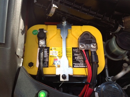

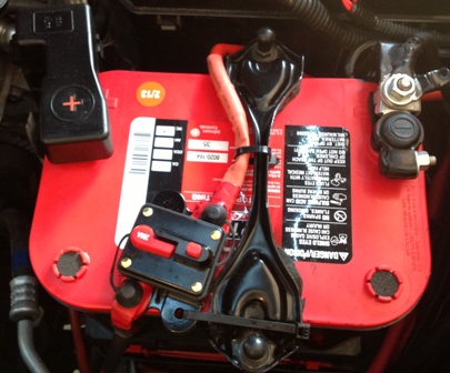

-I did replace the "L-Shaped" positive battery terminal on the AUX battery with an X-Scorpion battery terminal. The wires I running to L-shpae were hard to work in confined space, and I was worried about rubbing and an eventual short. The L-Shape was also hard to work with where the positive post is located on the Optima Yellow battery. The X Scorpion is a perfect fit and has multiple wire mounting locations (for different gauges). There is also a LED voltage readout, (still no sure if I am going to hookup). Here is a vid I found on YouTube of the X-Scorpion terminal: X Scorpion Battery Terminal
-I am in the process of the clean up and organization (tie wraps, wire loom, etc.). Would have been nice to run all wire first, wrap, tie, label, etc. This would have made the job easier and faster to accomplish. Of course, this is a wish as things change during install as I added, changed, and moved components as the install went along.
Yellow Top w/ABR neg term and XScorpion positive term and ABR Sidewinder aux battery tray
Red Top w/ABR L-Shaped positive term (100 amp fused) and ABR neg term.
I have switch breaker temp mounted w. tie wraps until I can find a more perm location or I might velcro down.

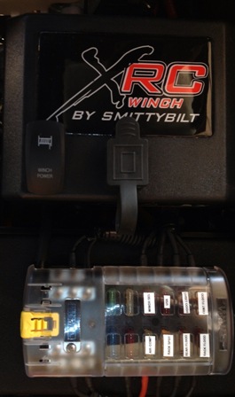

Pic of Sea aux fuse box and XRC10 winch control w/ OTRATTW switch

The bay
