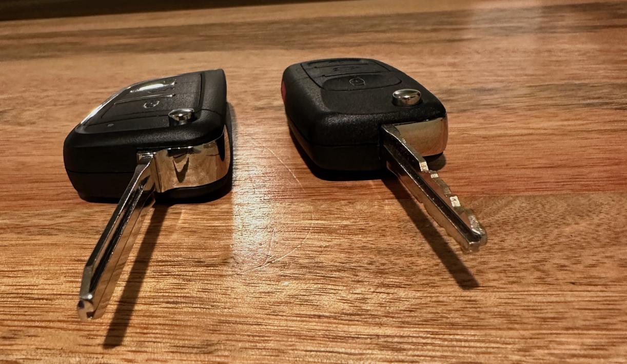

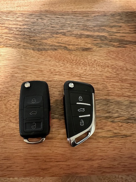

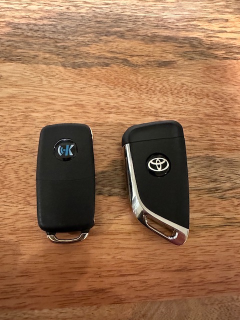

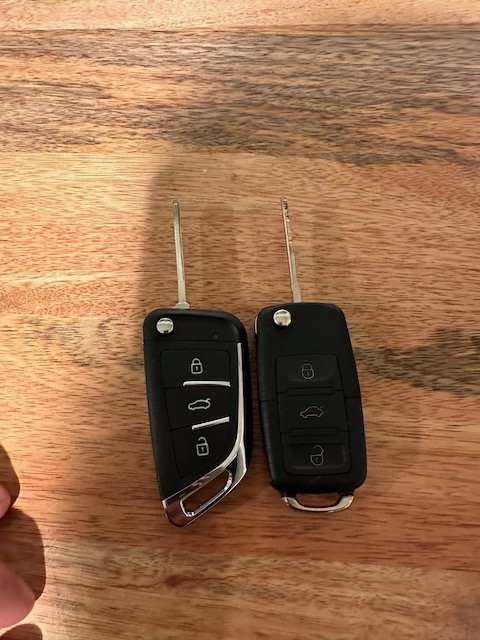

I bought it and the VW one. The X7 style is actually a little bigger, but not by much, and weighs 2.6oz vs 1.6oz for the VW. It definitely feels more substantial. The X7 is about the same thickness on the narrow side and then slightly thicker on the other side. It does seem like it would not ever break off the key chain, which is why I bought one of these in the first place, as I kept breaking the plastic fobs. There is also no panic button but some may find that's a benefit.
To be honest though, I'm not sure which one I'm going to use yet. I do like the idea of the smallest possible, which would be the VW.
