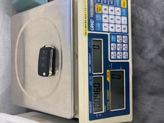

How's the build quality on it? Does it feel light and flimsy or does it have some heft to it?

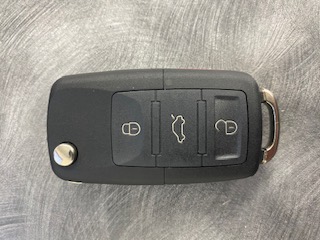

Any chance you could post a pic of the front. I ask because, based the eBay pictures, it looked slightly different than the other ones posted in this thread.
Doesn't feel cheap and weighs in about 1.5oz.

Thank you. So looks like the only difference is the logo on the back.
Looks to be the same one from the original post. However, is different from what is posted on their ebay. The photo on ebay looks to be two piece, top and botton with the LED light on the top right. The actual product looks to be 4 pieces with the LED light right next to the middle button.
Right. That's exactly why I was curious what the front looked like. I'm actually glad that it seems to be the same as the other ones.
