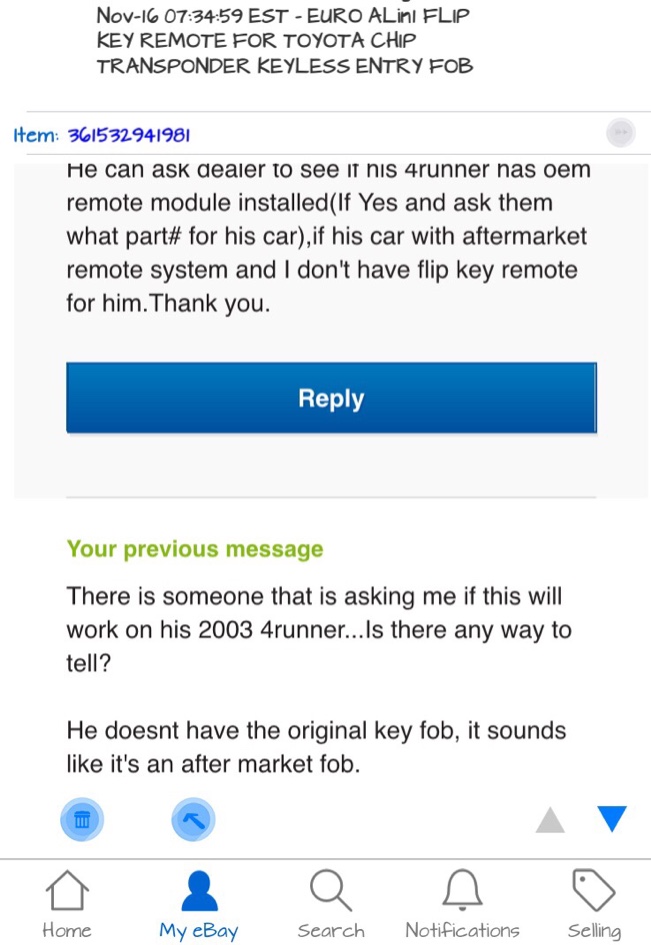

I assume it's an aftermarket one. It's all I have. Tempted to buy this ebay fob just to try it
Just wait, don't buy it yet. Ill talk to the seller and see if he has any more info. If it says 05'+ it's prob the case.
Leave it with me for the afternoon.
Instead of me relaying....
I don't think I'd spend that money until you found out for sure....
I'd get all the info from the dealer in regards to wanting to get a new key from them.....
And then maybe tell them it's too expensive for you right now.
Hope this helps
