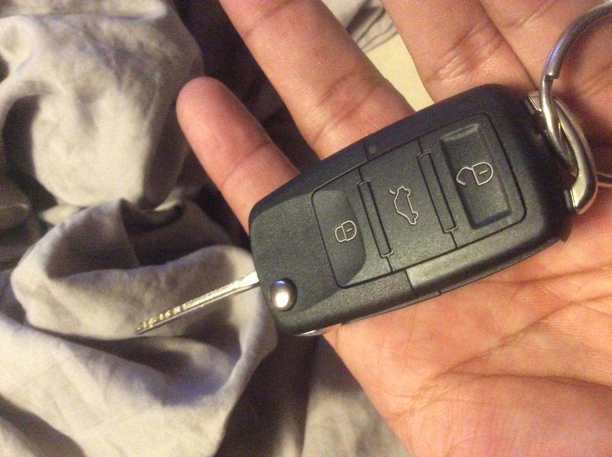

Program and cut with no problems
just got mine in the mail. Only mine has a nissan logo on it instead of a toyota logo. :ban:
Oh man. Thats wack! Contact the seller. He will make it right for you. Also, maybe a dumb question....The listing you purchased from, did it say Nissan?

I set mine up today with a few issues but ended up a complete success. Programming the fob portion went smooth per the instructions included. Then I went to get the key cut (closest town is ~an hour away). ACE hardware wouldn't do it but referred me to an old school hardware store. Cutting one side of the blank went fine but when he went to cut the other side, the folded fob portion was jamming up the works. After some fiddling with it and looking for where the battery was installed, the fob portion pulled apart and was small enough to cut w/o interference. Once cut, the fob snapped back together and everything was good to go. Programming with the key in/out, door open/close, etc. method worked like a charm.
