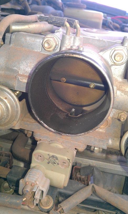

I have a 99 4runner limited. it has the v6, auto trans.
when i bought it it had several problems, I've been slowly addressing them but one of my things is that my throttle body has 2 little black nipped on top of it, and against the passenger firewall thing under the wind shield there are 2 metal hoses that are not connected to anything or even capped off.
my 4runner runs and drives my question is
what are these hoses for?
should i hook them up?
and if i should what hose goes to what nipple..
Nipples on throttle body intended to go to the EGR valve, which is not found on OBDII 3.4L V6 engines, i.e. all 3G 4Runners, including your '99. They were used on OBDI T100's, for example. So just leave them capped off, although you can spray cleaner and compressed air in there when you clean the TB. ('99 4Runner FSM says to do that.)

the black caps on the top of the TB
