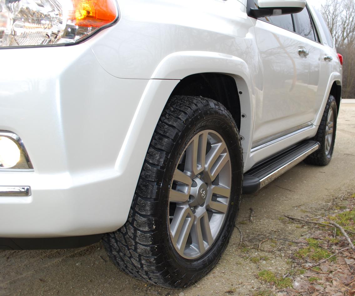

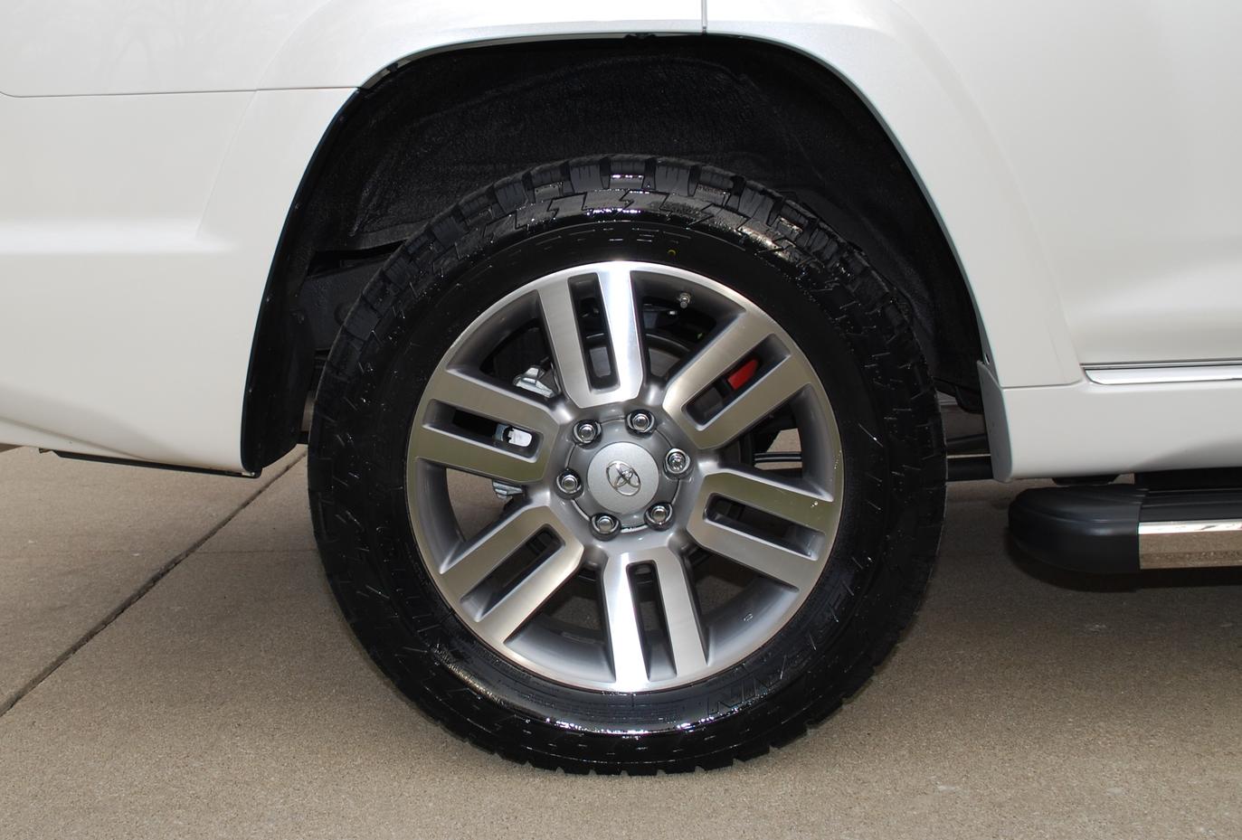

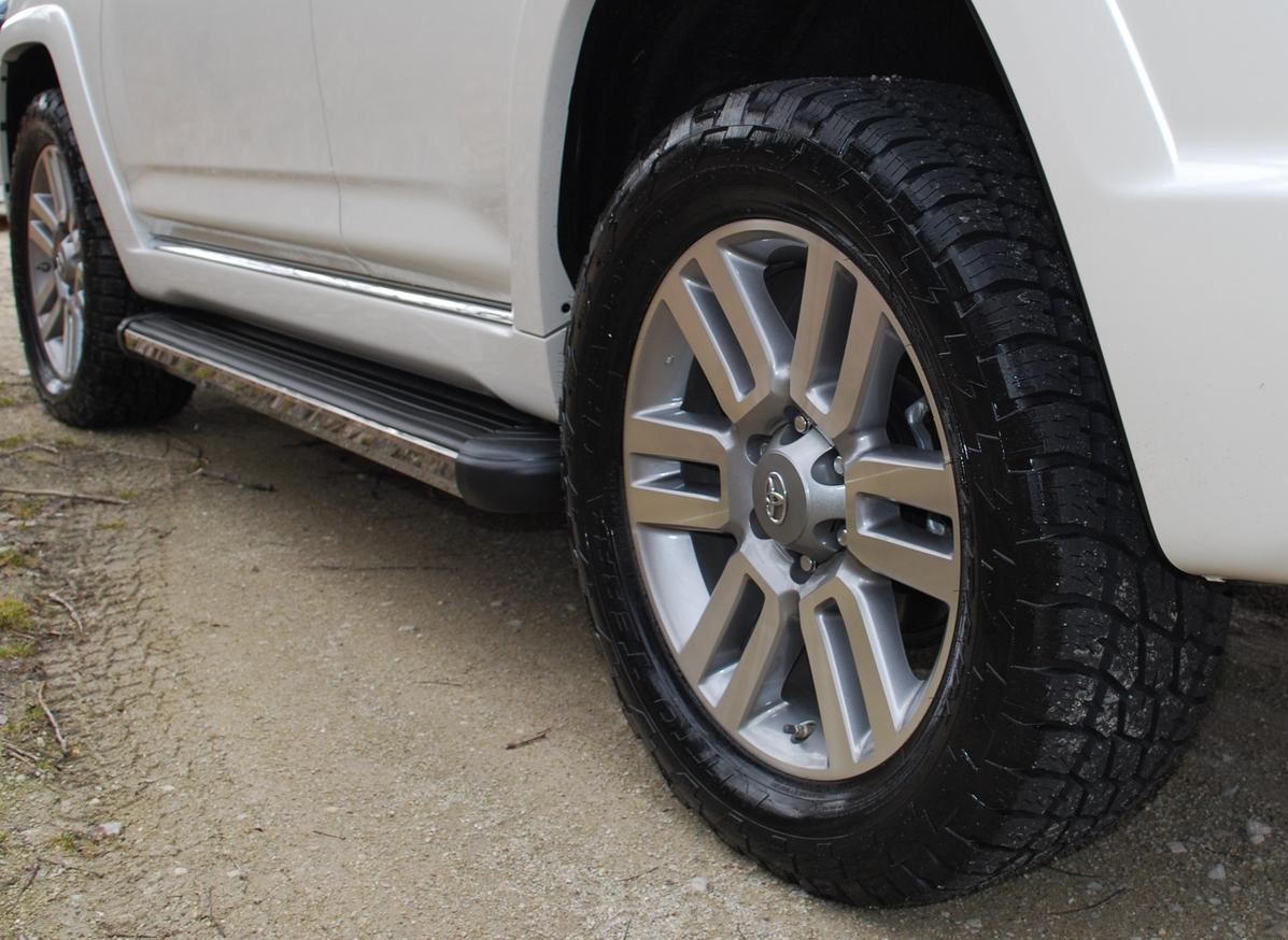

I went 275/55/20 recomended by discount tire. They said that is fine and that 275/60/20 would be too large of a tire. No problems so far and not expecting any in the future.
Thanks for the pic's!! I'm sold on some 275/55's! They totally change the look of the truck. What Toyota was thinking when they put such a skinny tire on a big truck is beyond me... :shrug:
