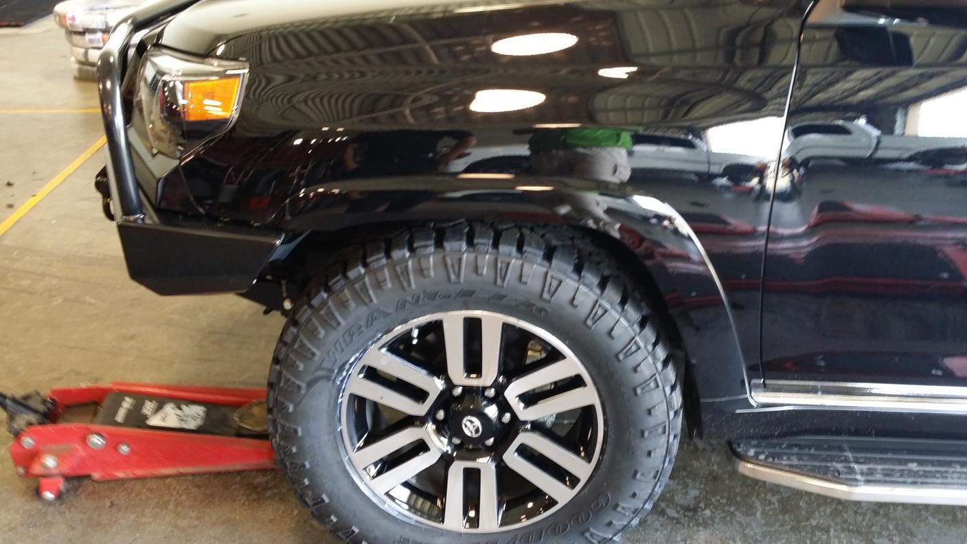

20 inch wheels on LIMITED
I'm guessing the 3" lift is an absolute requirement to get 275/65R20's to fit.. that's a lot of tire to try to fit with just the spacers.
Yes....otherwise you would get this......

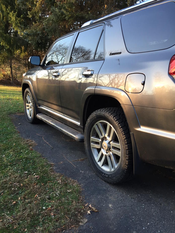

Got these installed yesterday. Let's see how they work out. If you don't hear from me ever again then it's probably a good bet that the 275/55/R20s were not a good idea. :lookout:
Those look great. Just hope their safe (for your sake and others).

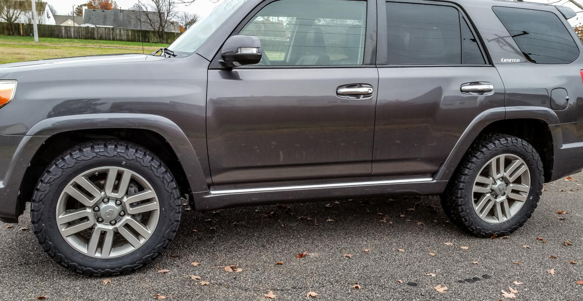

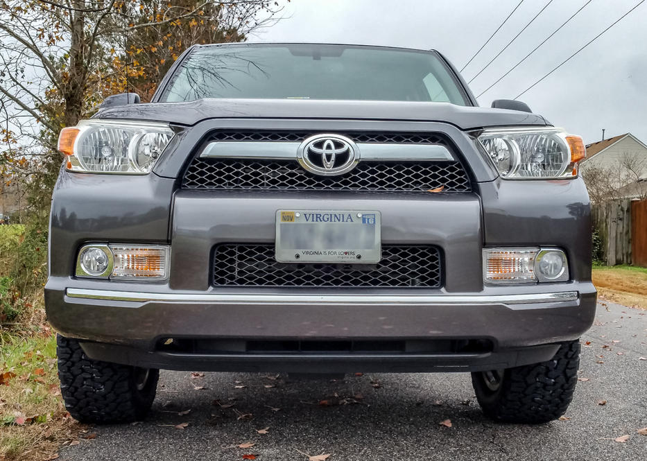

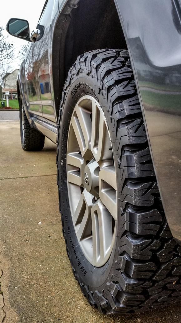

I got a pretty good deal from Discount Tire on Black Friday for some 275/55/20 BFG A/T KO2s and finally got them installed today. So far there is no noticeable rubbing on stock suspension. The ride back to my house was not that loud and not that bumpy compared to the stock tires. I have yet to drive at highways speeds, but will try it this weekend. Overall I'm satisfied with them and they look great.
When I approached Discount Tire, they wouldn't even sell them to me because they are not recommended for the 20x7" rim.
We don't have DD here in VA, so I ordered from them via online and had them installed at a local tire shop. Yours look great on the TE wheels.
Thanks, I like yours too and its good to see the comparison. I actually bought the exact same tire size you did when 4 Wheel Parts had their sale a few months ago. I liked the stock 20" rims so much and I wanted to save money. It was a really hard decision to move to the 17's and I spent many hours going back and forth. I eventually returned the 275/55/20s and went the 17" route since I was upgrading the suspension and wanted the taller sidewalls for more aggressive offroad stuff.
