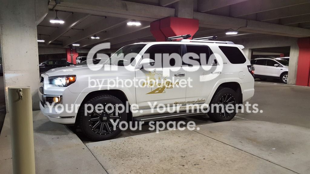

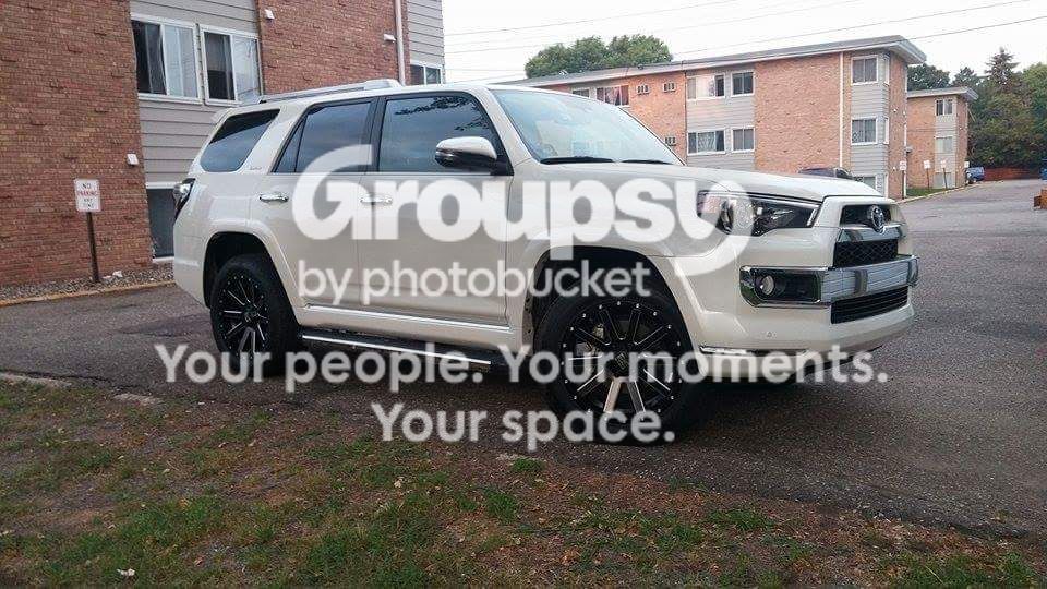

Some pics coming in few minutes, for any other members curious on the look (definitely lessens the "pizza cutter" look (stole phrase from somebody here ;) of the skinny 7" rims) ...
