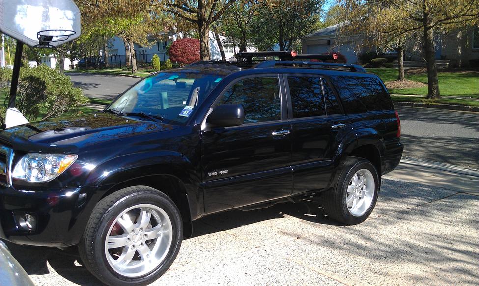

I loved those rims on the 4runner, but with winter approaching I swapped them out for GY duratracs 265/70/17 on my stock rims with 1.25in,1.5in spacers. IF I knew I would like the latter more I would have not purchased the rims and gone straight to the lift and off road look instead of the sweet 20's. Just giving you some food for thought since I was in the some thought process less than 9 months ago. Either way I'm sure you will like your choice and get hooked by the mod bug :lmao:

Ronsta, thanks, I believe they are bbs(20x9.5) off an xsp tundra or fj,.. I got them off a member in Virginia back in May, I wanted them that bad that I drove about 8 hours to get them!
Wow they look great! what kind of offset ? same as stock wheels or ... ?
I don't know the offset, but they aren't the same offset as stock. In that picture, they were mounted with no wheel spacers and they came out flush with the edge of the fenders, they looked perfect!!
