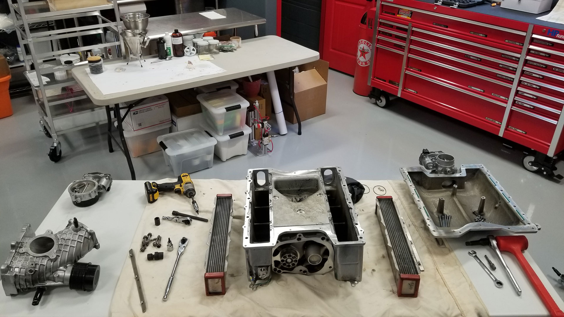

Here was this weekend's project - prepping a Hellcat Redeye supercharger for bigger and better things :)
