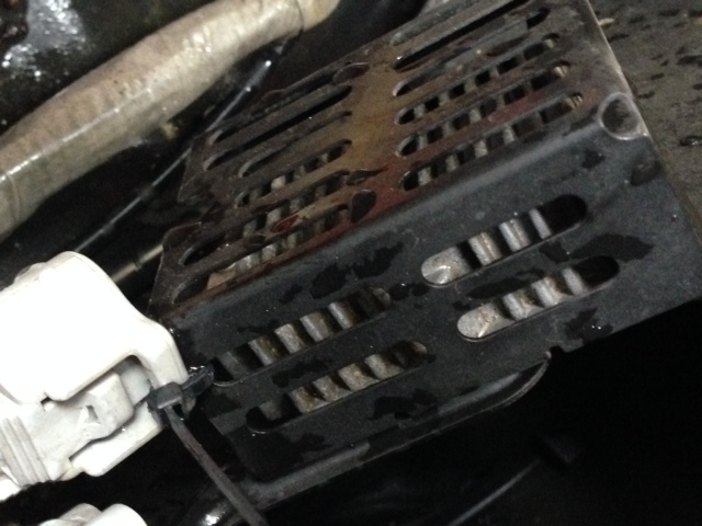

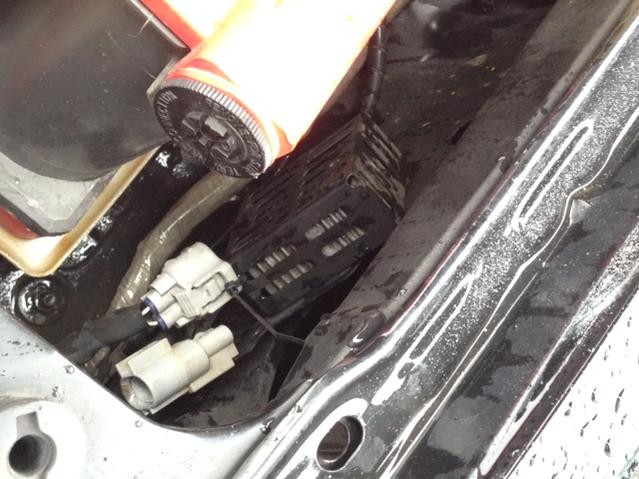

This thing. Do you need the DRL's for inspection there? I may be able to dig one up. I'll let you know if you do, in-fact need one for inspection.
so besides the plug you unplugged, does that box go into anywhere else? i dont need it for inspection here, i just need them to flick on with the switch lol. thanks tho.
Nope. It is simply a resistor with a heat sink to dissipate the heat from knocking the voltage down for the DRL's. If you look at the plug, it only has two wires; one in, one out.
