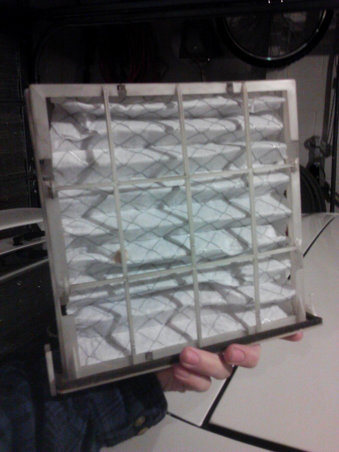

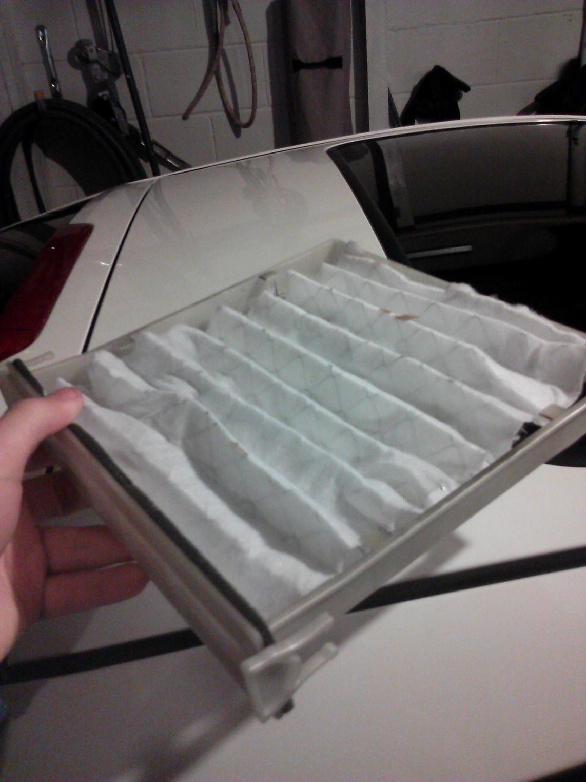

Finally made a cabin air filter today. The weird thing is that in the Celica, there is a tray for one, no filter from the factory, and nothing in the owner's manual about one. In my mom's 2008 Scion xD, there is no tray, but there is a thing in the owner's manual for one in South American models.

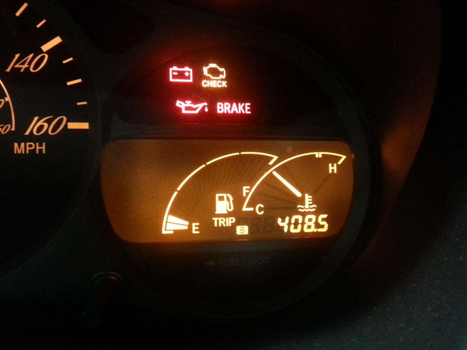

We also got great gas mileage- 32
Also, there has been a dead spot in the rev range around 5-6,000 RPMs. We think it's due to the thermostat sticking and not letting the engine get warm enough. Our entire drive home (3-4 hrs) was below normal operating temperature.

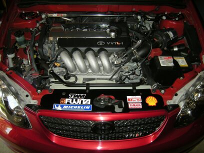

The last generation Celicas are becoming more and more rare, especially a GT-S in decent shape. So I didn't read through this entire thread, did see that you had the lift bolts replaced which is good. Toyota later resolved this issue with a redesigned lift bolt material. Also read you are running Redline MT 90 in trans. Have been using MT 90 for about ten years, your C 60 transmission will retain longevity and operate smoother with this oil.
I see you have a aftermarket short ram type intake, the design and operation of the 2-zz is is partial to a short ram vs a longer tube intake "type cold air" that has tubing running to the front inner fender. This engine also responds very well to a larger, low restriction exhaust . I think 2 1/2" is recommended , I'm running 2 1/4" from the cat back with a modified TRD muffler and a custom made center pipe with resonator, all stainless .
So what do you think of the 2-zz GE motor ? It's quite a powerhouse of a motor, for a 1.8L it screams pretty hard.
Here's a pic of mine. 2006 Corolla X-RS
