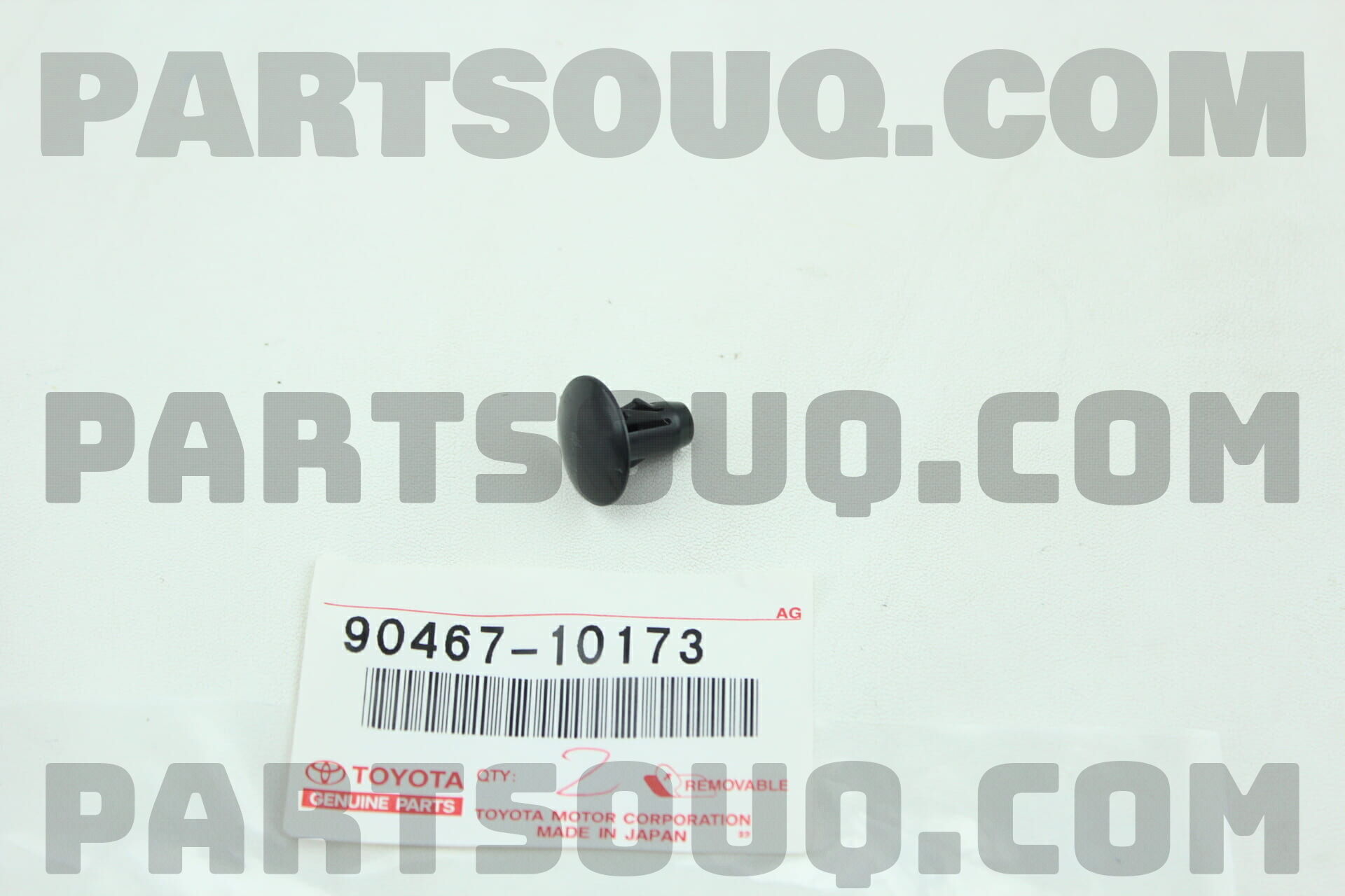

I have given up on the splash shields little black clips
I will not be held hostage to them NOMORE!
the fender aprons are perfect for M5 nut certs so I certed them

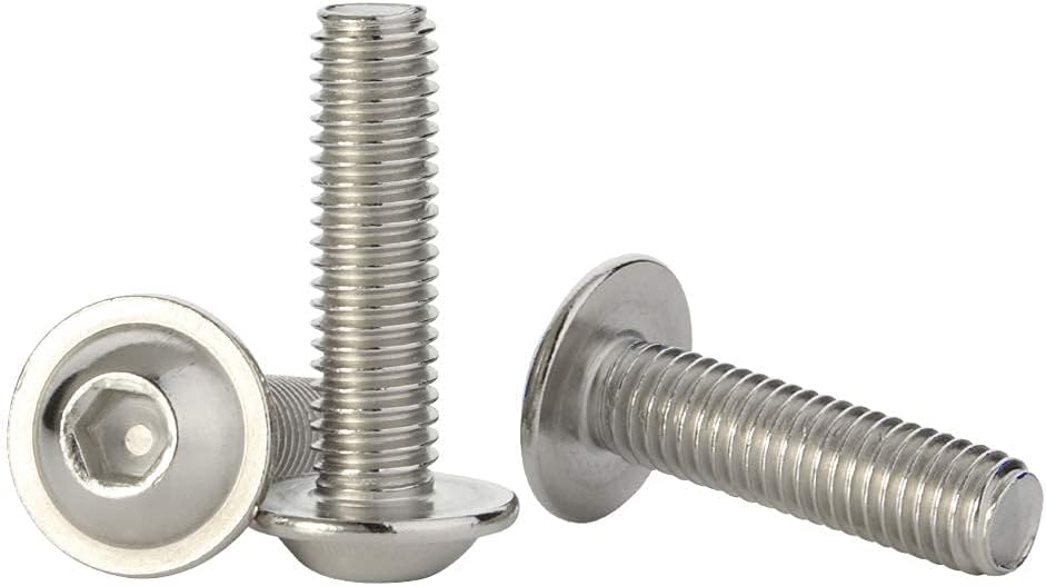

I did not have any m5 Flanged Button Head Socket Cap Screws on hand but did have some m5 machine head screws. I ordered some of these and once they come I will swap out the machine screws. who am I kidding I will get the new box of screws and they will sit on my dresser for months and the next time we have visitors my wife will freak out and hide them in the name of cleaning up. Or maybe this time it will be different but probably not.
Amazon.com: M5-0.8 x 12mm Flanged Button Head Socket Cap Screw Bolts, 304 Stainless Steel 18-8, Allen Socket Drive, Bright Finish, Fully Machine Threaded, Pack of 25 : Industrial & Scientific
but until then it works just fine and the splash shields on the drivers side has never been so beefy and secure.

agree I have the same allen heads in M6 and they match the size of the plastic toyota clips much better. I just did not have them in M5, machine screws are way to small.

Ordered the M5 on sunday and had it today, wow amazon. I was a bit surprised how much smaller the M5 are but after installing them they are fine. that plastic splash guard is totally solid now, no more floppy.
M6 would be the best but you would have to drill out the sheet metal and then make sure you do something to protect the hole and since mine are still in good shape I don't want to drill them out and destroy the toyota zink+paint protection that still exists.
