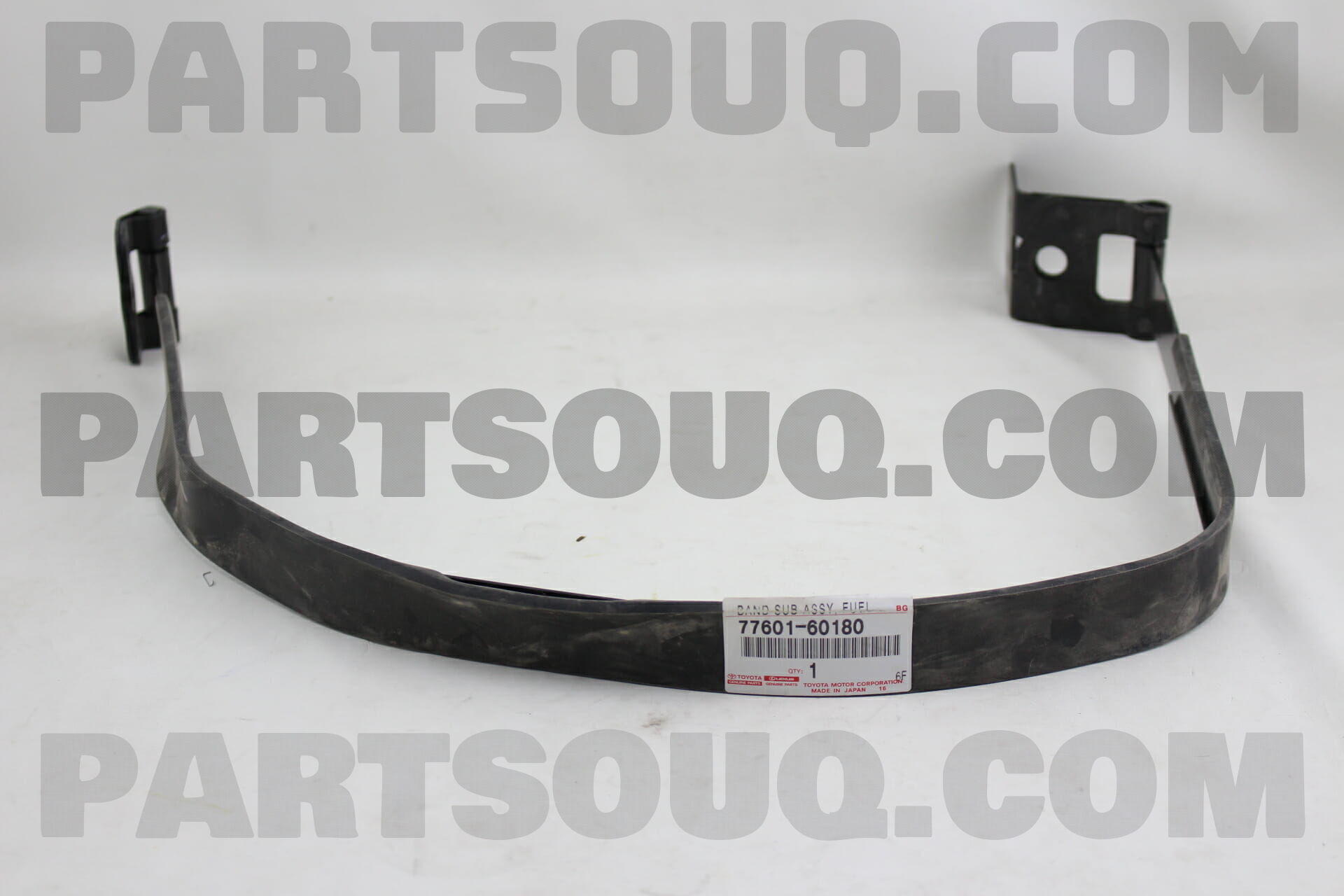

so the 96 Prado has a nice looking fuel setup IMO. if your goal is to move the tank aft on your boat.
Please Wait... | Cloudflare
if you go looking @ the picts
7760160180
they use a pin/hinge hanger on both ends. I actually looked into this setup and cost was kind of crazy getting it all in the US right now. I might as well build my own custom tank right? well...
this is a shot from under the prado how it connects, I suspect it just hooks on where the 4runner stock bumper hooks up? I wish I could find some more shots of how it connects in the front?
