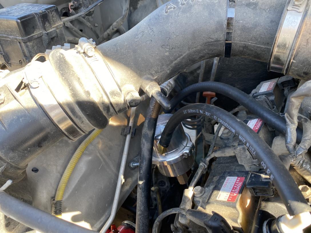

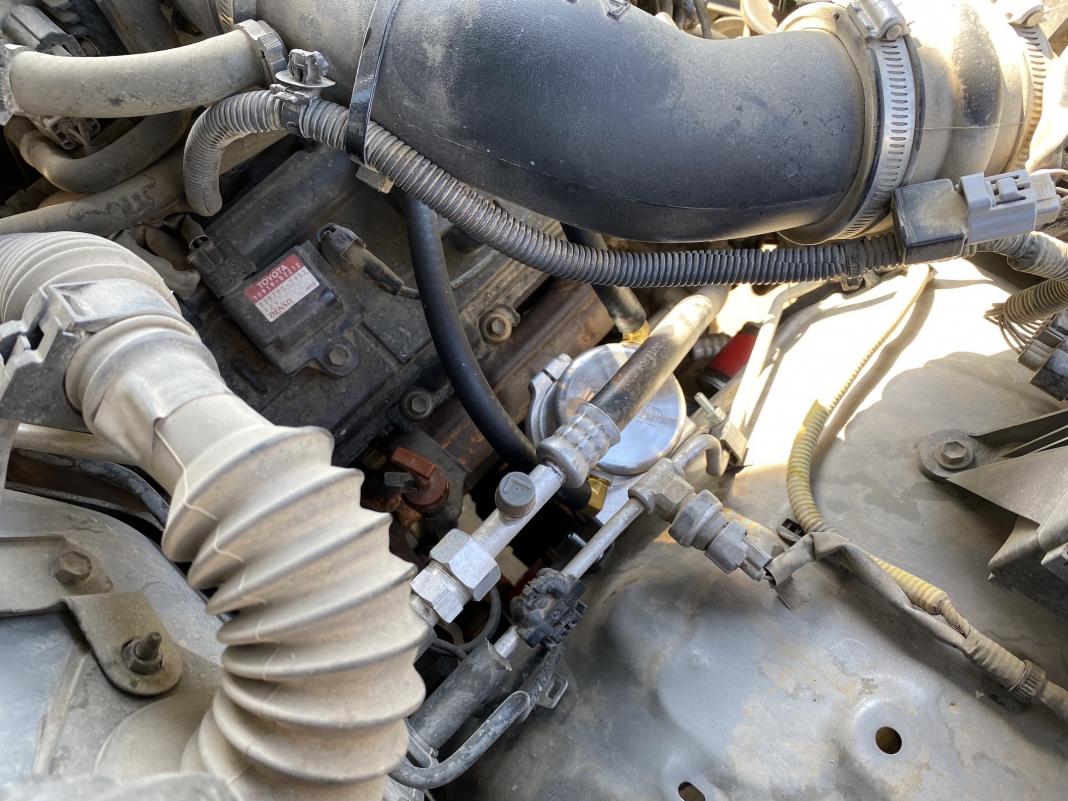

I picked up this catch can a while back and finally got around to finding a spot for it. not much room left in my engine bay so I had to get creative with my bracket skills.

Do yourself a favor and get some stainless worm drive clamps for each end of the lines. They will leak with time, speaking from experience.

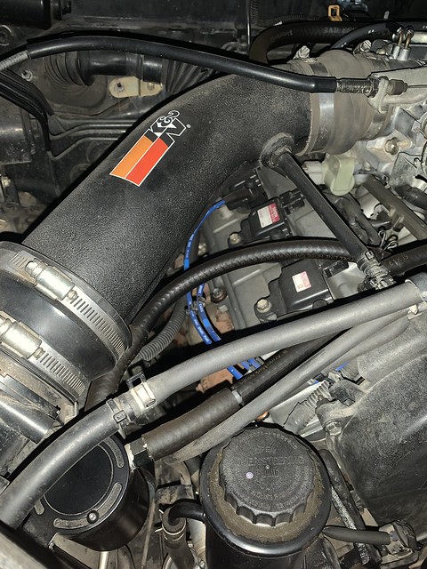

I wonder how many people run catch cans on these. Here's how I mounted mine.
so your running 2 cans one from each head. It was my understanding that one side is considered the breather (in) side and one is the outlet (PCV)
so I guess my question is would the can on the breather side be upstream of vapors?
I have been meaning to hook up my vac gauge to verify pressures from either side just because I was curious about it.
I have never really messed with the vac/pcv system as long as it was all working so I don't really know but it seems like 1 can is enough?
edit: I would have mounted it up like you did but I still have the stock intake with the resonators. maybe air raid in the future.
Nice work with the bracket.
I hadn't see anyone else with a catch can till yours. Mine is almost in the same location. I just attached it to the side of the airbox.
The single can does work pretty well. It certainly collects a lot of vapors - mostly water with a little bit of nasty goo mixed in.
I've had to empty mine about every 2,000 miles to keep it from overflowing.

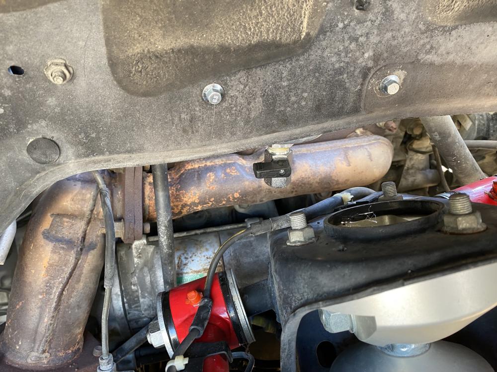

The easiest way to pull this off is to remove the splash shield so you can access the starter thru this area. Some of my clips are probably 20+ years old now so they broke. I seem to break these clips a lot?
<a href="https://imgur.com/elHELKk"><img src="https://i.imgur.com/elHELKkl.jpg" title="source: imgur.com" /></a>
Now that the story is long I decided to try my hand at a clip design
<a href="https://imgur.com/7uaM5Gh"><img src="https://i.imgur.com/7uaM5Ghl.png" title="source: imgur.com" /></a>
I don't know a lot about 3D printing but I'm learning and this is just a PLA batch. I would guess they should be ok for a while but I will need to look into maybe ABS.
<a href="https://imgur.com/pZ3Xkt2"><img src="https://i.imgur.com/pZ3Xkt2l.jpg" title="source: imgur.com" /></a>
They work perfect on the sheet metal portion but not so great on the frame connections. so I need to maybe work on my design.
<a href="https://imgur.com/SPd1Xm9"><img src="https://i.imgur.com/SPd1Xm9l.jpg" title="source: imgur.com" /></a>
they bust off when you try to push them into the frame holes
<a href="https://imgur.com/xxVBDE3"><img src="https://i.imgur.com/xxVBDE3l.jpg" title="source: imgur.com" /></a>
the OEM ones are deceptively complicated from a CAD design perspective. I will keep @ it and see if I can perfect my design.
Cheers.
here is the STL for this design.

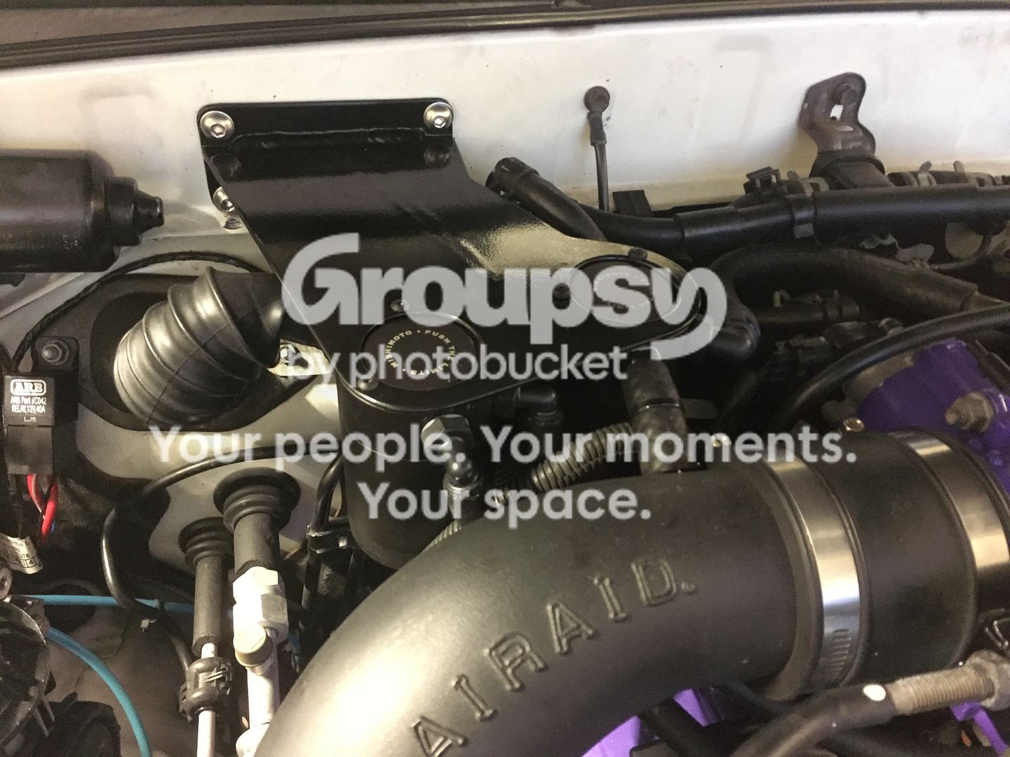

nice bracketry btw, - recently installed my Moroso Air/oil separator/Catch can and mounted it to the fender with easy access to the drain valve.
