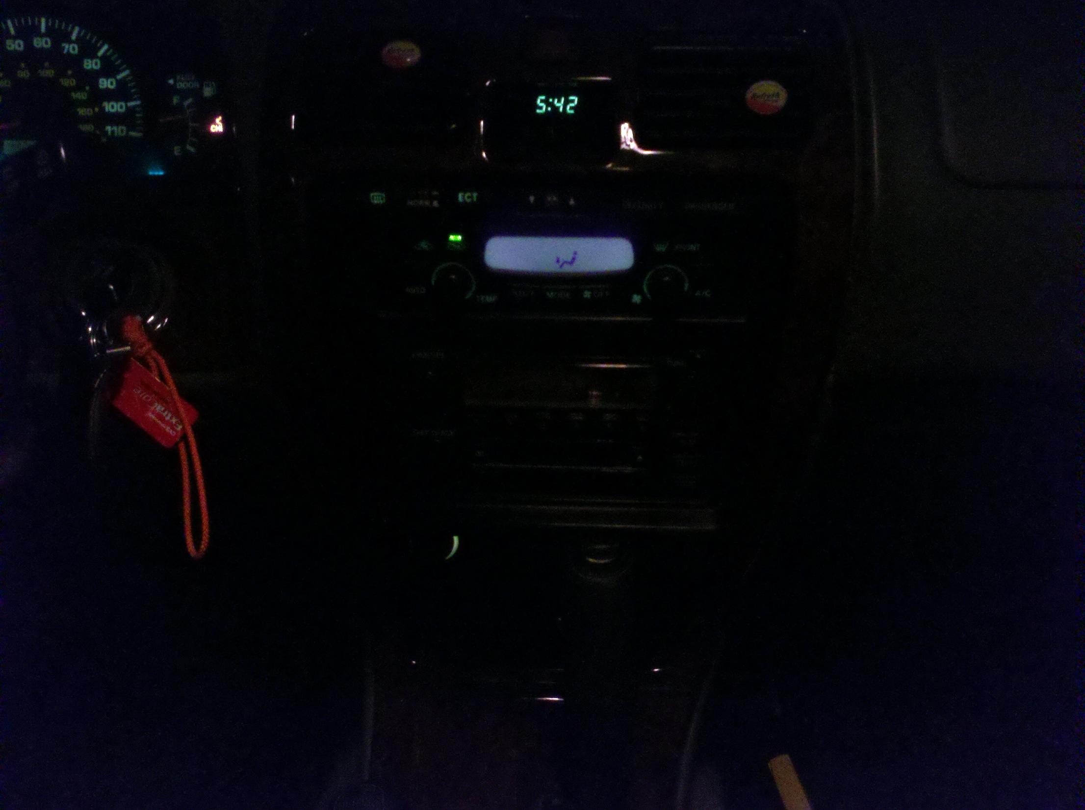

Yeahh the radio works, it plays fine it just doesnt light up which has gotten annoying. 2011-12-28_17-41-15_181.jpg

Check the ACC fuse in the dash and the power outlet fuse in the engine bay fuse box. Use a multimeter, not your eyes.
