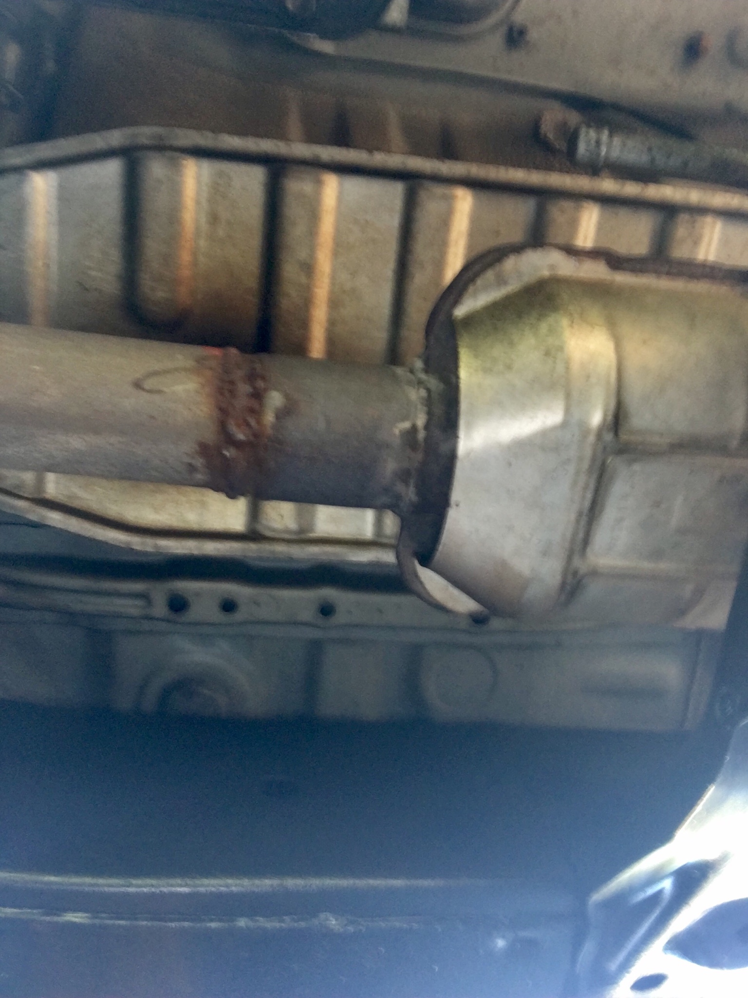

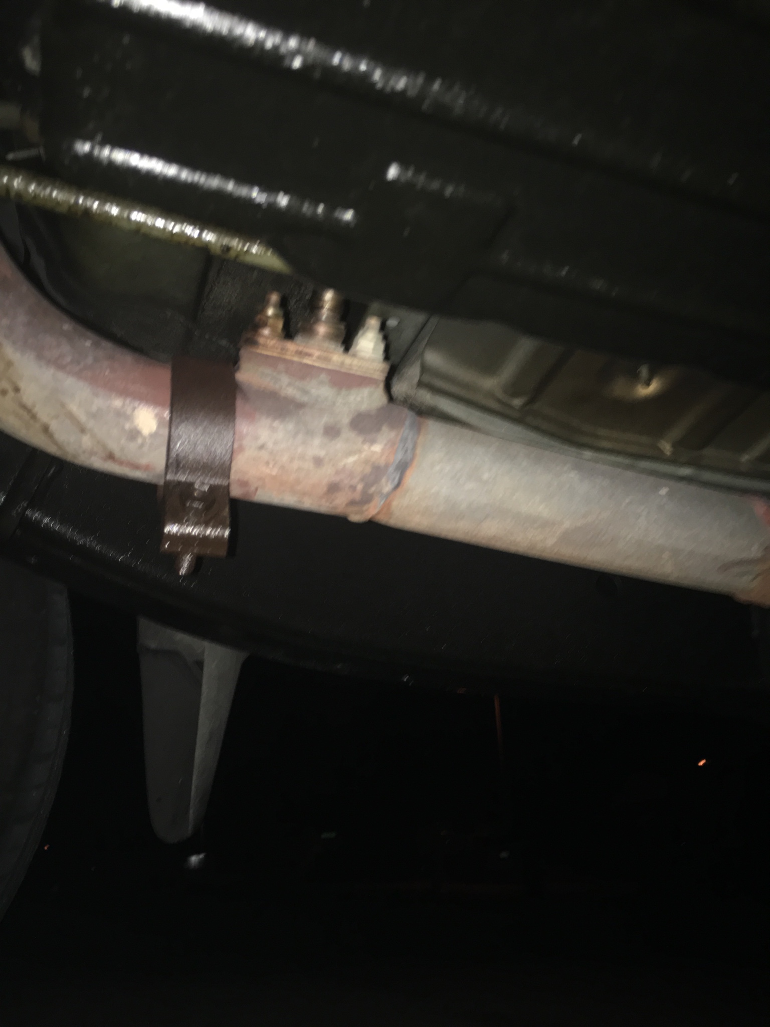

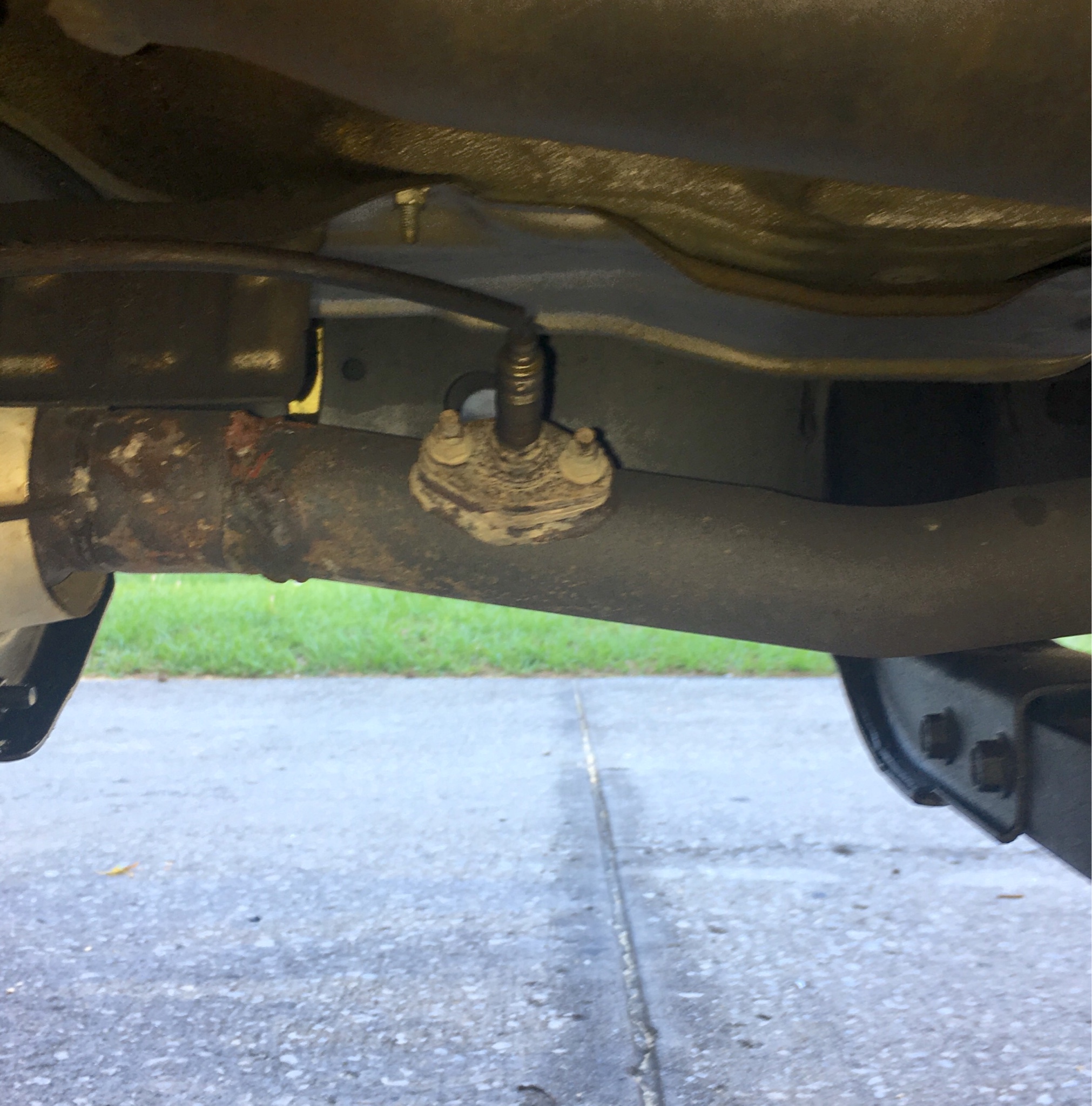

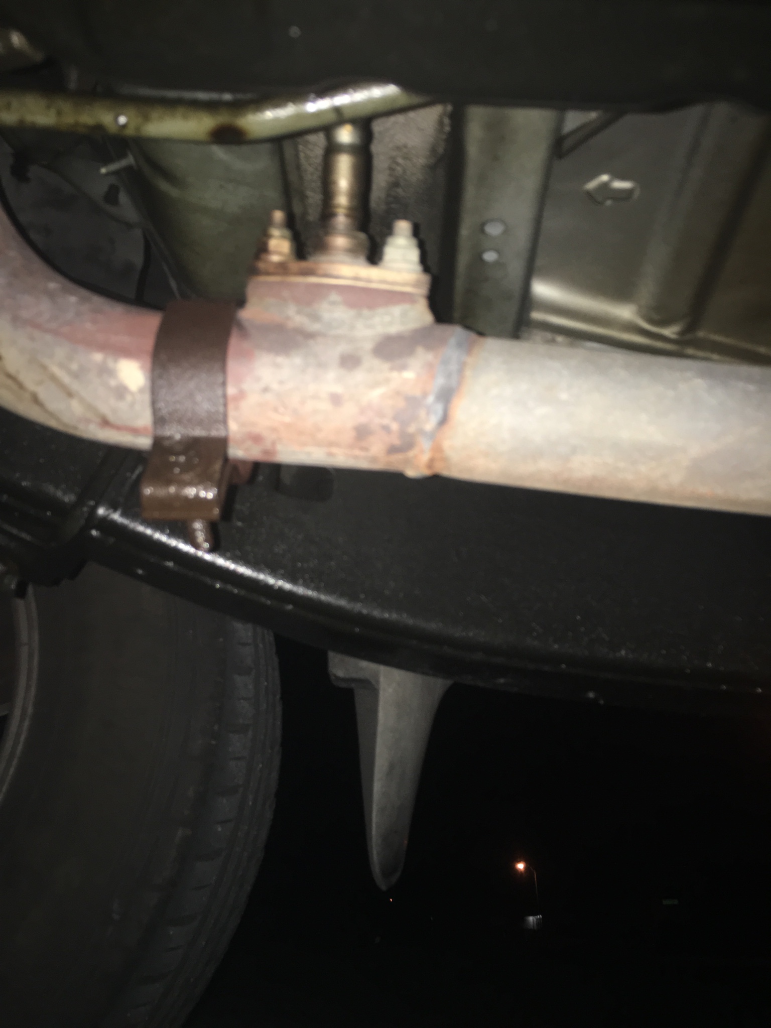

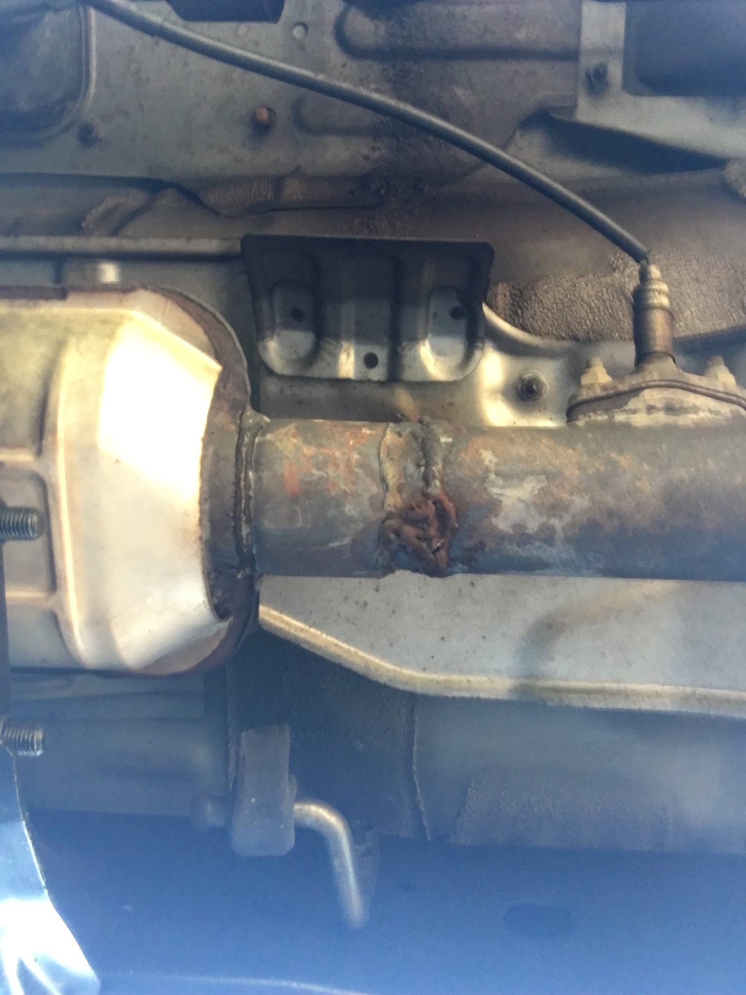

Hello everyone - I'm new to this app/forum. I joined this forum in hopes to find a good solution to my "00" T4R issues. I have a 2000 4Runner that I bought pre-owned 8 months ago. I love this ride but unfortunately the person I bought it from did a crap job at maintaining it apparently. I just found out the Cat converter was welded back on both sides. My truck is now struggling to drive normally because the cat seems to be clogged and the o2 sensors seem to come up bad based on a reading I recently got. Now I find it has two o2 sensors and one is apparently impossible to find from what I was told. Not sure what type o2 sensors to even look for this model. As if that wasn't enough my battery is dead as well so it dies on me as soon as the truck is turned off and I have to get a jump in order to get to work. I took it to Advance Auto Parts and they ran a test on the battery. It's definitely not the starter. So I have no choice but to get a new battery. Any suggestions where I can get these parts for a decent price?
Also it's already at 200+ miles. How much longer will this truck last me with proper maintenance. I would really appreciate everyone's insight. I would do this job myself if I knew how to. I'm hoping if I can get the parts at a decent price the labor won't be as expensive?
I have provided pics to the best of my ability. By the way I live in Tampa, FL not in California.

Hello and welcome. The catalytic converters and sensors can be problematic, the t4r came with both CA emissions and federal. There are only one kind to use, I believe it is the denso brand or factory. It looks like you also have a charging problem. Test and replace the alternator and battery and all of the other electronics of the vehicle will benefit. The upstream and downstream of sensors are a maintenance item and should be replaced occasionally. If you can post the trouble codes, perhaps we can figure out what is going on. Any reputable parts store or shop should be able to do this for you. These vehicles (like all others) have a few quirks, but once dialed they can be awesome machines!

There is only one oxygen sensor; it's the one furthest back on the exhaust. The upstream sensor is the A/F sensor. They throw different codes when they go bad. If you have a CEL then get the codes pulled, look them up, and go from there.
I don't think it's THAT abnormal to have cats welded in. If one of the cats really is clogged (if it's a California emissions then it has two) an exhaust shop can easily cut the old one out and weld a new one in.

I had a similar problem with my cats/02 sensors. I kept having code P0420, "catalytic converter efficiency." I replaced my rear 02 sensor first, it came back. I welded in a new cat (saved me like $200 over a bolt in cat), code still came back. Then I put in the front 02/AF sensor, code came back, then front cat, that finally fixed it. Mine is also a 2000, with 172xxx miles. Sensors were bought at the local parts store, Bosch brand. Rear cat was bought there as well, Magniflow brand. The front cat, a Walker brand, was bought at Rockauto.com. That site has good deals.
People recommend only toyota replacement parts. While I don't doubt that the toyota parts are better, I used these cheaper parts cause money is tight. With these parts I passed stringent CA emissions testing without a hitch.

[MENTION=166333]thenightman[/MENTION] Thanks so much for your insight. Yeah I had the same P0420, "catalytic converter efficiency" code. Based on the pictures I posted and from what I'm learning, it seems like my best bet is to get what's called a cat back and the exhaust manifold. I don't know. I am definitely on a budget but I also need this vehicle up and running properly.
